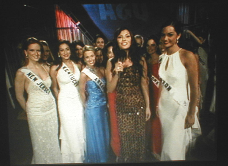

Before people start saying how it cant be done and how I get a 15' image and how a 320X240 is OK blown up wall-size, well, I say show me how it looks, then talk about how big it is, what it's made of, how none of the light will show through...
Example; Here's my results using a 7k lumen MH OHP with a 640X480 1.4M color panel viewing a NTSC broadcast image: (Note; the camera @1024X768 possibly makes it look better than it is)

So at the moment, my setup is ony 640*480, but replace the panel and i could have 1024*768. Right now the image is only watchable in complete dark, and it has a distinct green cast to it. Both of these problems will be solved when my new 250 Watt MH fixture arrives, it is in transit. ($64 including shipping)
If i had a good digital camera, i would show some pictures of the image produced, but all i have laying around is a Jam Cam 3.0, which is near useless in the dark.
With the MH the colors will render correctly, and the image will be much brighter. Probably will have to be watched in low ambient light anyway, but I really dont want to pay the electrical cost of a higher wattage setup. Once I add polarizers and a decent screen(my wall is medium grey), the image will be great for movies.
