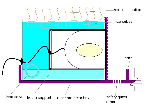

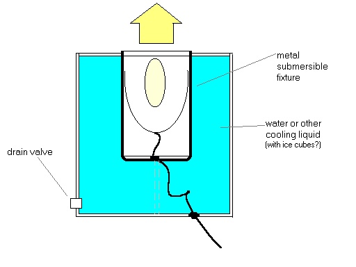

Well zardoz i read the thread and i didn't find any problem with my solution....In fact when you think that you can easily drain the "tub" that the lighting fixture sits in and can also place ice cubes in the tub....welll...it works out rather nicely....And all the problems discussed in that thread are solved....including noise...
Here's a sketch:
HOME FIRE!!!!!!!!!!!!!!!!!!!!!!!!!
Please no one try this without a circuit breaker in your electrical system.
Without one you have an EXTREMELY high chance of a major fire occuring...
But with a nice fuse in your wiring....This solves the heat/noise problem.
And please somebody hook me up with an lcd deal for my projector for such a beautifully simple solution....
P.S. i think most people missed this solution because they were all thinking in terms of PC case cooling....
But light fixture cooling is a whole different ballgame....Only one wire and the fixture can be encapsulated.

NO NO....The LCD Cooling is the easy part...with filter (UV/IR) glass and air space....The Major problem is ambient heat, espescially with halogen...and this water tub could act as a GIANT heat sink for heat throughout the projector as well..
Please post comments suggestions in the "Submersibles" thread...
And ice cubes is no problem...just keep some in the fridge for your projector....and they may not even be needed...water might be enough......and cheaper than wasting electricity on fans...and removes *ALL* noise....
thank you
