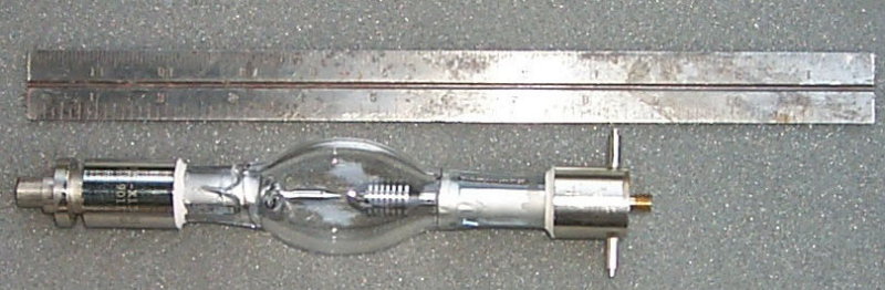

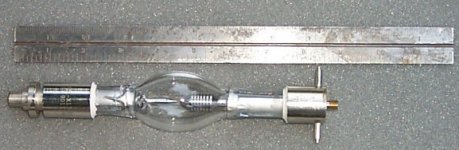

FS - Mother of all Metal Halides - sic
This is a 600W, 2000 hour bulb, latest design. Brand new, never used. First $40 into my paypal (joejas@ihpc.net) gets it. This bulb is supposedly temperature expansion compensated, vis-a-vis its mechanical mounting.
This should provide plenty of light with the appropriate ballast. Probably in the 75K lumen range.

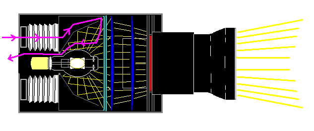

this is what im doing at the moment
pink line is the air
air gose in through the fans than it gose through the tubes than air gose through the side holes in the mirror reflector i made than out the front of the reflector (holes) than hits the low-e glass then comes back to the light and out the hole where the light is going in to the reflector then the air gose out the exsost hole.
sorry for the run on sentance.
like this your not circulating hot air,or messing up the reflector, and its cooling the reflector, glass,and the bulb. i hvent tested it because i need to mount the bulb and order the low-e glass to finish my projector.so im still not positive this will work, but it sounds to me like it just might.
yelllow line is the light
this is what im hopping will work,or else im back to step #1. as long as the light gose some what forward and there is a fresnel right at the end of the reflector to catch all the light coming out of the reflector than the fresnel will send the light in one direction. i think it just might work see my picture. if you guys see a problem or have a queston, just tell me .it would help me out.
thanks & later.

Biteon, i saw your diagram and have a few questions:
Where did you buy your bulb? What size and model LCD are you using and what are the blue lines and the green line in front of the light.

MikeZupcak
the 2 green lines is the low-e glass which is two pieces of glass and some sort of gas in between to filter hot air . i desided that it might separated the box in two parts 1 the hot stuff side with the light and any thing else that can withstand alot of het and 2 the side that can not have to much heat forinstants plastic fresnels and controler boards and lcd polarizers etc. . but if the cool side of the separration is still to hot im planning to put a small fan.
the blue lines are the two fresnel lenses(plastic for now)one to capture all the light from the reflector and the other to condence the light so most the light is on the lcd and not all over the box walls being wasted.
the lighter color yellow after the low-e glass is colder light sence its being filtered from the low-e glass. and the box under the fresnel lenses is a metal box i made to cover and help keep the lcd controler chip cool i had a (heat problem there not to long ago),it also make it easy to separrate the box more with the fresnel lenses and wood.
im using a 5.6" car lcd color with remote and it has 700x900about res. and bought it at e-bay from some company name starvision for about $124. with out shipping etc. . the bulb is a 400watt metal halide ms400/u i think and i bought it here in my home town at a electrical store called "electrical distributers" or something like that. ive been having cammra problems so its been hard to get pictures ,ive been drawing most of my work.
