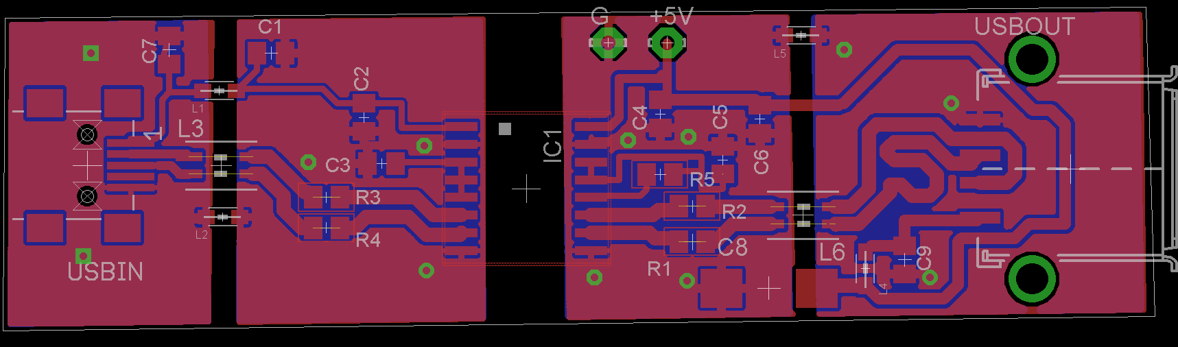

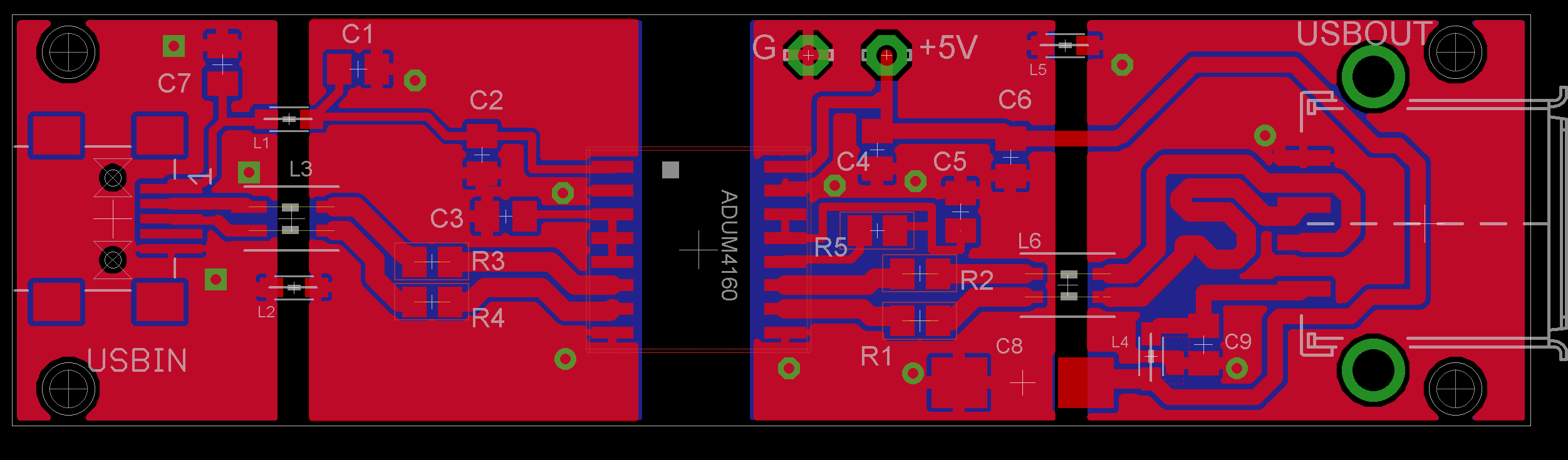

Sorry Marce,did not get it . Do I need to make the upper copper layer into 4 blocks like I did with ground (bottom layer) to make it isolated? or just routing it through inductors as you suggested should do the isolation?
I am using the bottom layer only for ground (s)and using top layer for VBUS1 and VBUS 2 only .VBUS 1 and 2 are physically separated into two layers at the adum4160 level. But the pi filters are just laid out as tracks on top layer and not separated out into blocks as in ground plane. IS that acceptable?
And you said you weren't having much luck with Eagle. It looks good! Remember to change the DRC rules to suite the PCB manufacturer.here is the updated board

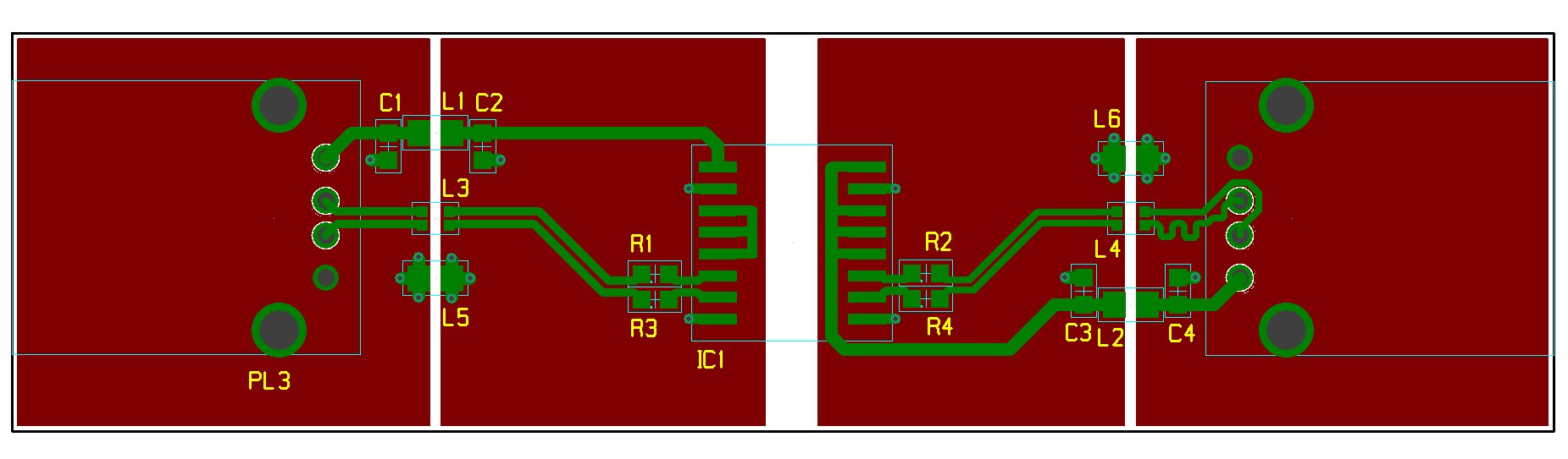

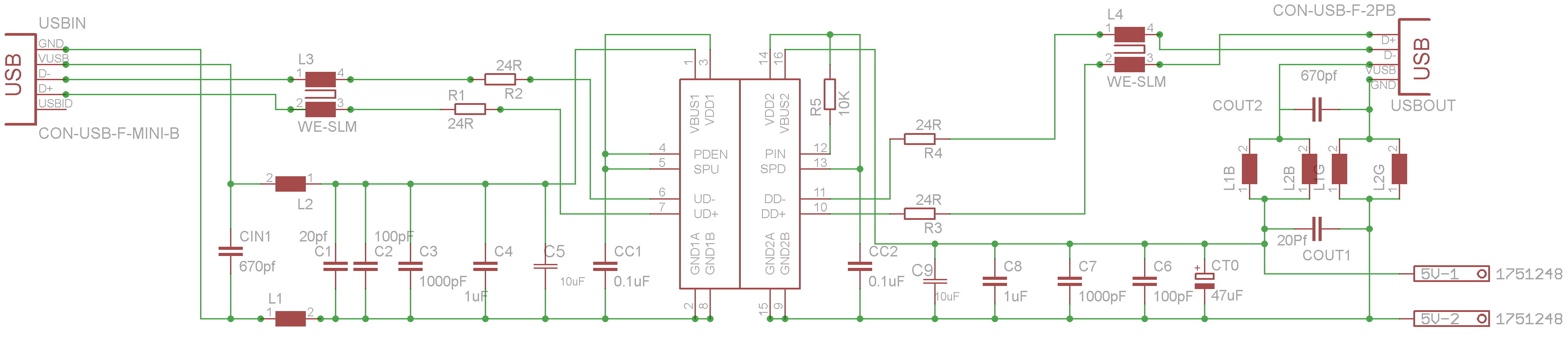

I would do it somewhat like this (pain🙂 ) I have laid out the circuit in the schematic I posted earlier as its easier to show a pretty picture than try and explain un words.
Notice the power is routed as tracks not as a copper pour to minimise capacitive coupling.
Also not how the PI filters are laid out (critical) and how the ground planes split (very critical).
Hope this makes it clearer...

Also, instead of those wiggly traces, just mount the connector on the other side of the PCB.

in short both side has ground in copper pours(double sided PCB) but bus lines are made into separate tracks?

Squiggly lines!!!! Don't forget this is just a quick example layout, mainly to get across the importance of separation between areas when filtering for EMC is used, so its a useful tip for people to incorporate in their layouts if they want🙂
I know this works as the technique has been tested to 18GHz immunity for a certain project that I worked on where we fine tuned all aspects of the design to achieve what we had to.
Having both connectors on the same side of the board is better for assembly, having a housing done etc. also soldering, having it on the other side would make the lines a little prettier though, and would be quite acceptable for hand assembly. The squiggle is because the D-/D+ lengths were a little out of spec for skew...normally this would be on a multilayer board so the diff pair traces would be a more sensible size and the wiggle wouldn't be as noticeable.
I have left any top layer ground pours of my little example design for clarity, they can be added, then I would have to add some stitching vias.

Marc what do you think about this new board?
Max I managed some how, it was a steep learning curve.Still trying to figure out how to make the 4 edges parallel. Any shortcuts?
Yeah it's all these little annoying things that take a while to work out. I recommend you go to 'View > Grid' in Eagle and set it the 'size' and 'alt' lower. I've included a screenshot of my settings (but I usually turn grid lines on too). You might need to go lower though. Once you've set these, don't change them as if you place something in the PCB, then change them, then place something else they may not line up.
Max necessity is the mother of everything ,I somehow managed it over past few days. And here is the final board with ground planes on top and bottom with traces carrying power and data as Marc suggested. Just need the idea on capacitors .Marc also suggested ferrites debating between 670pF and 1nF. Also wondering what to do with the caps in original design. (47uf and 10uf.). Unfortunately I lost the link between brd file and sch file n eagle and there wont be any annotations .So modifications might not be easy😡.

I would love to take the credit, but the EMC stuff is from work I have done with an RF engineer (also an EMC guru) on a project I have worked on for a couple of years, the layout was my contribution. But we know it works and works well for keeping noise from getting through.
