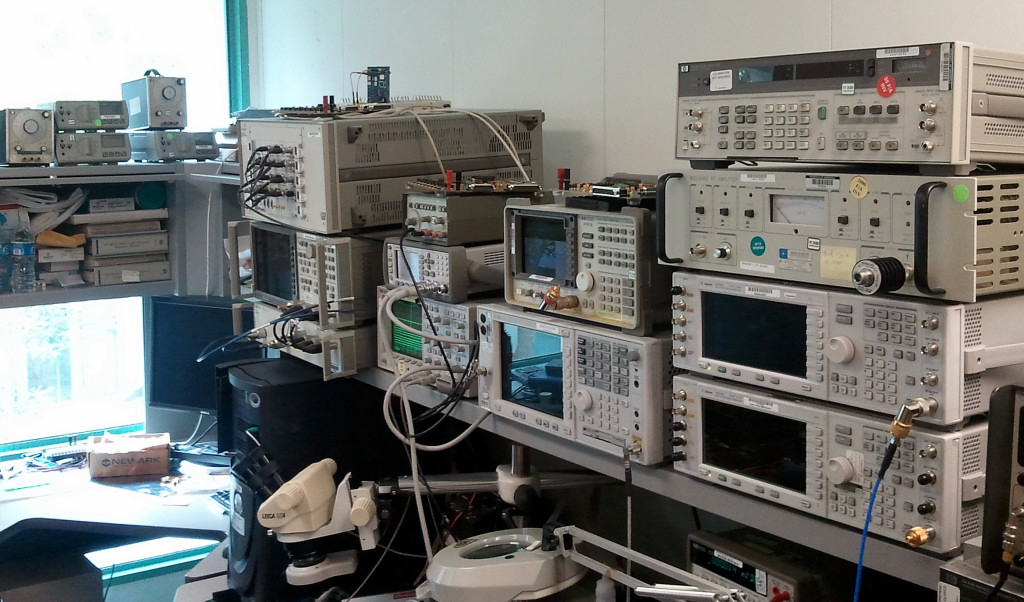

The picture shows the stuff on my desk at work. We also have a lab.
