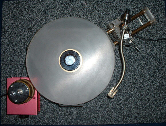

For the Vinyl friends some pictures of my turntable.
This Device is a result of several years on
building-research-rebuilding.
Feel free to coment.

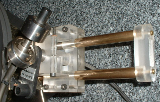

Well you said "feel free to comment".
My hacksaw would be at the arm mounting arms like a shot,
but I presume you want the option of mounting longer arms.
Personally I'd give this up . The Alphason is really nice.
🙂 sreten.
Some answers and thanks for the coments
Yep! My 15' DIY arm is still in construction.

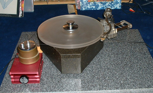

Is the bearing and platter homemade as well?
what's the red thing under the motorpod?
The bearing is made on a profesionell tool machine by a friend at Schütte .The platter is made by a friend at Bayer and finaly the red thing is a "Swiss Boy 110" from Rudolf Grauer AG (second adjustabile arm base?!?).
What material is used in the base???
Polymer concrete made in one casting
Any info on the motor and supply?
Case is Transrotor with Papst AC motor (standard) with simple transforner
