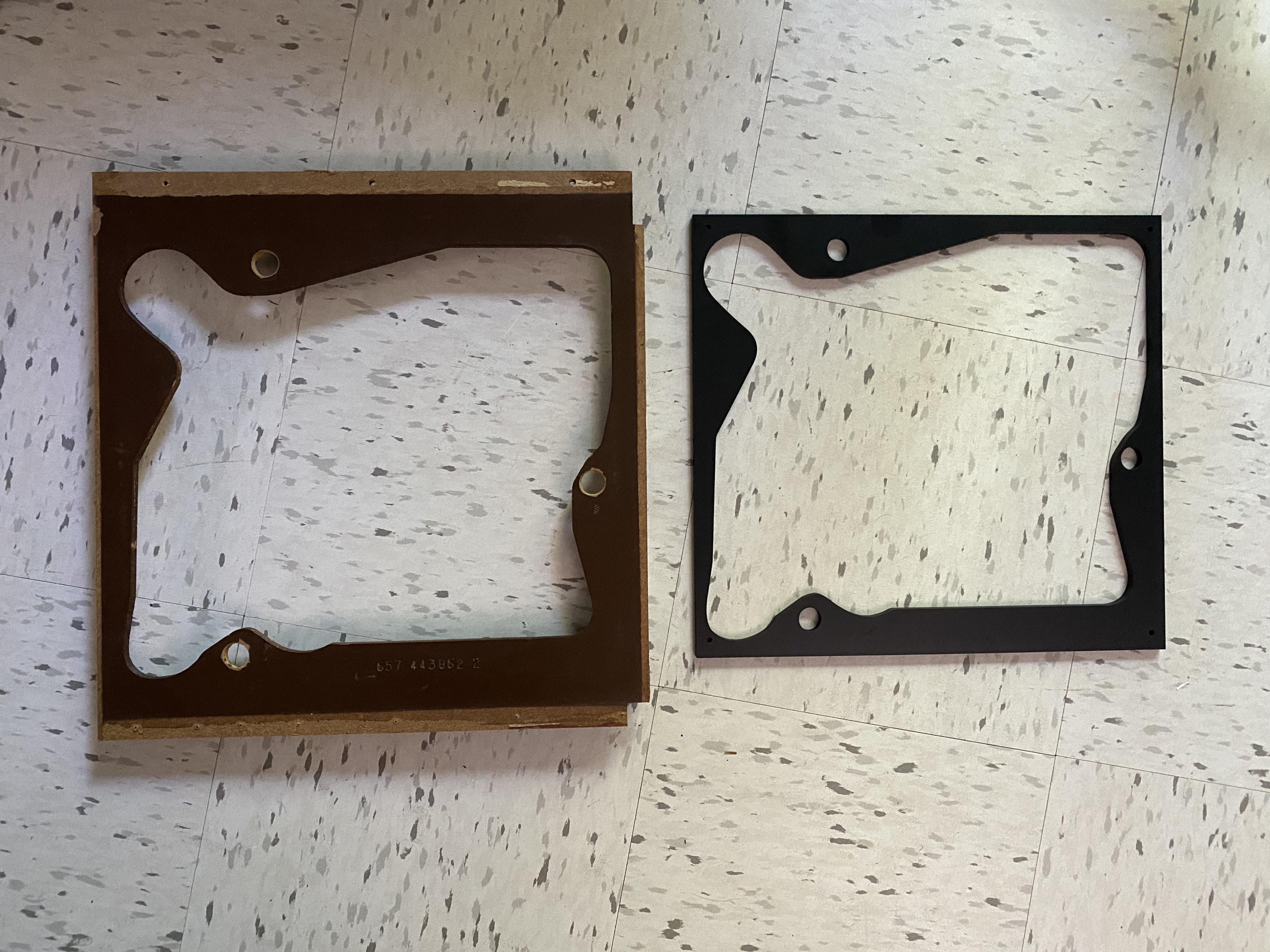

I have an old Magnavox Micromatic turntable that I wanted to install in a small portable player from the 50s, and didn't want to cut down the original board (on the left here).
I scanned it in and traced it at scale, then created a new drawing within the size of the original portable's mounting board dimensions, but with the new turntable's mounting setup.
I had Ponoko do this from my file on black MDF and it worked perfectly just as it arrived - no association with them at all here other than being a happy customer so just wanted to mention how well this worked.
