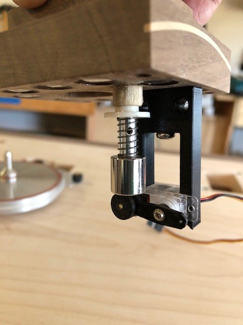

Here are two pics of my servo arm lifter.

I don't know how odippel has configured his operation, but I am controlling my arm using an Arduino Nano with a servo. The servo is mounted so that the output shaft is horizontal, with an arm that will push against a normal tonearm lifter (without the associated mechanism that is redundant) once the arm reaches the record end. In my case, I trigger the Nano via a reed switch magnet attached to an arm at the bottom of the vertical spindle of the tonearm. It's important to have a balanced fitting, so I've used a four arm (cross) fitting with a magnet at opposite sides to prevent yawing. I've tried a simple servo trigger which is simpler than a Nano but It became faulty after a few operations. It may have been something that I did so I don't want to rubbish the trigger. The Nano is very small and easy to install underneath the plynth. I also raise and lower the tonearm via momentary switches for cueing. I'll get around to posting some pics of my TT build. I also made my own tonearm mated to a technics gimbal that's turned out nicely.

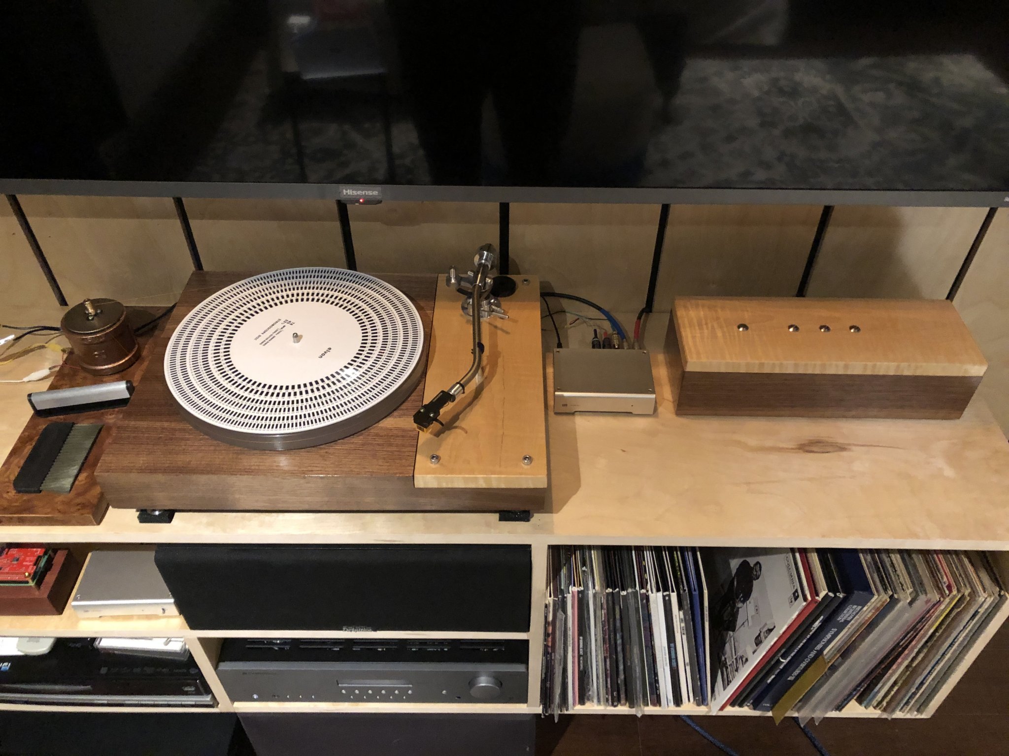

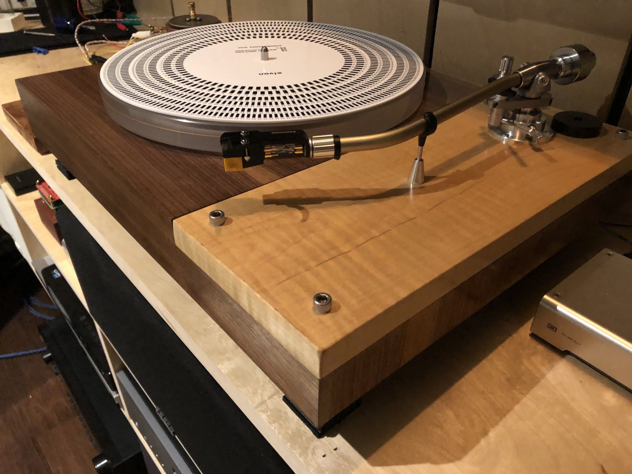

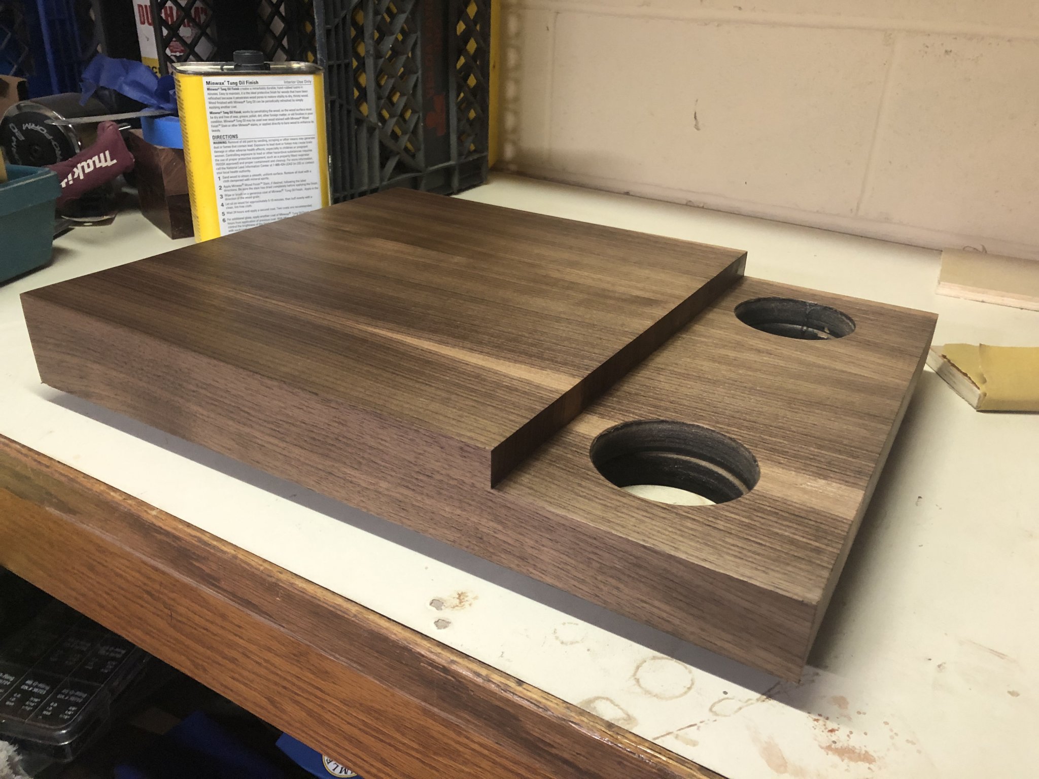

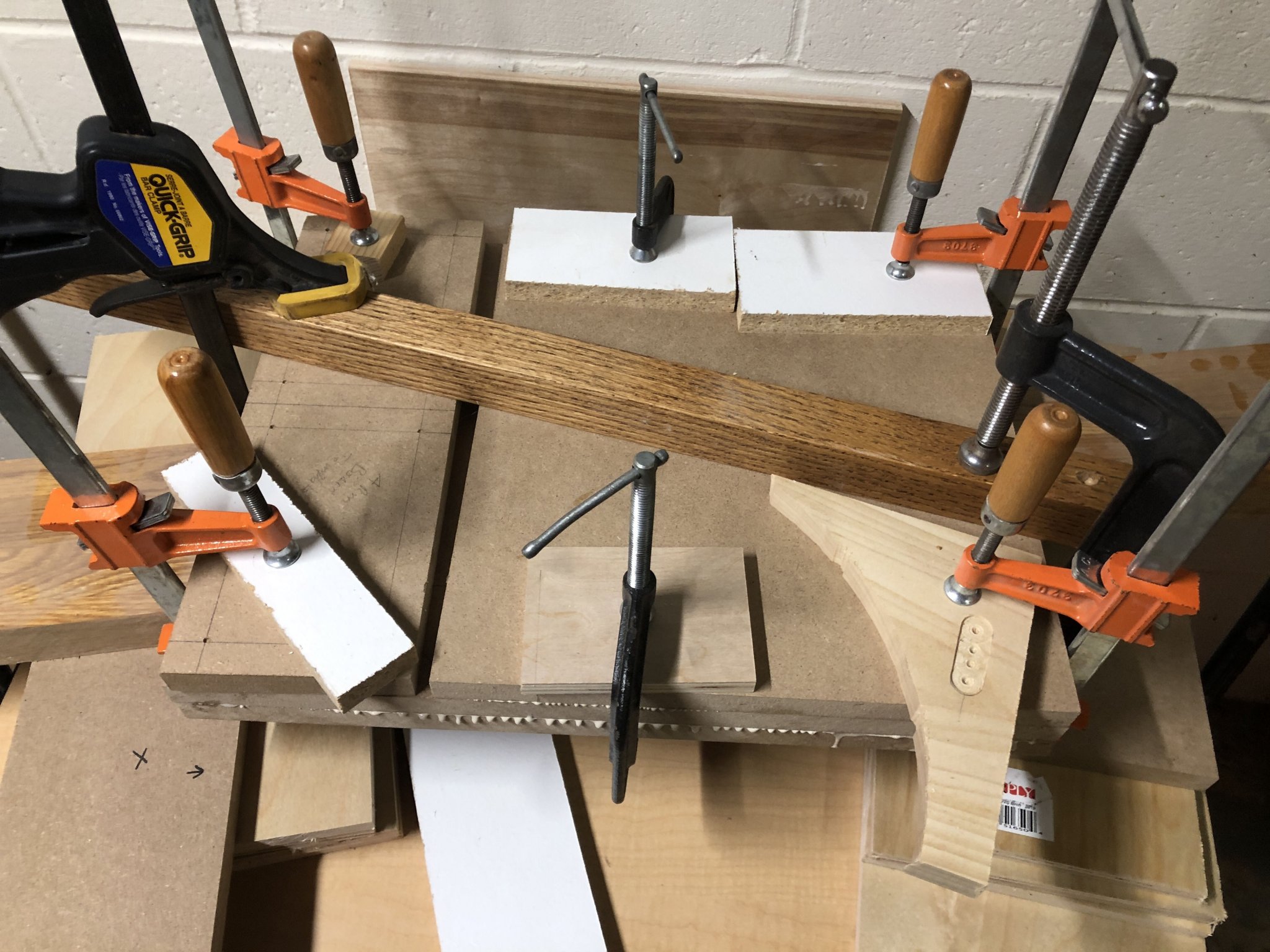

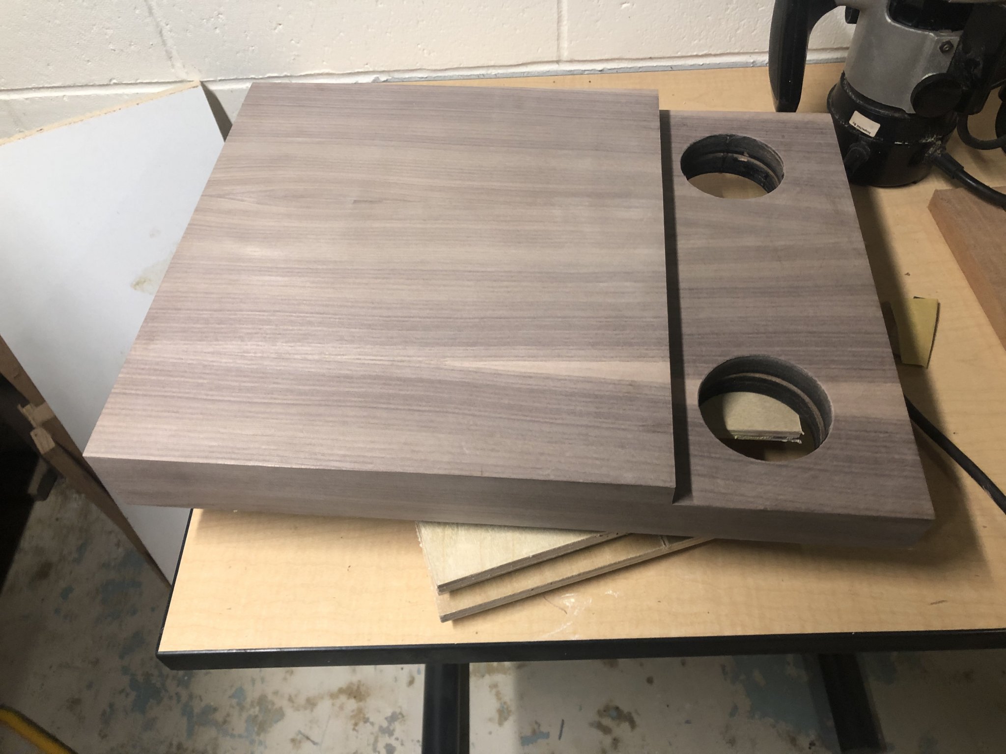

I thought I'd share a project I've been working on for the past few months.
It started when I decided to make some upgrades to my Technics SL-20. I updated the RCA wires to terminals and a new ground connection. Upgraded the cartridge and rewired the tonearm with silver wires. The improvements were eye-opening. But soon after, It began to have some speed issues.

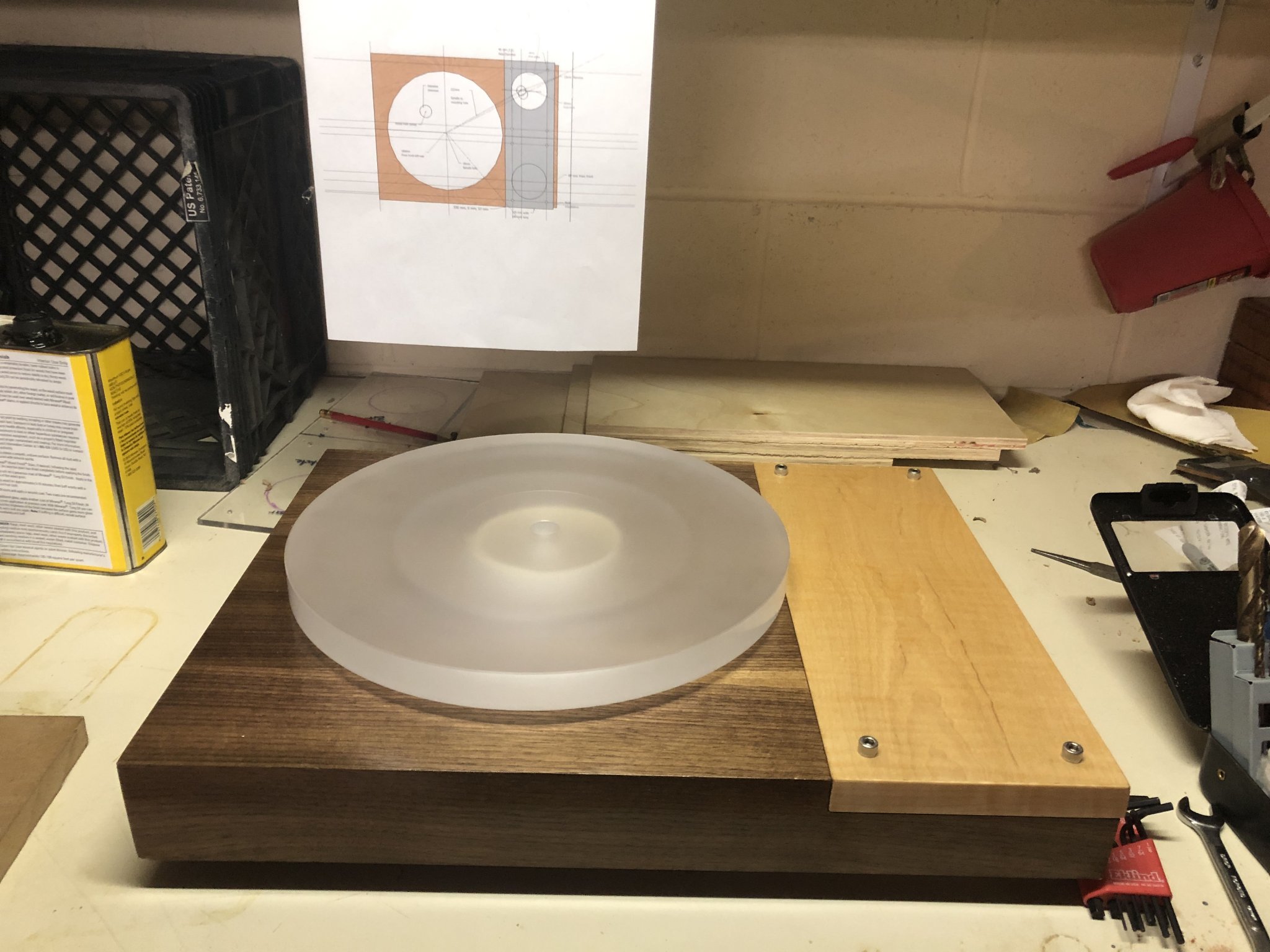

That's when I decided to look into buying a new turntable. I liked the Rega and Fluance offering, but if I was going to upgrade, I really wanted something with a separate motor, and arm board that would allow easy upgrades to the tonearm in the future. Anything I found with features like that was far beyond my price range, so I decided to try to build my own.
Here are the parts I used:

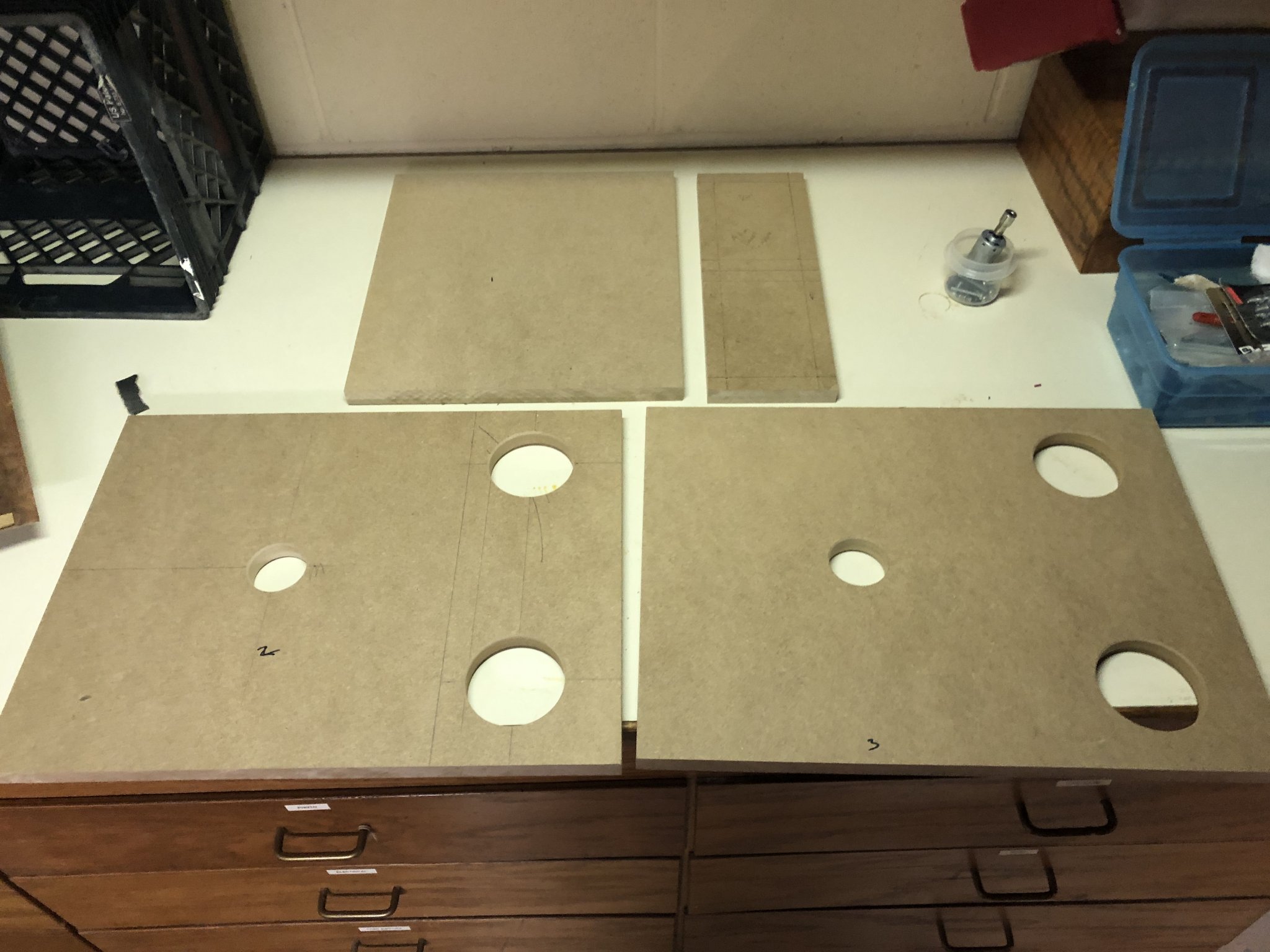

Plinth: MDF (three layers) with walnut veneerView attachment 1003706

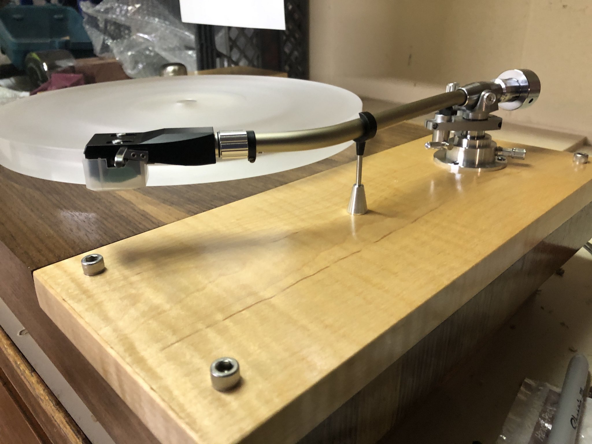

Arm board: Curley maple (solid)
Sub platter: Tango spinner with bearing sleeve
Platter: Rega acrylic
Micro Seiki MA-202L tonearm, which I rewired with Cardas 4X33 Tonearm Wire Cryo Treated from Take Five Audio.
Nagaoka MP-110 cartridge with Nagaoka headshell.
Adjustable feet from Amazon

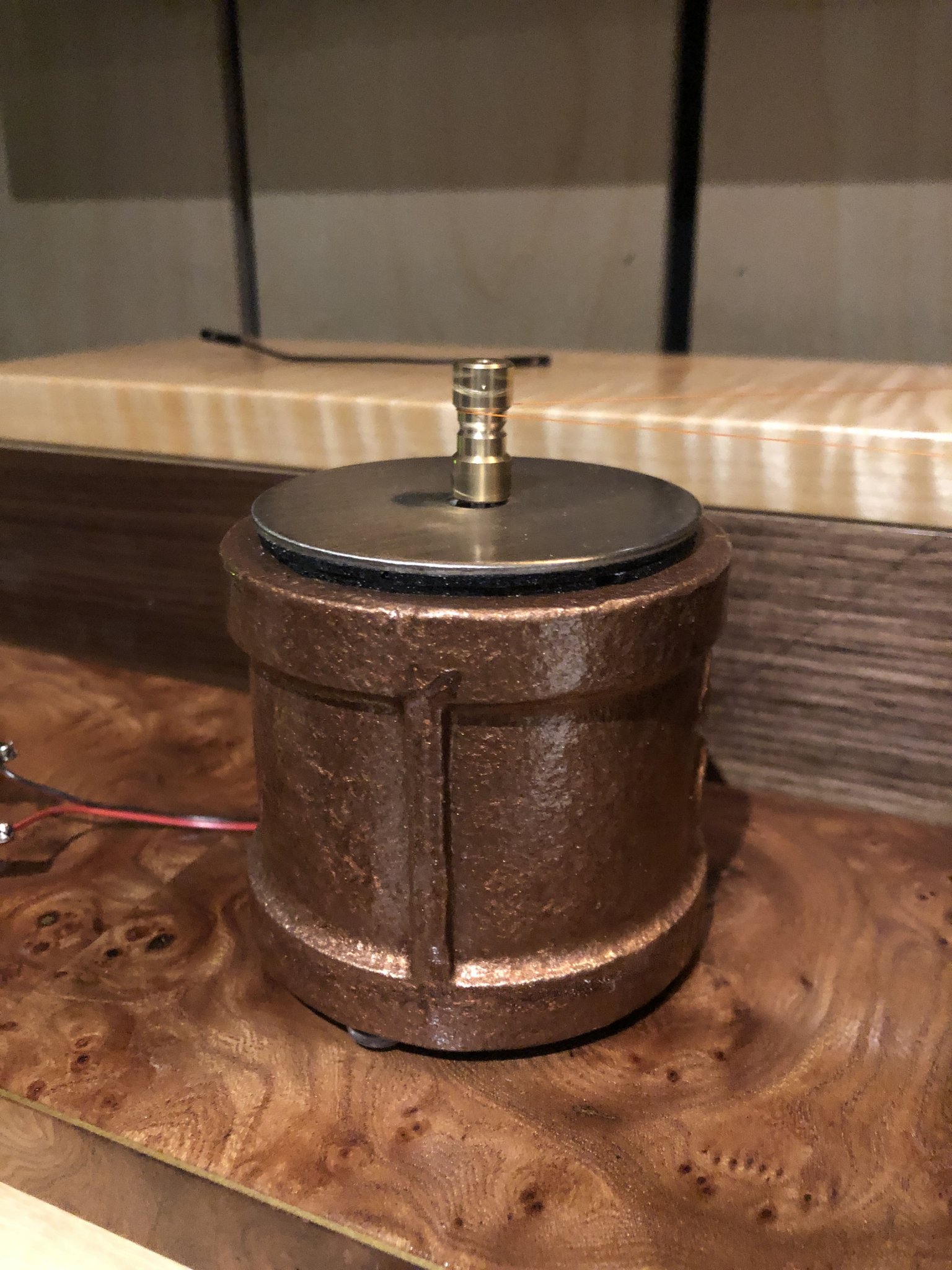

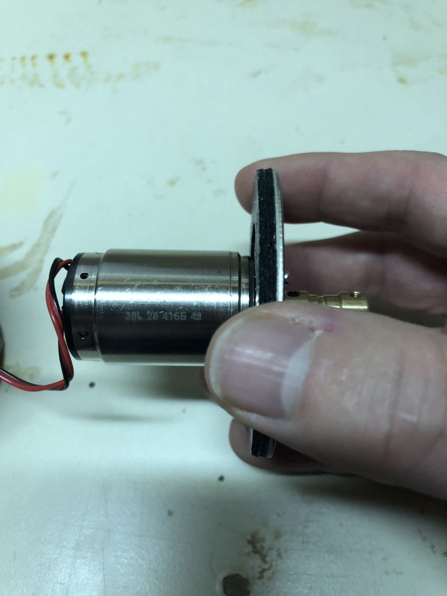

I initially wanted to use a Maxon motor, but I stumbled upon a Portescap 28L28-416E.49 motor for $55 on eBay. It was new-old-stock, so it's Swiss-made, rather than the newer ones made in India.
The spindle for the motor is just a brass motor shaft coupling that I machined a groove into for the belt I made from polyester thread.

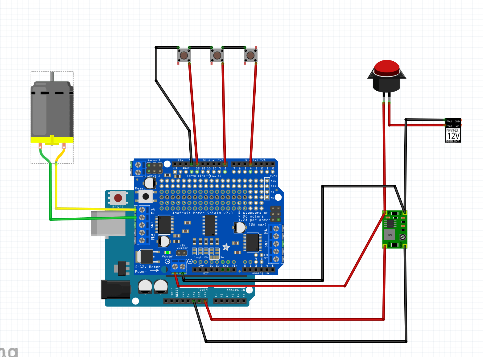

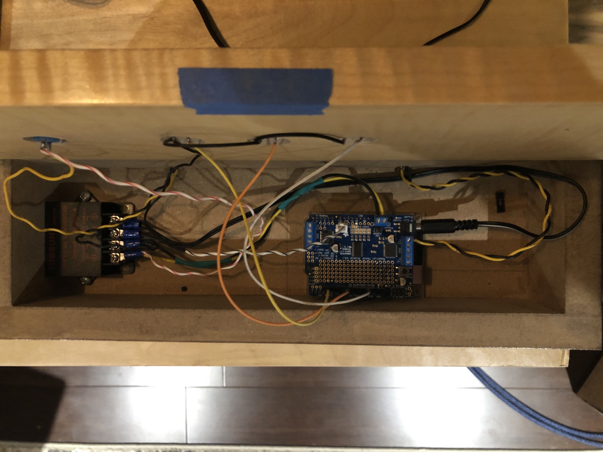

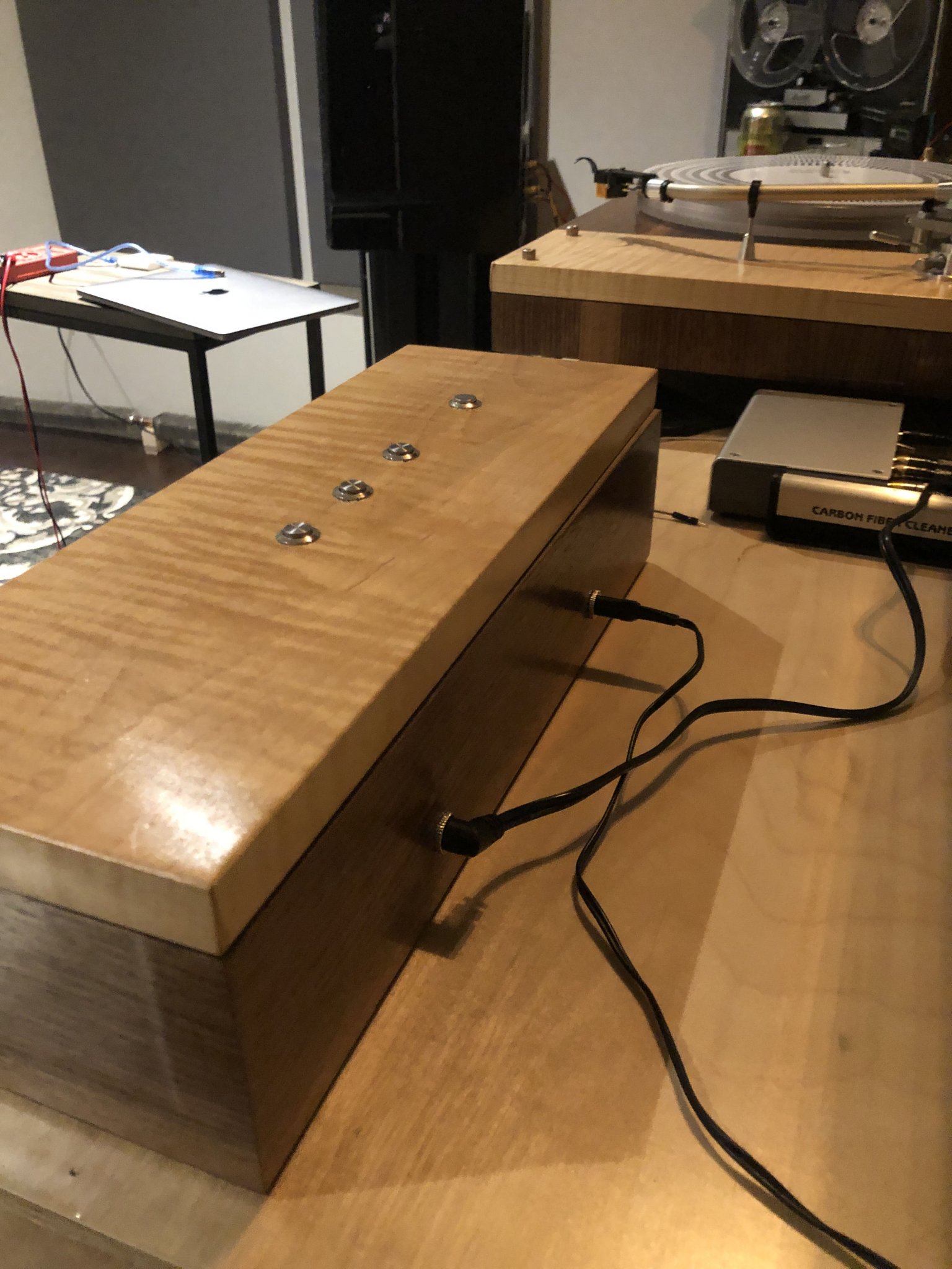

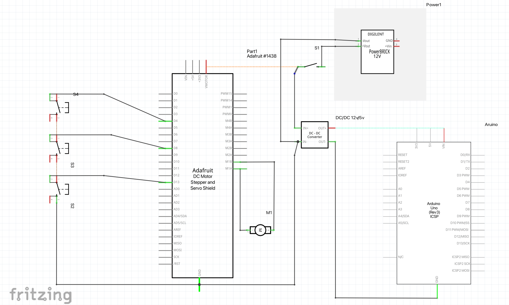

The most difficult part by far was the motor control. I lost count of how many different threads I've read on this subject. Lots of good ideas out there. In the end, I decided to go with an open-loop system using an Arduino Uno and Adafruit Motor Controller. It's not perfect, but It will do until I learn more, and build a closed-loop system.

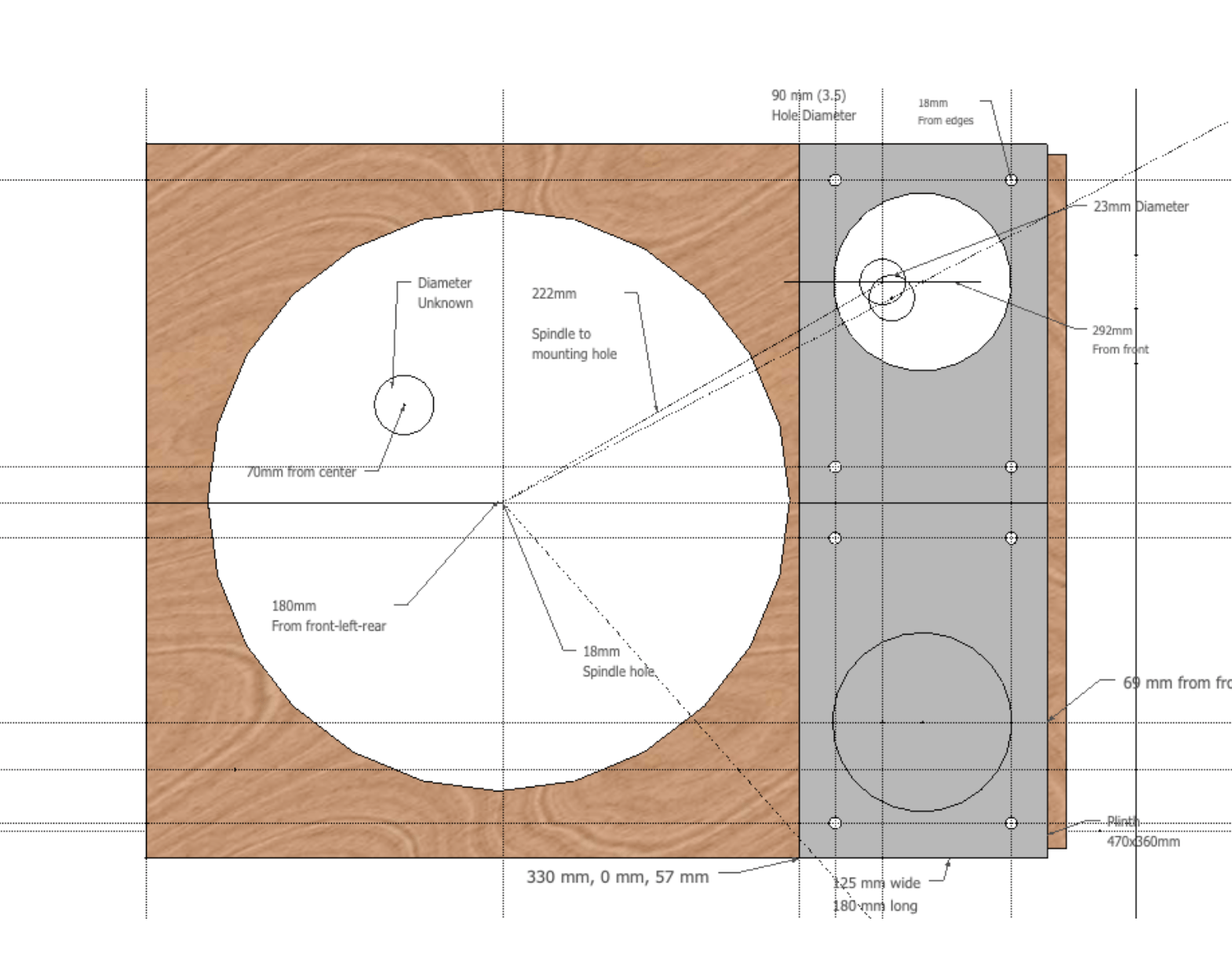

I'm posting all my plans, photos, schematics, and Arduino sketch. Hopefully, this post will help someone who wants to take on a project like this.
The green board in the image represents a DC/DC converter used to convert the 12v incoming to 5v to power the Arduino. The 12v feeds off the incoming terminals and goes to the power input of the Adafruit Motor Shield.

Beautiful aesthetic! I really like the two woods.
