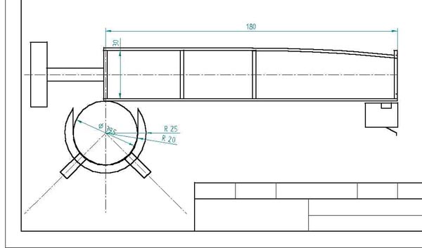

I found this acrylic tube (50mm outer dia, 40mm inner diameter) in RS components catalog, item 282-2262, and acrylic rod (40mm diameter) item 824-468. (Do a search using item numbers at their website, www.rs-components.com).
So I'm thinking of doing an airarm where the acrylic rod slides inside the acrylic tube instead of using aluminum angles. The top of the tube will be cut off so the rod has vertical freedom and be able to float. The acrylic is easy to machine and tapping threads into for fastening screws and such. The airhose can be connected to several nipples that are screwed into the acrylic tube. The acrylic tube I'm looking at has 10mm thick walls, so shouldn't pose too much a problem.
Any thoughts?
Any thoughts?
Any thoughts?
I think it looks pretty interesting! You would get a bigger surface area that way. But the inner rod would be somewhat heavy - can you do it with a tube inside, cut some of the weight?
SemperFi,
looks neat!
but be prepared for the acrylic tube getting warped after you milled off the upper half.
Acrylic tubes are extrusion profiles and have the iiner tensions of such.
