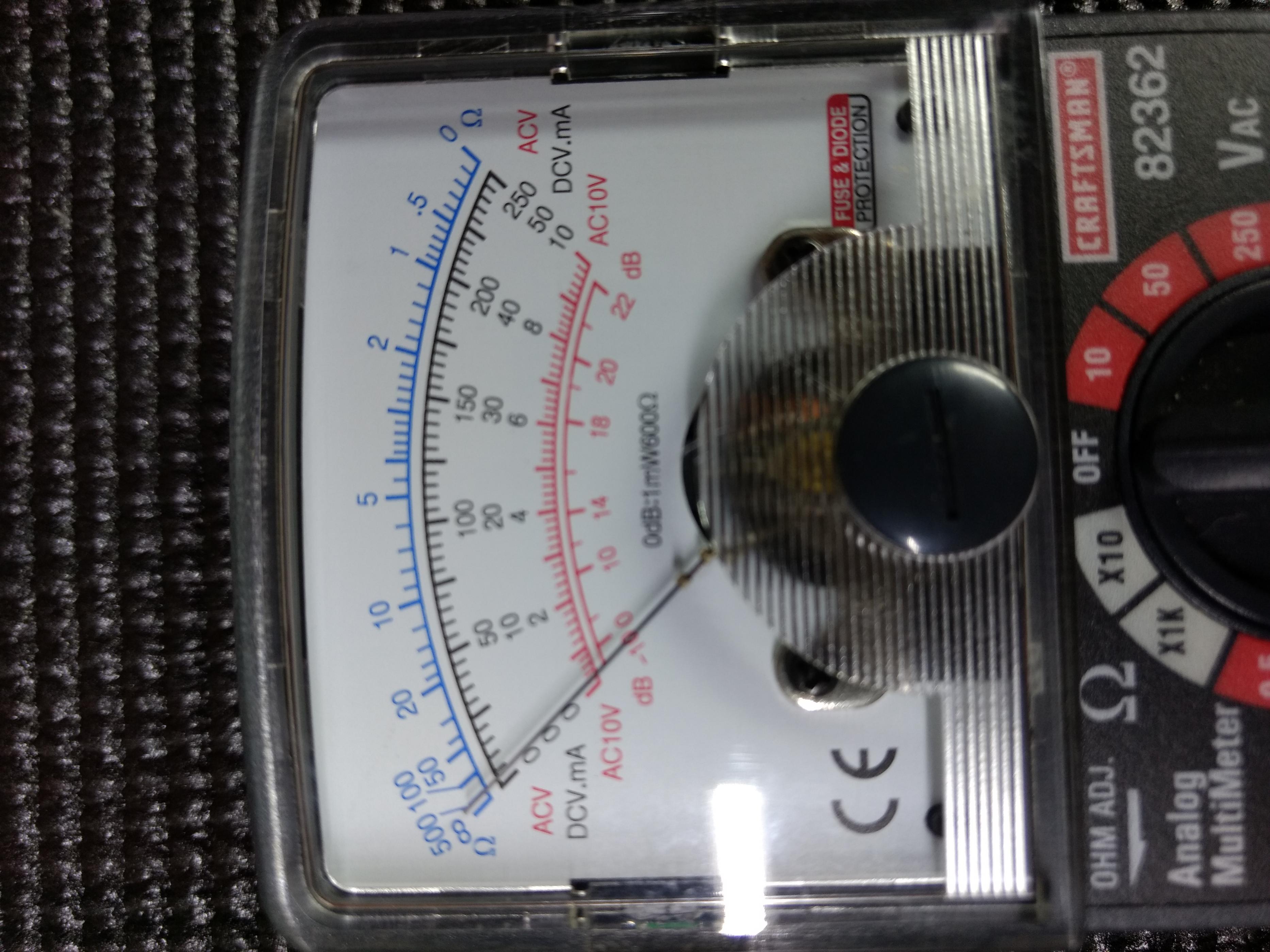

With shorted inputs, and the COM probe of my voltmeter attached the ground through a 390pf capacitor, and the red probe attached to the output RCA jack, I get an AC voltage reading of about .16v.
This is using an autoranging meter. I tried my Craftsman analog meter, on 10Vac range, and the needle doesn't move.
Note sure what that means. 0.16V of RF? 100V of low frequency? You need an oscilloscope.

Currently, I am playing louder than usual on an older Pioneer amp. Seems to be performing well. Sounds good. If I hook the autoranging DMM to the output, the vDC still jumps around like in the linked video in post 1, but the range of jumping is diminished. Although, I am not really sure what is measured in that test.
I tried looking for oscillation with my analog meter per the post above, and I couldn't get any reading other than zero. This may be due to poor quality meter or operator error. Unsure. :/

Don't know the ohms per volt of the craftsman analog meter. This should show in very fine print on the meter scale. I'm getting good 1 mhz oscillation check on my 5000 ohm/voltAC simpson 266XLPM. (Like I found some oscillation) Which has 2 vac & 20 vac scales.
Cheap DVM produce random numbers on music, my test on the back of a hammond organ demonstrated. The $200 Fluke RMS voltmeter will produce accurate numbers on music up to 7000 hz, but is totally dead on RF waveforms. Waste of money, IMHO when the 266 is about $280.

The plate resistance of the output tube is 5 kohms. If the Craftsman meter was 1000ohms/volt on the 10 v scale, that is a load of 10 kohm. So if the oscillation into 100k amp input was 1 vac, and you measured it with this, you could see 0.67 volts average noise.
