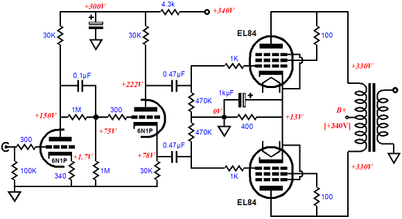

I built a single ended tube preamp (the circuit is here Sofrito Preamplifier – wauwatosa tube factory). The preamp seems to be working great. By great, I mean that the sound it produces is clean and clear with a bit of :tube:.
Circuit Schematic:
My build has 2 minor differences:
1. I am using 4.7uF output caps
2. I added a DPDT switch in between the rotary selector switch and volume pot. The inputs ground run to the volume pot and then to the star ground at the output tube (6V6).
However, my amplifier kicked into protection mode the other day about 30 mins into a listening session.
What could cause my amp (Marantz PM8005, input sensitivity is 1.6v 15kohm, running in Power Amp Mode) to go into protection?
Is the addition of my newly built preamp just coincidental? The system was working with out event for ~7 two hour listening sessions. The last session, I got about 30 minutes through a record before the amp went into protection mode.
I removed the DIY preamp from the system, and using the built integrated preamp of the Marantz, and the second half of the record played okay.

It would help a great deal if you could mark up the schematic to match what you built. I think I see 2 6V6 and 2 6L6, is that correct? How are the 6V6s triode strapped? No 5U4? SS diodes? Is it dual mono in one chassis or does 1 supply split into 2 regulators at some point? How exactly do the rotary and DP switches wire up?
Could it be mains voltage variation? At first glance it appears that there is a band of frequencies in the subsonic region which will be passed by both the PSU and the line amp output, so any change in mains voltage in this bandwidth will be passed straight through to the power amp input.
BTW, I don't think we ever confirmed how the 6V heaters are referenced to ground. Is there a grounded CT for them or did you make a false CT?

Regarding the issue: could it be that the 6L6 is oscillating?
There is one power supply that is feeding a stereo pair of 6V6 (as triode). To run the 6V6 as triode, I shorted screen and anode pins (pins 3 and 4). Signal enters the 6V6 on the grid pin (pin 5). B+ (220v DC) is fed onto pins 3/4.
I posted a schematic in the thread to illustrate the wiring of the inputs and switches. Sorry for my rudimentary drawing in advance.
There is one 5U4 rectifier, one 6L6 used as shunt, and 2 6V6 (one for each channel).
The 6.3v heater and primary have center taps on the transformer. These are grounded in the power supply section at the negative of the first filter cap.
The 5v AC winding from the transformer feeds the 5U4 rectifier heater.
How can I check that? DC voltage from the 6L6 is steady on my multi-meter (MM).
Would that measure as AC? How would I connect the leads of my MM to measure possible AC at the output of the 6L6?

You need to check for ultrasonic oscillation. I had 1 mhz @ 1vac in a mixer I sped up the op amps on, and it sounded okay, but the power amp hated it.
If you don't have a scope, an analog AC voltage multimeter 5000 ohms/volt with 2 vac & 20 vac scales will work. Block the negative probe with .047 600v to prevent the AC scale from reading on DC. If you have output with no sound, very suspicious. You can prove any AC voltage out is ultrasonic by changing the blocking cap from .047 uf to 390 pf. Audio won't pass through 390 pf, but ultrasonic oscillation will.

I agree with adding screen stoppers if either of those tubes oscillate you would have problems. It also looked to me like the grid stoppers on the 6V6s might be metal film. I think carbon comp would be a better choice for stoppers.
Thanks for the heads up on the grid stoppers. I am not sure where to add a screen stopper on a 6V6 in triode. Is it just another high value resistor? Where would I wire it?
On both the 6V6s and the shunt regulator you do just like the grid stoppers. A carbon comp resistor of 100 or 200 ohms soldered right to the screen grid tab on the socket. The othe end then soldered to the plate connetion. The resistor replaces your shorting jumper.
So, my grid stopper is wired between grid and input signal and is 300 ohm. Does adding another 100 ohm resistor between grid and screen cause me to change the grid stopper value? How does one choose a value for the screen stopper resistance? Is 1/4 watt resistor okay? Or higher?
No, the screen stopper goes between the screen and whatever it connects to, in this case the plate. Like this...
I think the confusion came from my use of the term "screen grid" . what we usually call the grid is more properly called the control grid. There are three grids is a pentode the control grid (aka grid), the screen grid (aka screen), and the suppressor grid (aka suppressor).
