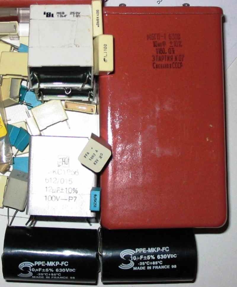

To be true I have some russian PIO caps that I could parallel to the Solens to reach the 20uF, the only problem is their size....

Konnichiwa,
If you must recycle junkbox parts, try this:
100uF electrlytic capacitor, then 100R series resistor and the the the best 5-10uF capacitor you have. I would advise against Solens, in the past I found them to give sonic problems.
NOT the FC series IMHO.
Cheers,😉
Konnichiwa,
A hard, unpleasant sound. This may be very well a result of the microphonic behaviour of these capacitors, just sweep one with a nice high level sinewave while applying a few volt bias....

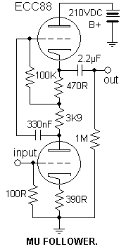

Here
You are showing that mu follower with ECC88

And here you are talking about 6N1P. Can I just replace the tube of above schematic with 6N1P (I have loads of them but nil ECC88 or 6N23P)?

Konnichiwa,
In what application and compared to what other options?
I have compared them to the ICW's, Ampohm and Ansars, with the SCR/Solen types coming out poor seconds compared to these. Between Ansar & ICW the race is less clear cut, it often depends upon the specific position, the Ampohm are solidly encased and are best of all these MKP types I came across.
