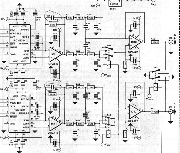

I have built the "Elektor DAC 2000" some time ago. Efter modding it with AD797 instead of OPA627 the sound has improved a great deal.
I would like to have switchable tube output though. Like the Shanling CD-players.
I need advice on:
1. What kind og tube design to add (SSRP, etc.
2. What kind of tubes. I have a few 12B4A, 6N1P, E80CC to try out.
3. Where and how to break in to mu exsisting circuit to add the new tube output.
Any ideas?

I am building the same Dac, and I plan to use a relay from Iout (pin 14)from the Dac so I can switch beetwen the two outputs.
I am going to use a SSRP with 6SL7,and the simple solid state I/V converter from this forum.
Directly at the DAC output Pin.

jazzpeter65 said:
I just don't get if the V/I-stage is needed or if you can connect it straight to pin 14 of the PCM1704?
Straight to pin14, all solid state parts disconnected.
Alternatively, if you wish to have both stages operational you could add a resistor (same value as intended I/V Resistor for Tube section) in series with inverting input of the I/V Op-Amp after the DAC.
However, this does not remove the Solid State circuitry from the signal path and hence the Valve Stage will retain a trace of "solid state" sound. I tried this forst for my Shanling Mod's as I intended to leave the solid state stage in place. I found it compromised the sound much more than I was happy to accept, so my mod's to the Shanlings dispose of the SOlid State section completely (the headphone Output is gone too).

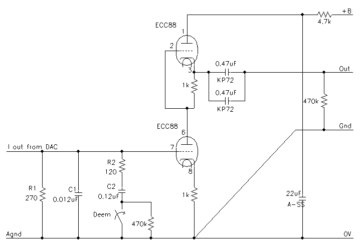

For Deem I am going to leave out R2 C2 relay and the 470K resitor.
Yes it´s in R1 the I/V is done,but if I use the Easy-to-build I/V stage i was going to leave out R1.
I thougt of using the same B+ as I did with my SRPP for my PDS904 witch is regulated at ca 250v.
Why leave out R1?
Ryssen,
Why do you want to use an active I/V converter circuit when the same function can be made by a simple resistor?
I think the whole idea of a simple analog output gets lost if you use an opamp for I/V. Most DACs exspect to send current into a virtual ground. In most cases in form of an opamp.
A load resistor is a more simple way to do this, but its not working with all DACs. Multibit DACs are not a problem, though. PCM1704 is multibit DAC. A load resistor will give less distortion than using an opamp. IMHO you should keep R1 since its a clever way of keeping the signalway short.
/ Peter
I agree that a resitor is simpler (shorter way) of doing I/V convert.
I got this advise "Try it, you won't be sorry" in this thread:http://www.diyaudio.com/forums/showthread.php?s=&threadid=6121&perpage=15&highlight=&pagenumber=9
Question number 2:I have read somewhere It sometimes sound
better with the right (Different value on the resistor)would it be possible to use variable resistor to find the right value?

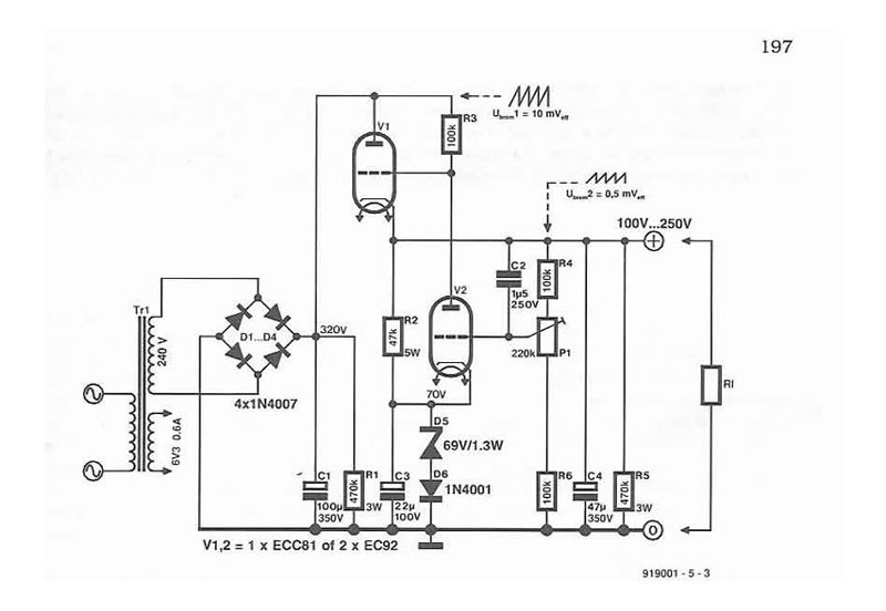

won`t solidstate regulators be better since they do not display any symtoms of noise?
I a´m thinking about it 2
http://www.diyaudio.com/forums/showthread.php?s=&threadid=31447

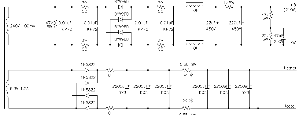

Sayonara,
I have read your arcticles and so far, I get most of it. I have a few questions though, before I start building>
1. Would a regulated solid state PSU give a better signal-to-noise ratio? See attached circuit.
2. PSU: Can I substitute the special resistors for normal ones?
3. What do I have to change to use E80CC or 12Bb4H?
- Peter
