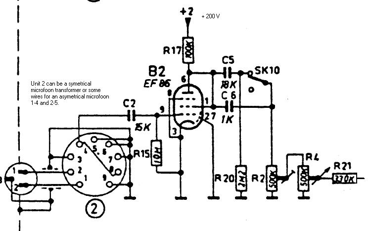

Here a schematic diagram of a mic_amp with the EF86.
Mississippi
wouldnt that unloaded mic transformer create a peaky audio response?? 10M load on the EF86 grid to me should be more like 50K to load the transformer properly, presuming a 200 ohm to 50k typical transformer.
...Hugh
:xeye:

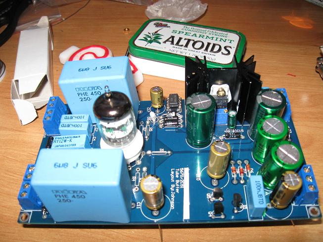

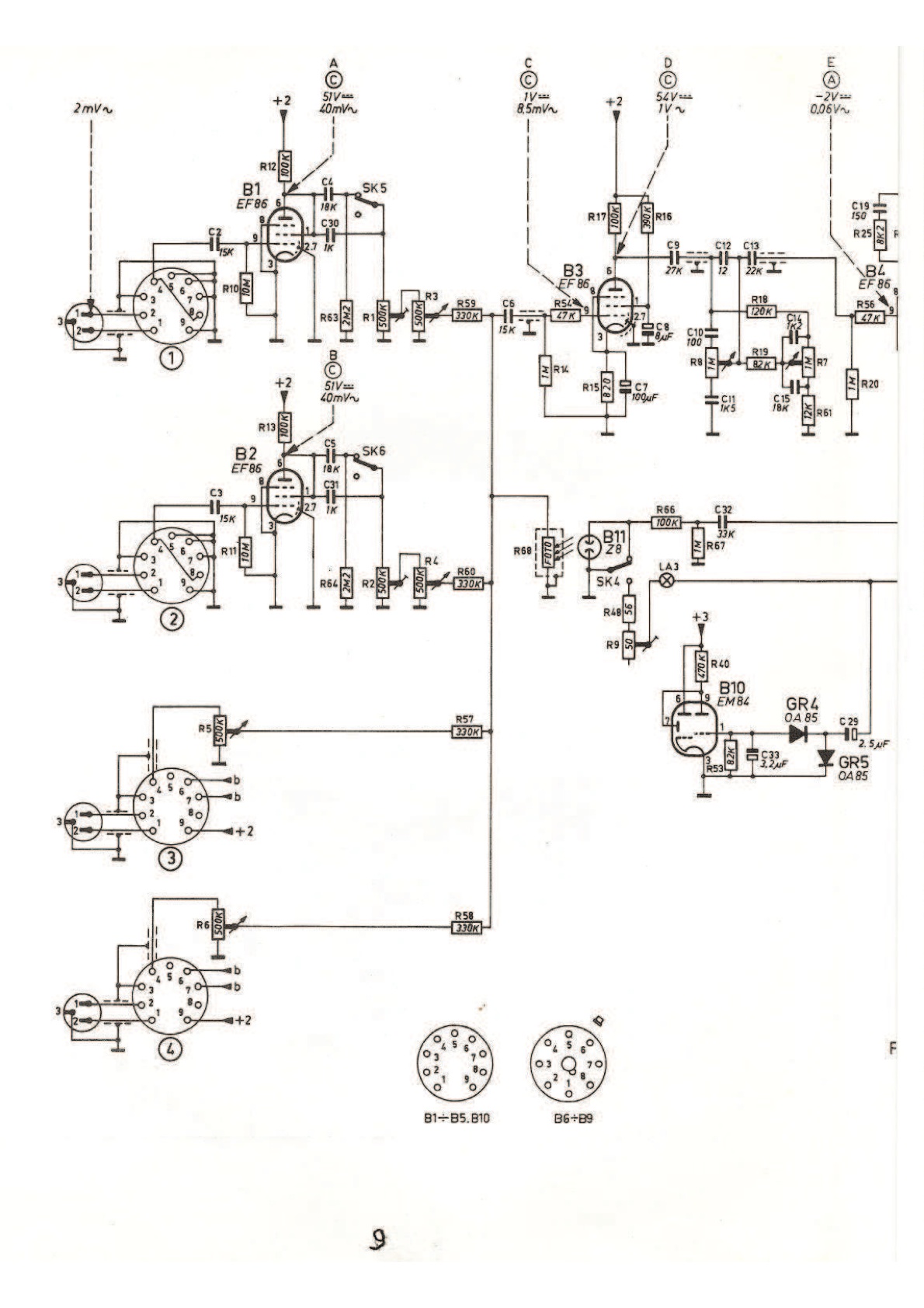

Late reply
Hey Ruffrecords, I know this is a bit late as a reply (only 3 years), but better later than never. The pre-amp is part of the EL6425, valve mixette/amp produced by Philips in the 50/60's. I have the EL 6415 at home, which is almost exactly the same, but less output power on the amp side. I think they were made to work with 50 Ohms type of mics at the time, at least the one I have with me. I'm trying to work on this at the moment, some help/guidance would be appreciated.
