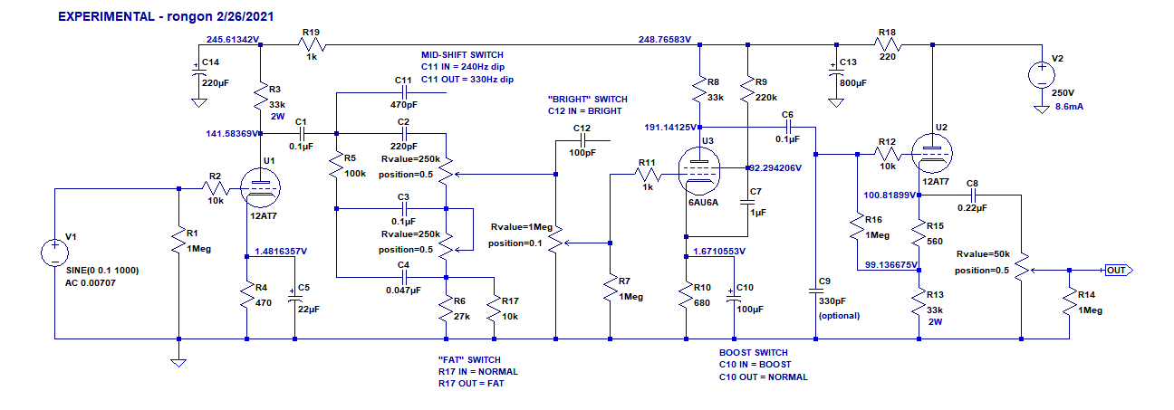

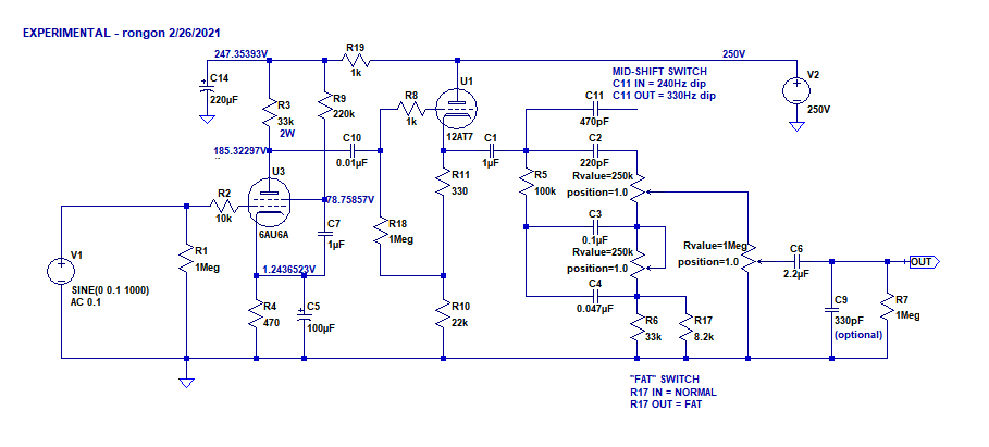

I think I'd like to try a 12AX7 or 12AT7 style hi-mu triode as the input stage, into a pentode stage set to generate a good amount of THD and dynamic compression of the audio signal, with a tone stack or a simple one-knob tone control, and some kind of output buffer or OPT for impedance matching to power amps. I think getting that 2nd stage pentode to 'enrich' the tone might be worthwhile for getting an unusual sounding clean tone.

A low-mu triode driving an OPT with a step-down ratio of 4:1 or so might be just what's needed here --- A cheap, limited bandwidth Edcor or similar SE OPT might be perfect.

Does anyone see details of chosen operating points, etc. that might have a large influence on THD, etc?
