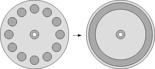

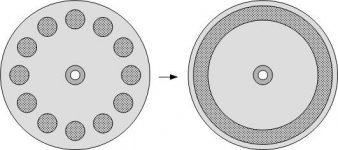

Platter leadshot damping
Another issue:
WHY is it that designers damp with 12 (or so) symmetrical circular spaces filled with leadshot. I mean, I'm sure that compromizing the homogenous structure of the platter is not good for the balance - why not keep that to a minimum by constructing 1 concentric "chasm" and fill that with leadshot (make it close to the platter boundary for better inertia). That way, radialy you still have a varying structure, but at least it's tangentially symmetrical. Like in the picture attached.
Anyone?
-T
