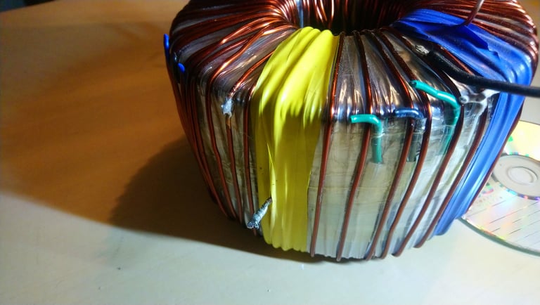

The windings that were there as original were not tight, (picture) and the new winding I want to put on comes closer to the core even though there is plastic splicing on the conductor
I know you usually don´t use plastic insulated copper wire, but it will be easier and much cheaper and that is something I already have.
It is outer and final winding so it is limited how hot it will get.
The question was whether it could be done at all.
The voltage should be 2 x 42.5 Vac and the current around 12-15 amps

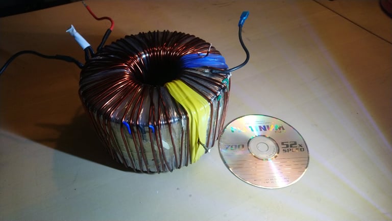

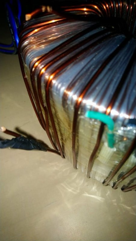

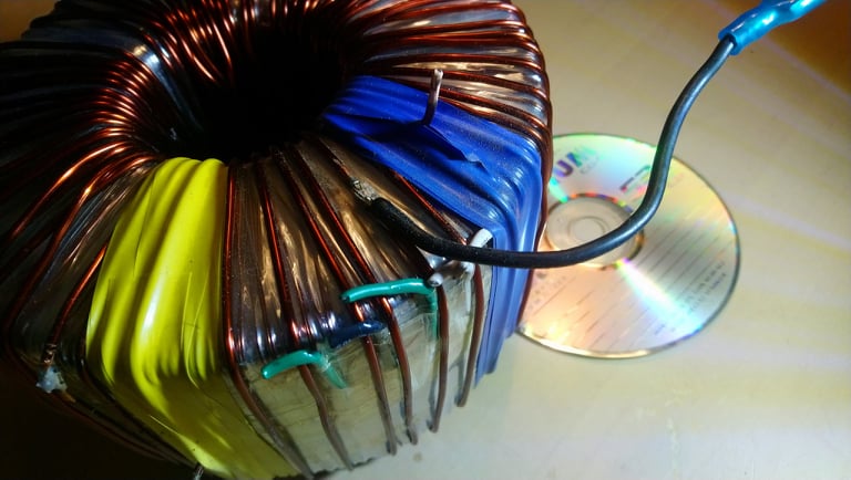

I finished it and used the same copper wire that I took off. I had to solder them together as it was not in one piece, but the solder is nowhere near anything other than lacquered wire.
Both windings measure 42.40 Vac
Not bad as first try. It will work if you don't need the full 3800VA of the original configuration and the load does not draw more current than the recovered wire section will allow (I assume you already checked this). If you want to further improve the work:
- use Kapton tape instead of standard PVC electrical tabe. Kapton tape will not become soft and sticky when the transformer core will become warm.
- try to space the winding evenly around the toroid. This will maximise the iron core utilization. Avoid overlapping coils.
- use a spaghetti tubing on the lead out wires and on the soldering.
- P.U. foam may become smelly and loose when the core will rise the temperature. It may be OK only if you plan to derate the power drastically, let's say 50%. Check the product label or make a test before application. There are special potting compounds for transformers on the market.
I have used the same wire that was sitting there originally.
The transformer will be used for 3 class D amplifier boards, each of which is approximately 6-700 (real) watts (4 ohm). And since it's music and not continuous power, I'm not getting near the 3800 watt limit. However, due to the thickness of the wire, there is a low secondary impedance.
But thanks 😉
I don’t think it’s 3800 VA. That’s the same weight as the 1500 VA Anteks. You *can* pull a full 1500 watts off of them, drawing over 2kVA. But not 3.8. How many volts per turn did you end up with? 1.5kVA is typically 1 turn per volt, 1kVA is about 0.8.
You do need to tape the windings. The Mylar non-adhesive stuff is nice - but EXPENSIVE. Kapton is more readily available from the usual distributors. Don’t use plastic spaghetti tubing to cover the solder joints and provide strain relief - get the non-expanding polyester braided tubing from Alpha Wire. That’s designed for applications like this. Many trafo manufacturers use it. 25 foot roll will be about 30 bucks, but will make many transformers.
