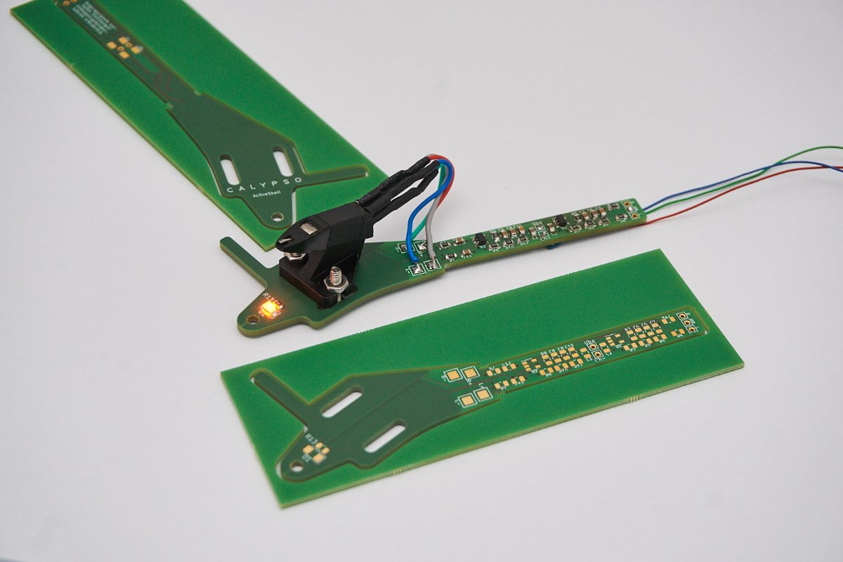

While I was pondering about cable capacitance in general, I eventually arrived at tone arm wiring. Then there was the question, how a tone arm made of FR4 might perform. Lots of options how to route the wires, including multi-layer boards for shielding all the way around. Thinking along that line, how a four-layer board might compare to a classical tone arm (consisting of a metal tube) capacitance-wise, there was another idea. Parts have gotten really small these days, you can even get the successor to everyone's darling, the 2SK170GR, in a SOT-23 package (IF170A from InterFet); so why not put the "head amp" right there at the "head" of the tone arm? Again, lots of options here. You could do a mirrored design, with one channel on the top layer and the other one on the bottom layer, granting lots of space even for multi-stage op amp designs. Or simply use a single JFET stage, like I have shown in my concept image, to somewhat make the cartridge resemble an electret microphone capsule with its FET already on board.
I'm in for a turntable, so I might as well start the DIY route. Any thoughts? Opinions? Anybody ever did something like this and I didn't stumble upon it? Any killer arguments against this? I've seen tone arms built from a stick of wood and magnet wire, so...

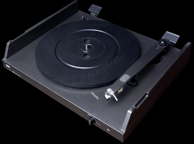

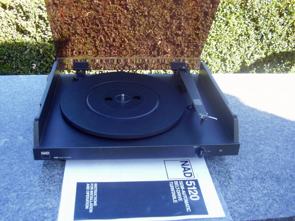

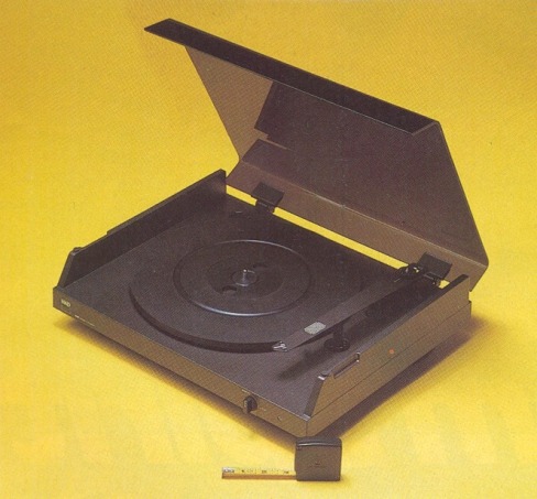

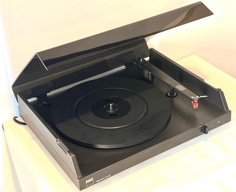

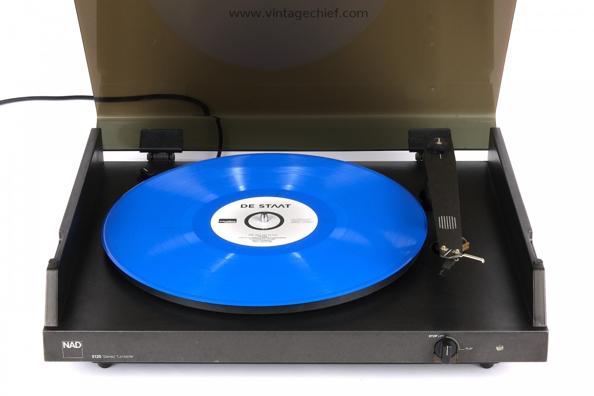

NAD used to make cheap turntable with tonearm all made of pcb. Long time ago I used to have it. It sounded great, except it has static electricity buildup issue.

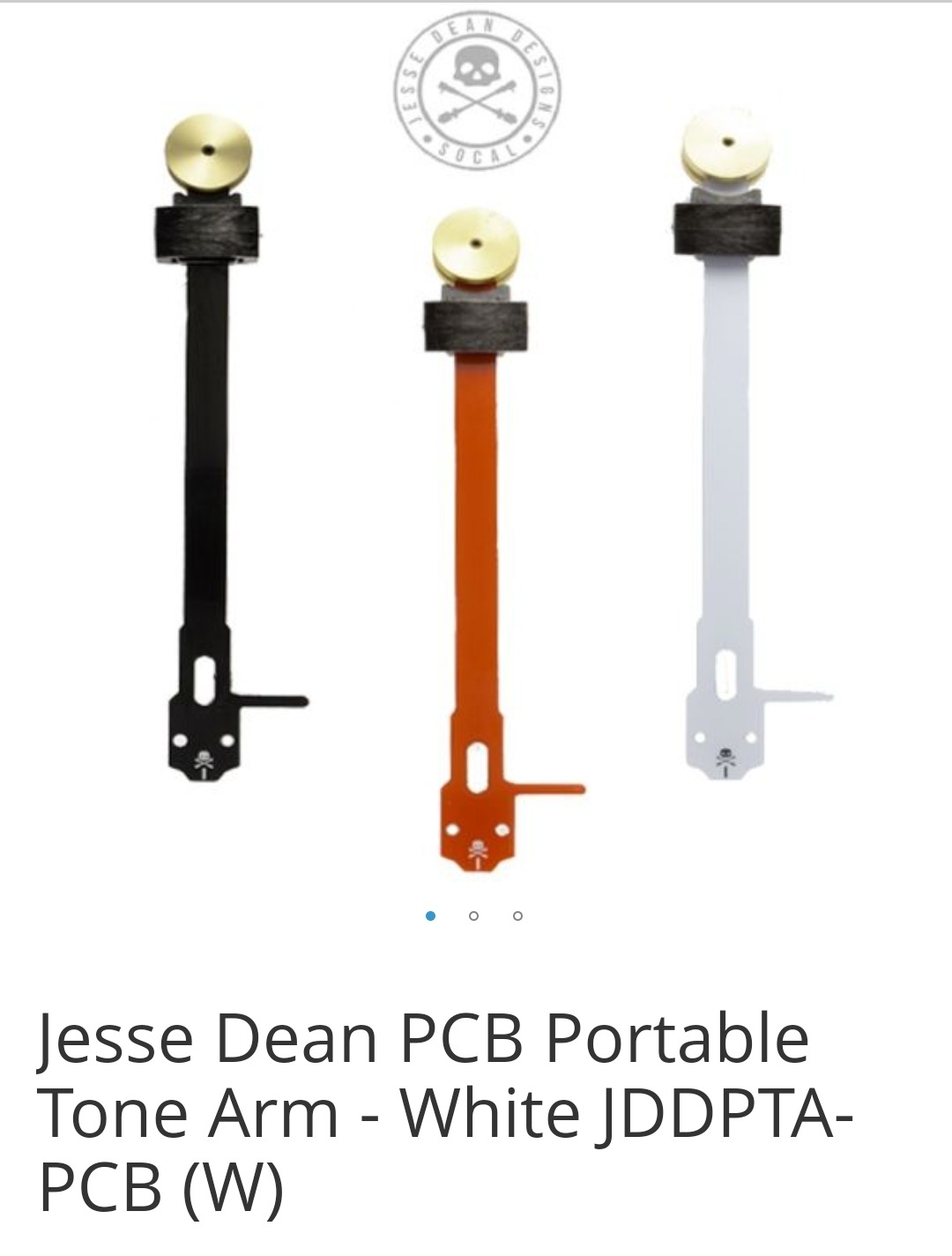

There are recent examples of PCB tonearms. There is a market for whimsy portable turntables and a niche of this niche are people modifying those turntables with custom tonearms to hold scratch battles. Unbelievable? Yes, but true 😌
Shop here: click
I had the chance to touch one of those, after that you realise the PCB part may be sufficient, but what about the bearing, the gimbal, the anti skate? Will it really make things easy to make a pcb tonearm while you still have to engineer the rest of the device to get a complete tonearm assembly?

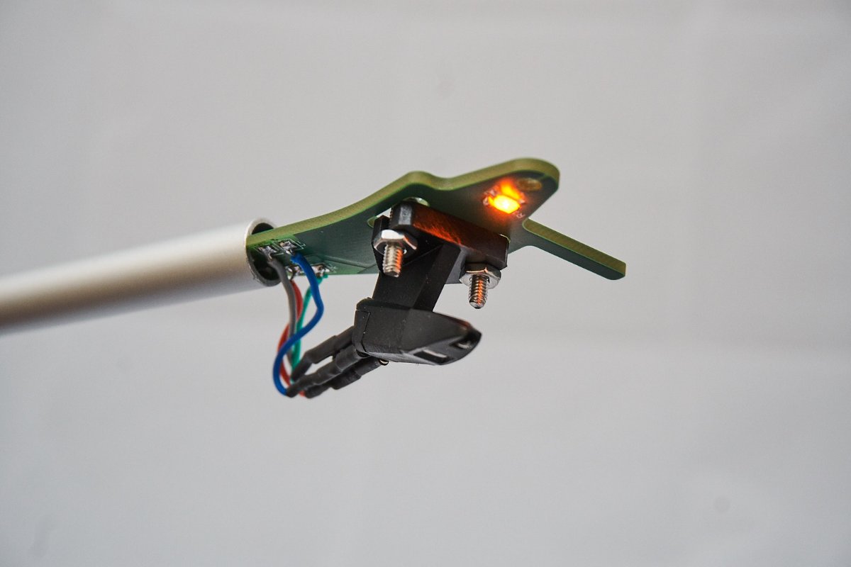

A very small designed smd PCB for your head amp might even fit inside a conventional tonearm tube.. That could give a much more professional look and feel compared to a tonearm made of FR-4 board entirely.

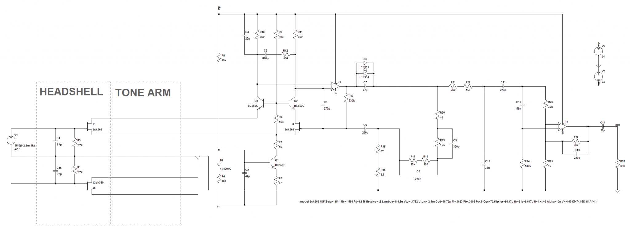

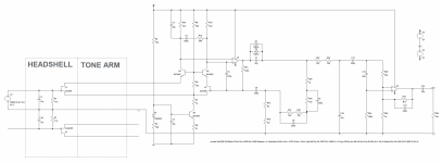

Just had another idea for the amplifier part. I found a salvaged RIAA preamp board from a Pioneer A-717 in the workshop, had a look at the schematic, and wondered whether I can't simply take one JFET out of the cascoded differential input pair and put it on the headshell? That would certainly be easier than building a whole new buffer stage and then adjust the RIAA stage to suit (without a noise penalty). As far as I can tell, the tonearm wiring should not introduce any problems in that case. The input cap and resistor would have to be adjusted to the now-non-existent wiring capacitance and cartridge requirements of course, but that's the fun part of DIY after all, isn't it?

Just my opinion but if you build the preamp on the arm (lets say close to the pickup) you going to have more "wires" running the length of the arm and yes I'm talking about the power supply for the preamp and everybody knows about running low signal wires close to dc power wires and to top it all without insulation just plain copper lines (pcb tracks)
Again just my opinion
