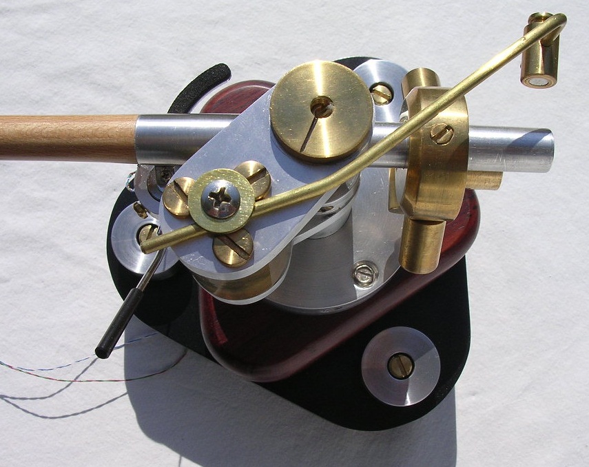

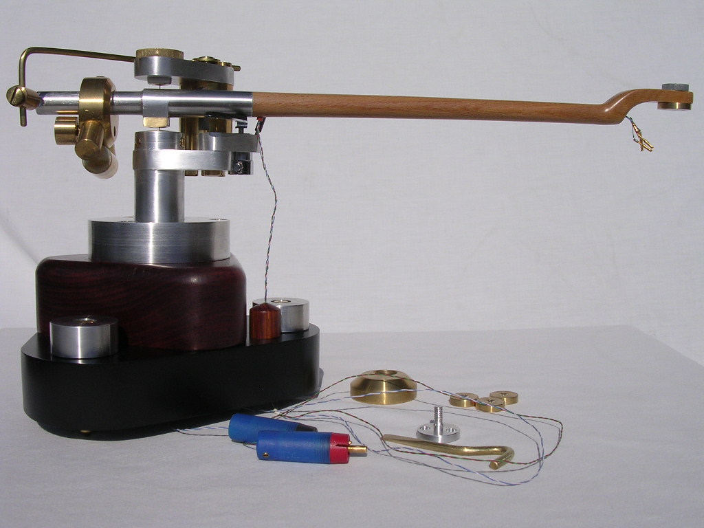

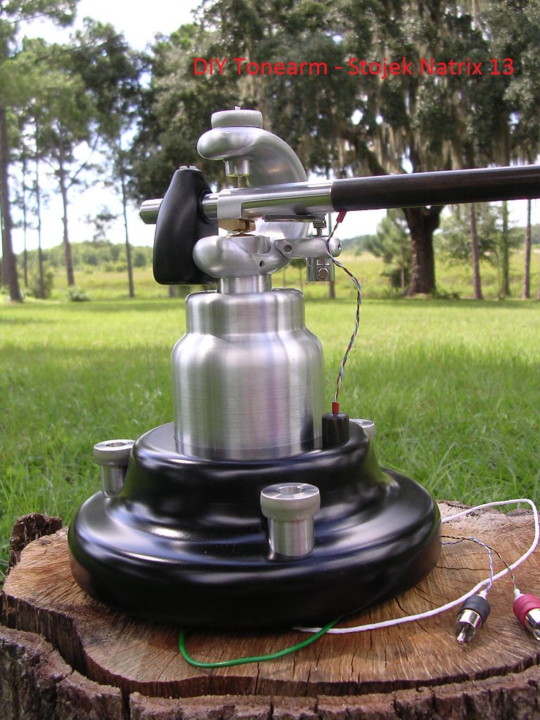

OK,
The pictures of assembled tonearm in post 1 and 2 are incorrect; they were taken during tonearm stability test. Correct configuration is on picture below.
Edward

I've had to acknowledge there are more things to do around my house than build tonearms, but before that I increased the size of the monofilament and the way the arm is positioned in the ring. The larger monofilament allowed more tension - nice improvement. At first, the arm had slots at the top and bottom. The strings went through the slots and positioned the arm when under tension, but the arm could slide sideways and rotate. I drilled four holes in the arm which allow the string to be cross-lace through the arm - can't slide or rotate now and because everything is triangulated there's no sag. I can probably do something similar with the ring suspension to remove residual bounce there, but on the other hand, there's that "design creep" EC8010 mentions.

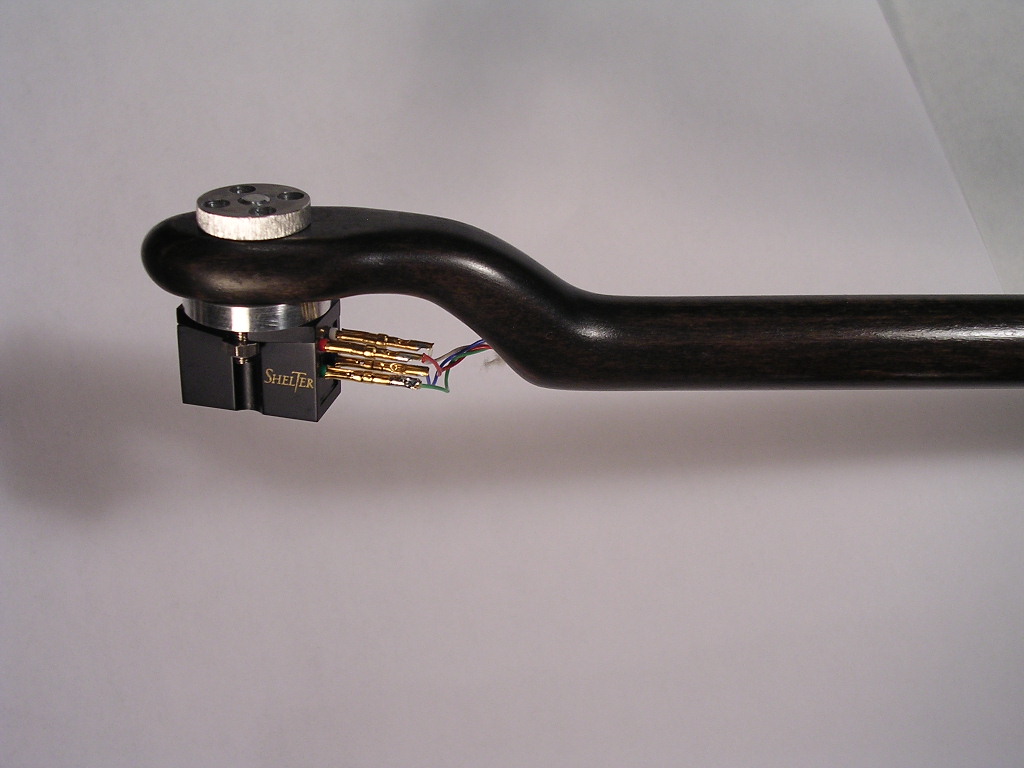

Pictures of the Schroeder model one with the two-string trapeze show a longer than usual end stub and a Denon DL103 on the business end.

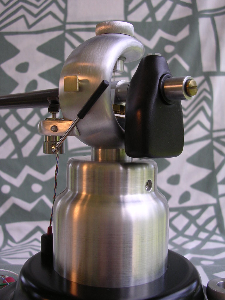

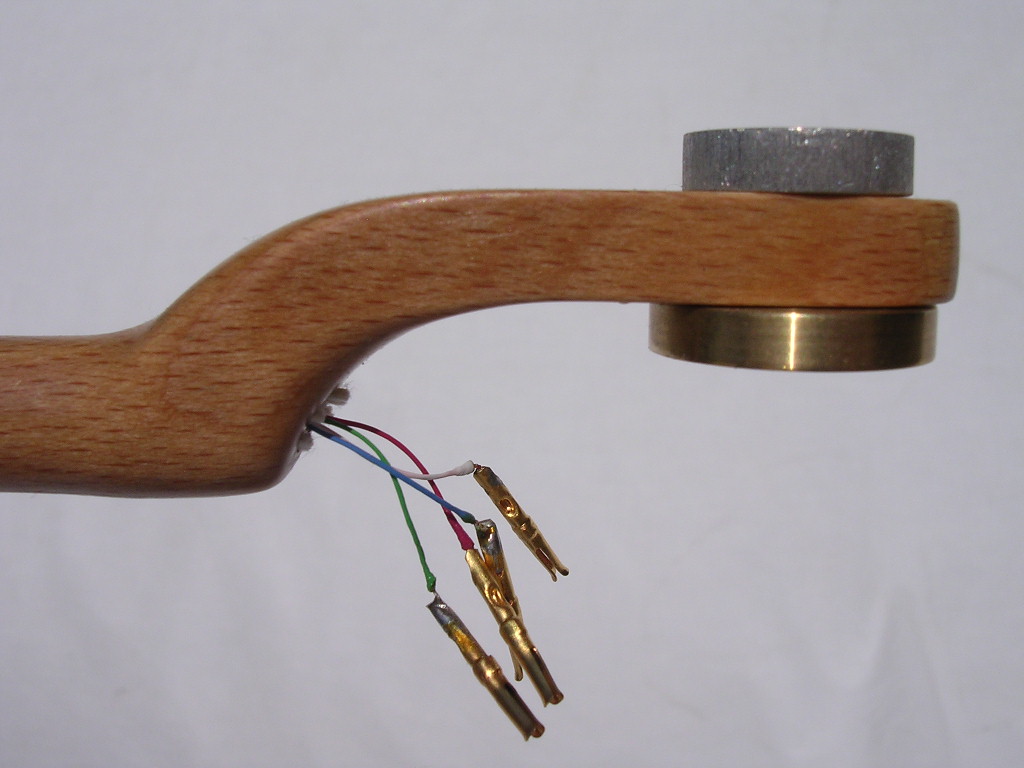

Edward/Marek,
Not quite sure who I'm talking to, but, regardless, that is one beautiful arm and my guess is that it sounds as good as it looks. Thanks for posting the detailed photos.

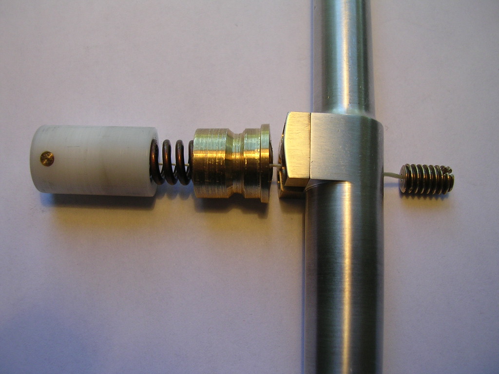

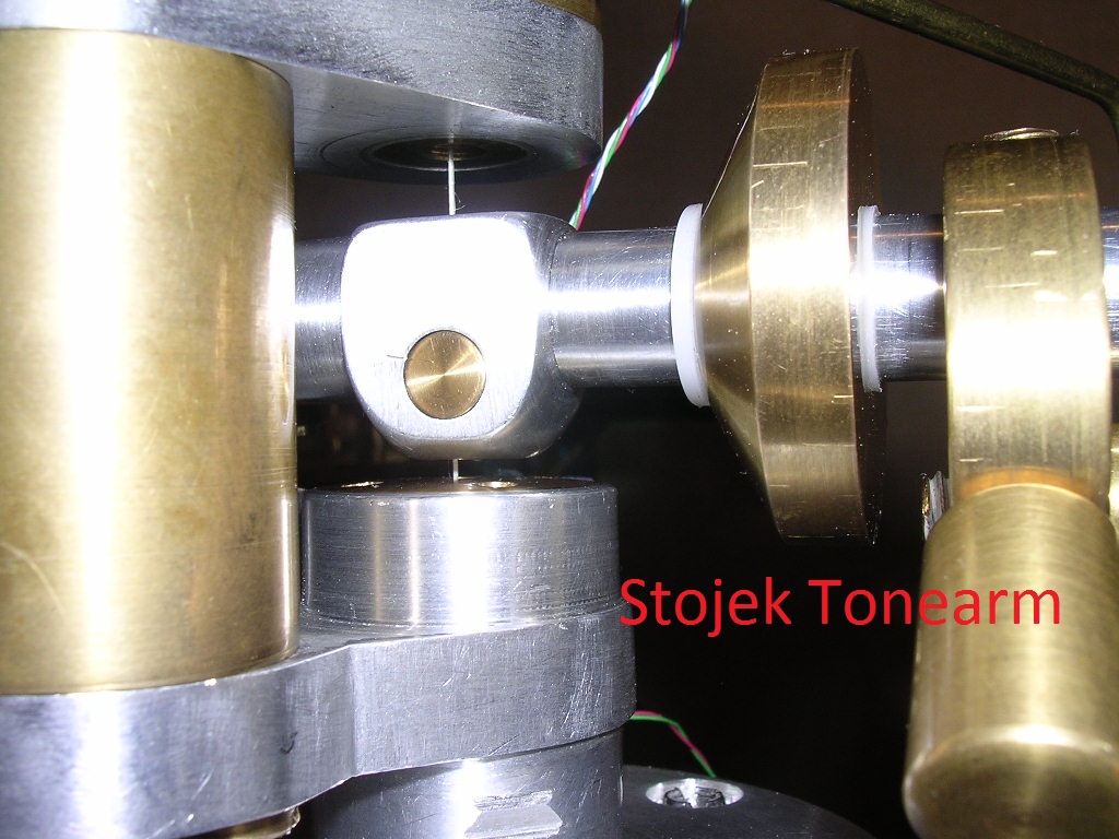

Hi Tade,
You are right, freedom of movement in direction of drag as well as changes of drag caused by changes of VTF mess up the sound. The fine example of that is WT - its sound is described in post #22.
In my tonearm drag changes are very small. They are practically limited to changes caused by changing modulation of the groove. So my tonearm has not much reason to move back and forth. The tension of my string is a few kilograms so my tonearm has not much freedom in that direction either. Also, to limit horizontal movement and vibration of the string, the string passes through a small hole drilled in the base. The hole is located just under the wand.
When tonearm is suspended by string, changes of VTF caused by cartridge moving up and down when playing wavy record can be big and consequently changes of drag can also be big. I calculated those forces and designed the pivot accordingly. The picture shows how my string exits part of the wand – diameter of the hole is only 0.8mm, so the bearing acts almost like a conventional unipivot but without the wobbling.
Below is my simplified formula I figured out to calculate springing reaction of beam (wand) suspended on tensioned string:
VTF change=x *h* F /L^2
x - Vertical travel of headshell
h - Vertical distance between upper and lower suspension points – in my tonearm it is about 1.5 mm.
F - Tension of the string
L - Effective length of a tonearm
I have used same equation to calculate geometry of Schroeder clone. My formula is not good for WT tonearm as viscosity of oil can make things much worse than wrong geometry of the bearing does.
What did I achieve? Sound waves induced by vibrating stylus travel in the wand and return to cartridge generator distorting generated signal. My tensioned string drains sound waves out of the wand more efficiently than needle point does. Needle point may look like a rigid coupling but it forms acoustic barrier. The sound of my tonearm is cleaner, more detailed, natural and more dynamic than conventional commercial unipivot I have tried.
I hope this answers your questions. More info is in my posts.
Marek
