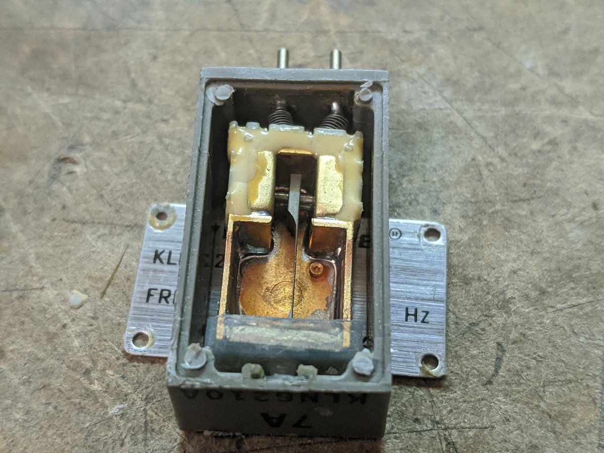

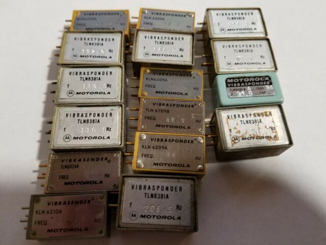

Here is another that I have experimented with off an on since my first day at Motorola in 1973 when I first met the Motorola Vibrasender and Vibrasponder (essentially the same thing).
Here are two pictures of a device that Motorola used to detect or generate fixed audio tones used for electronic signaling in two way radios. Larger versions were used back into the late 1930's. These are from the last generation in the 60's and 70's before an opamp based chip replaced them.
Inside you see a mechanical vibrating reed with two tiny magnets glued on the end that moves. There are two coils, one near each magnet. To me this looked just like the reed used in a Wurlitzer piano, so I spent some time playing with these and expanding on that idea.
In "sponder" mode an audio signal is sent to one coil, and the other coil goes to a level detector. When the audio signal is at the "wrong" frequency, nothing happens. When the input frequency is very close to the resonant frequency of the reed, it will vibrate, and the moving magnet will induce a voltage in the other coil, tripping the level detector.
In "sender" mode there is no level detector. The signal from the output coil is amplified and fed back to the input coil creating an oscillator, to generate the tone.
There was a bank of Vibrasenders in the dispatchers office, and a unique Vibrasponder in each taxi's radio so one radio could be individually called.
So the Dumm Blonde One wires one of these to a guitar cord and smacks it with a drum stick, and music was made. Then he learns how to take them apart and "tune" them to musical note frequencies with some well placed solder. He might have spent days experimenting with the coils out of these things and a guitar string stretched out on a 2X4. Maybe even mounted a few inside a kids toy piano.
The Vibrasponders came in two flavors, most were used in "subaudible" (low frequency) signaling, such that signaling and voice could be sent at the same time. The lowest available frequency was 67 Hz and the highest was around 200 Hz. The coils from these did not respond well to the higher notes on a guitar string. There was a much smaller Vibrasponder with frequencies from 1Khz to 2.something Khz used in pagers, but their tiny internals were too easily damaged for many successful experiments.
Once the idea was planted, it didn't take much for me to swap out the Vibrasponder coils for guitar pickups. Yes, it's possible to take two pickups and a healthy opamp and make a guitar string play itself. Hours of fascination ensued from 6 strings mounted on a 2X4, tuned to an open E chord, and a Coricidin bottle.
This the principle behind the "infinite sustain" systems seen today. My experiments at the time (early 70's) were done with a pair of plastic housed unshielded pickups from an old Hagstrom. I still have them. There was a very narrow range of feedback gain where a self sustaining string happened, and before utter mayhem broke out. This could be improved with shielding between the two pickups. Things might have worked out better with grounded metal cased pickups. Attempting to make all 6 strings play nice through two pickups creates all sorts of unwanted tones where harmonics of the bass strings tend to excite higher strings.
I want to explore a separate sustainer for each string, hence the hex pickups.
The popular Ebow works the same way with two metal rails on either side of the target string, with a coil mounted on each rail.

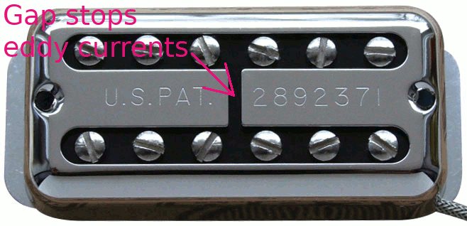

...brass pick up cover...
It's interesting to look at the design of the Filtertron humbucker cover (image attached). The metal right around the pole-pieces is cut away, and there's also a gap cut in the metal so that eddy currents can't flow in a big loop that encloses all six pole-pieces.
Clearly, the designer of the Filtertron was thinking about eddy current losses in the cover more than his counterpart at Gibson did.
-Gnobuddy

Eddy currents must have some impact, is it the only cause?
Dunno if it's the only cause, but in the case of the thick brass pickup covers, I think it's a major one.
Maxwell's equations tell us that eddy currents increase with frequency (the dB/dt in Faraday's law of induction), so eddy currents do tend to affect high frequencies most. These currents decrease if the material is a good conductor (low resistivity), and also increase if the material is thicker (low resistance). So thick brass is a pretty bad choice.
Gibson humbucker pole-pieces are ordinary steel screws (conductivity about 12e-8 ohm-metres), so they're more prone to eddy current loss than Alnico pole-pieces. Add in more inductance from the two coils (instead of one), and finally plop a conductive metal shell over the whole thing, and you can see why Gibson's humbuckers would be less bright-sounding than De Armond's pickup design as used by Fender.
