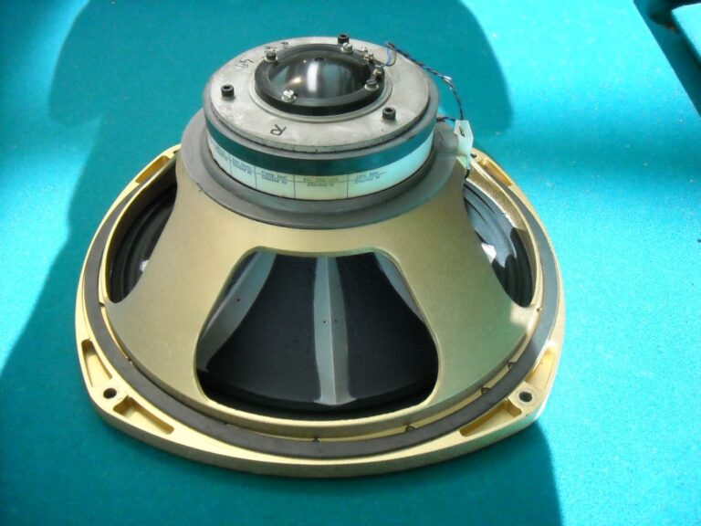

Klaus Reck from Reckhorn sold a driver made like this

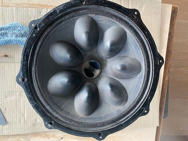

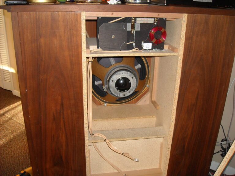

but Tannoy does a more radical stiffening of their big paper cones on the backside of the cone glueing triangle shaped (!) craft paper on it.
Saw it on hifi fairs.

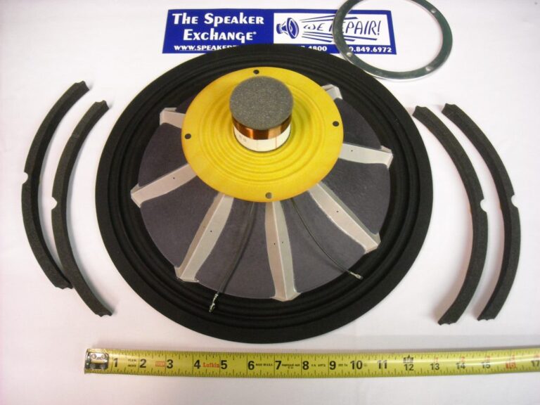

Here is the proof of what I saw on a hifi fair.
Tannoy Westminster with some effective cone stiffening!
https://reconingspeakers.com/tannoy-westminster-3839-surround-conversion/

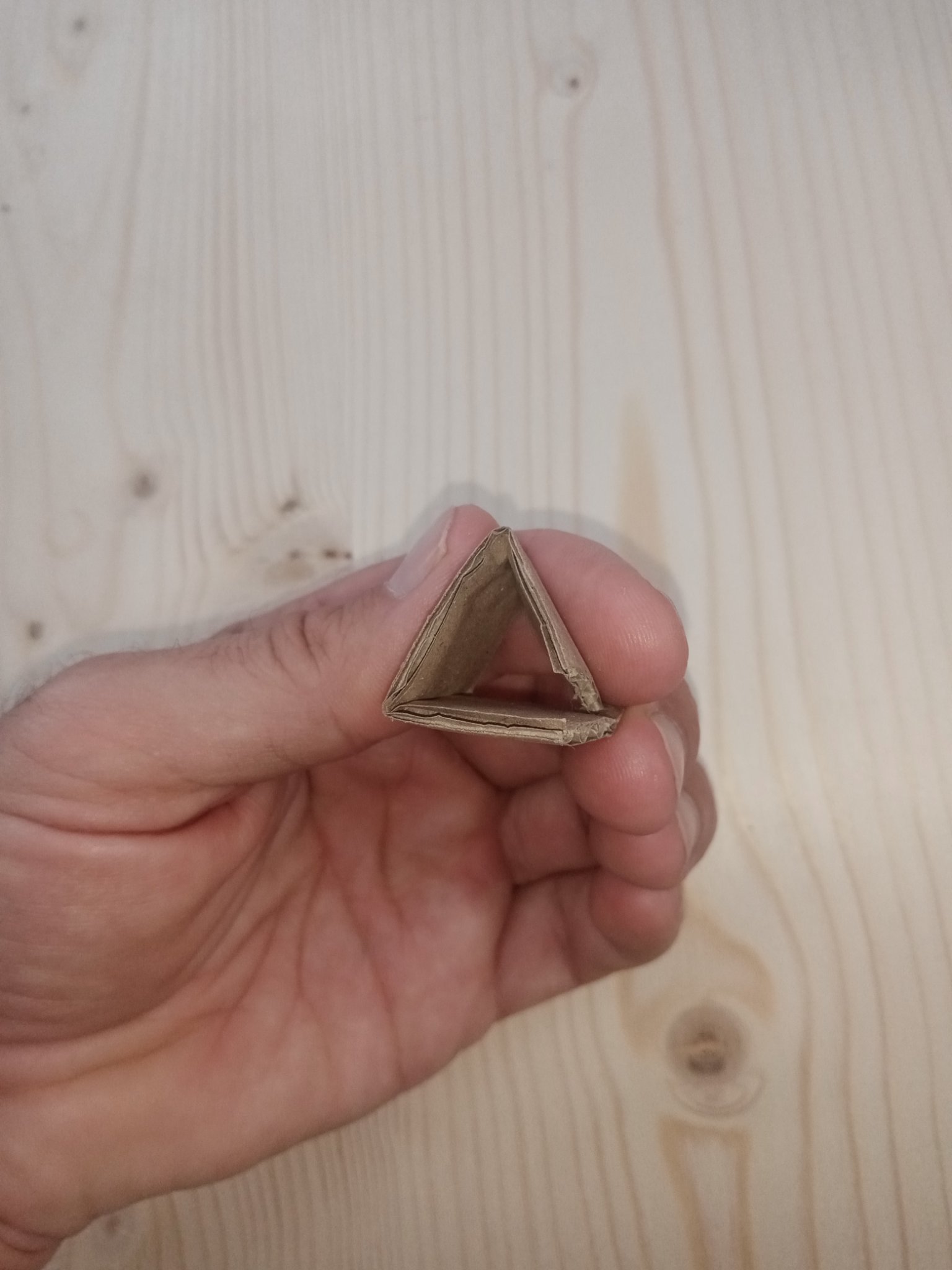

As a demonstration I show how a triangle is formed and with some elastic glue like silicone sealant it could be fixed to the cone.

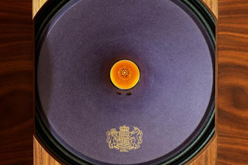

Seems like tannoy shaped correctly a turned over "V" from craft paper and glue it to the backside of their big cones
I think that this deserves more interest, the main cone takes all the forces from the coil, the air pressure inside the cabinet, and the surround; the dust cap is edge driven, surely this would help greatly in pistonic motion? There would be no sound reflections, or air pressure on the reverse side, and it would have smooth, even dispersion. Perhaps it would work well on a 3 inch driver, used as the wide band in a WAW speaker.more orthodox diy cone stiffening using

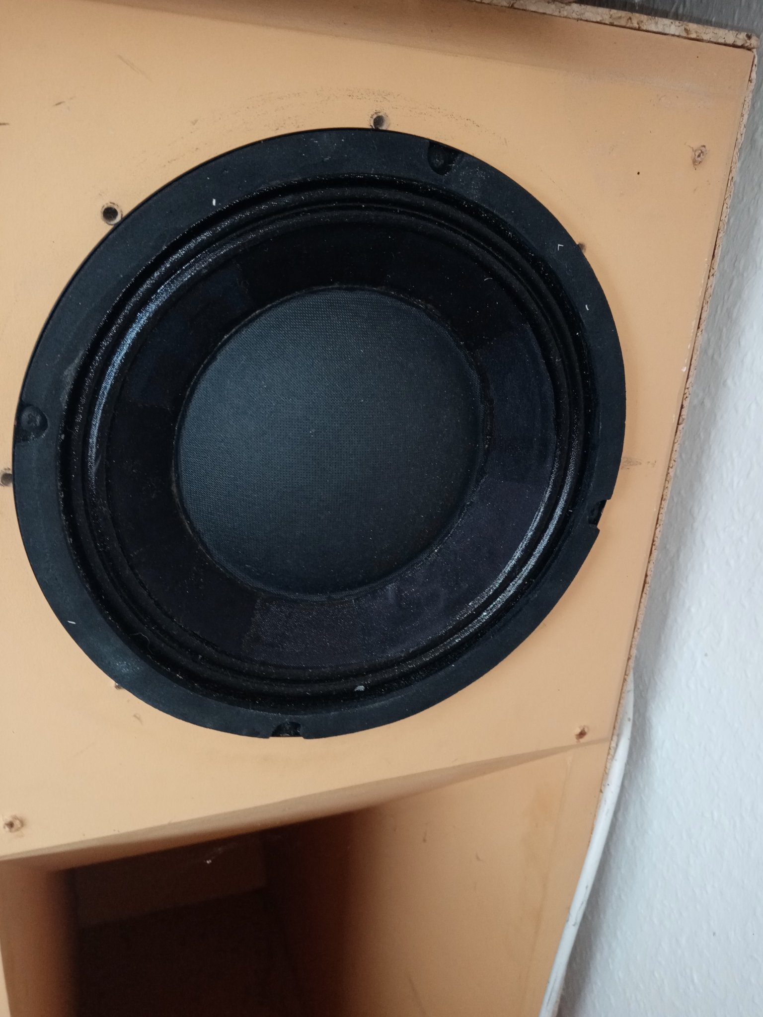

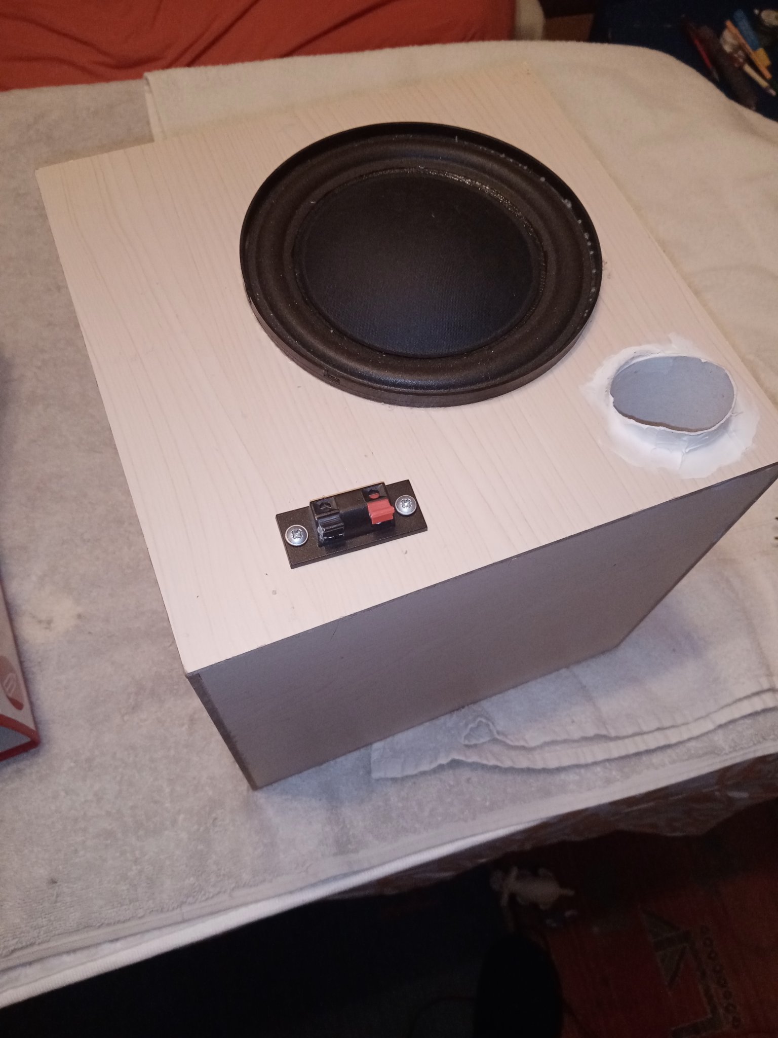

a big dustcap
on a 15cm driver
the subwoofer inside the box is with 1cm concrete and only 3mm wood panels just offering the form for it

I heard the critique that the big dustcap is not supported in the middle where the voice coil has its greatest stiffness.
For the moment I have no measurement data on this at hand for posting but usually you get with this tweak (glueing a big dustcap in) a linear response up to a massive break up point typical for hard cone drivers. So it seems to do something desired for subwoofer use.

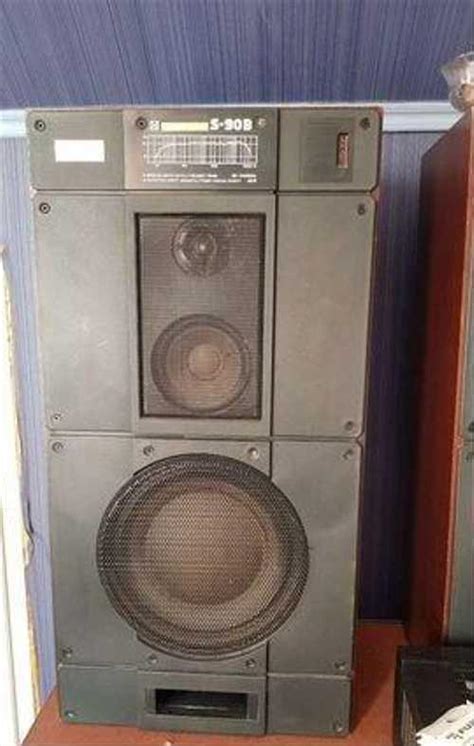

From this driver (GDN75) which was measured in a german diy hifi magazine many years ago where I learned or recognized for the first time about this cone stiffening technique that it follows the same response in frequency:
linear up to a high resonance break up point and then a pretty perfect 12db decline following the theory of how a hard cone should fall off after break up.
This is legendary Radiotehnika RRR GDN75 from Lettland (former russian production line)
it was used in the S90B loudspeaker

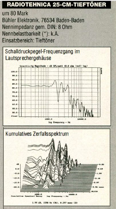

I found the measurements of Klang und Ton from 1994 where the Radiotehnika driver was measured
I have the magazine 1994 nr 3 on my laptop and could look for it ;-)

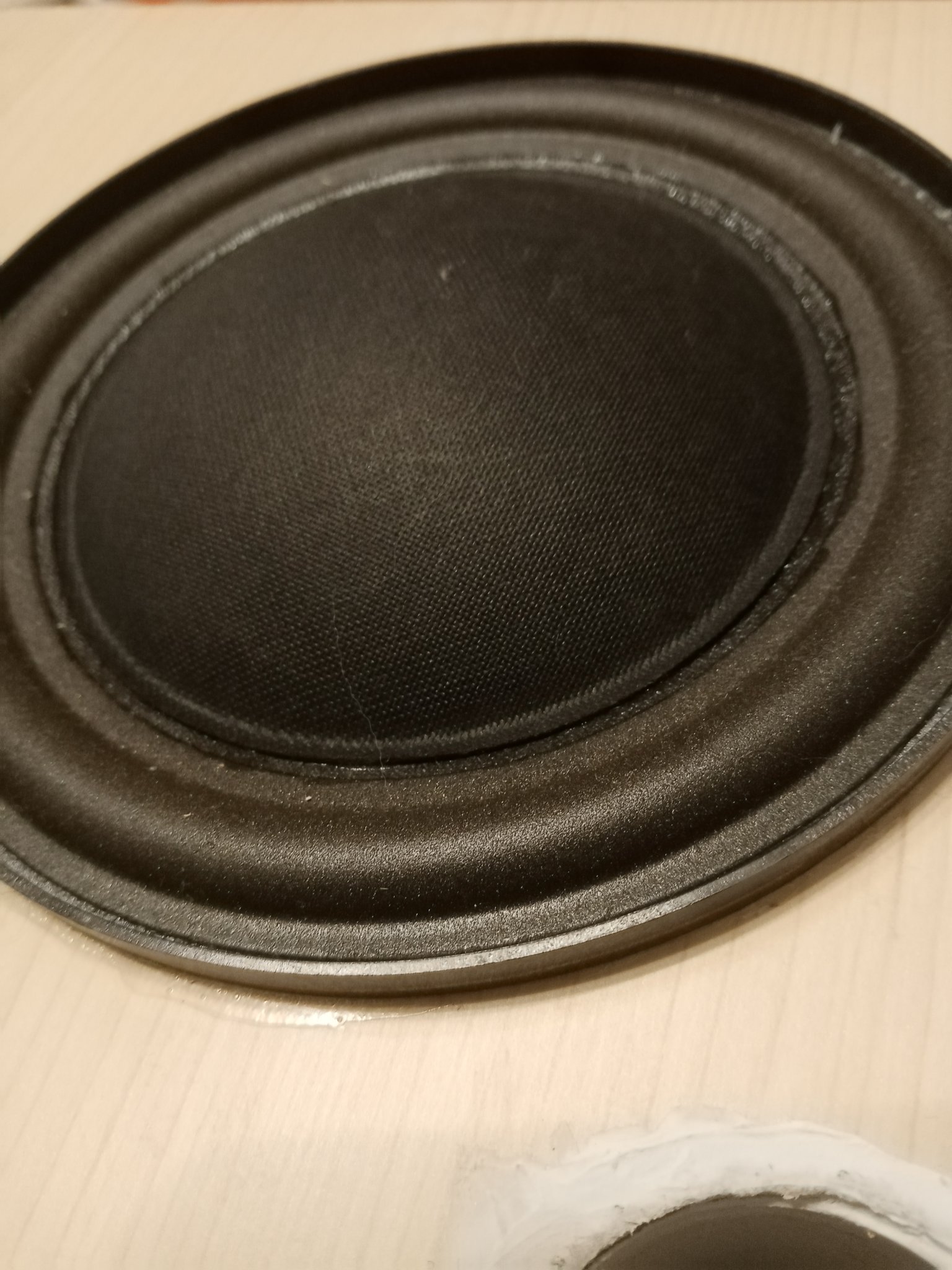

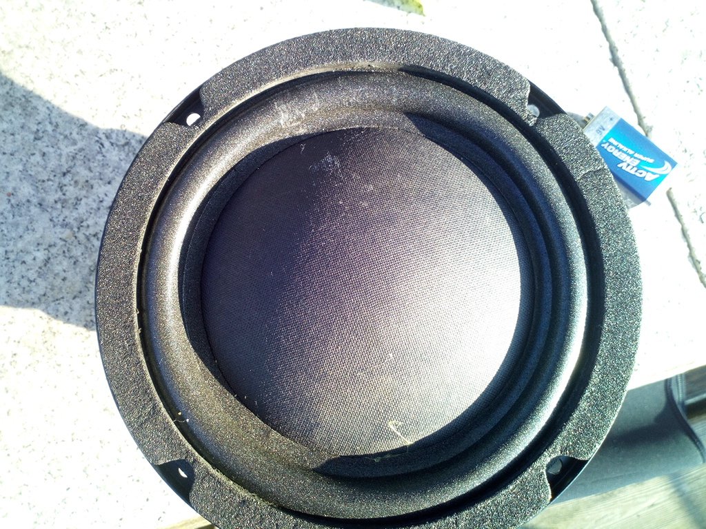

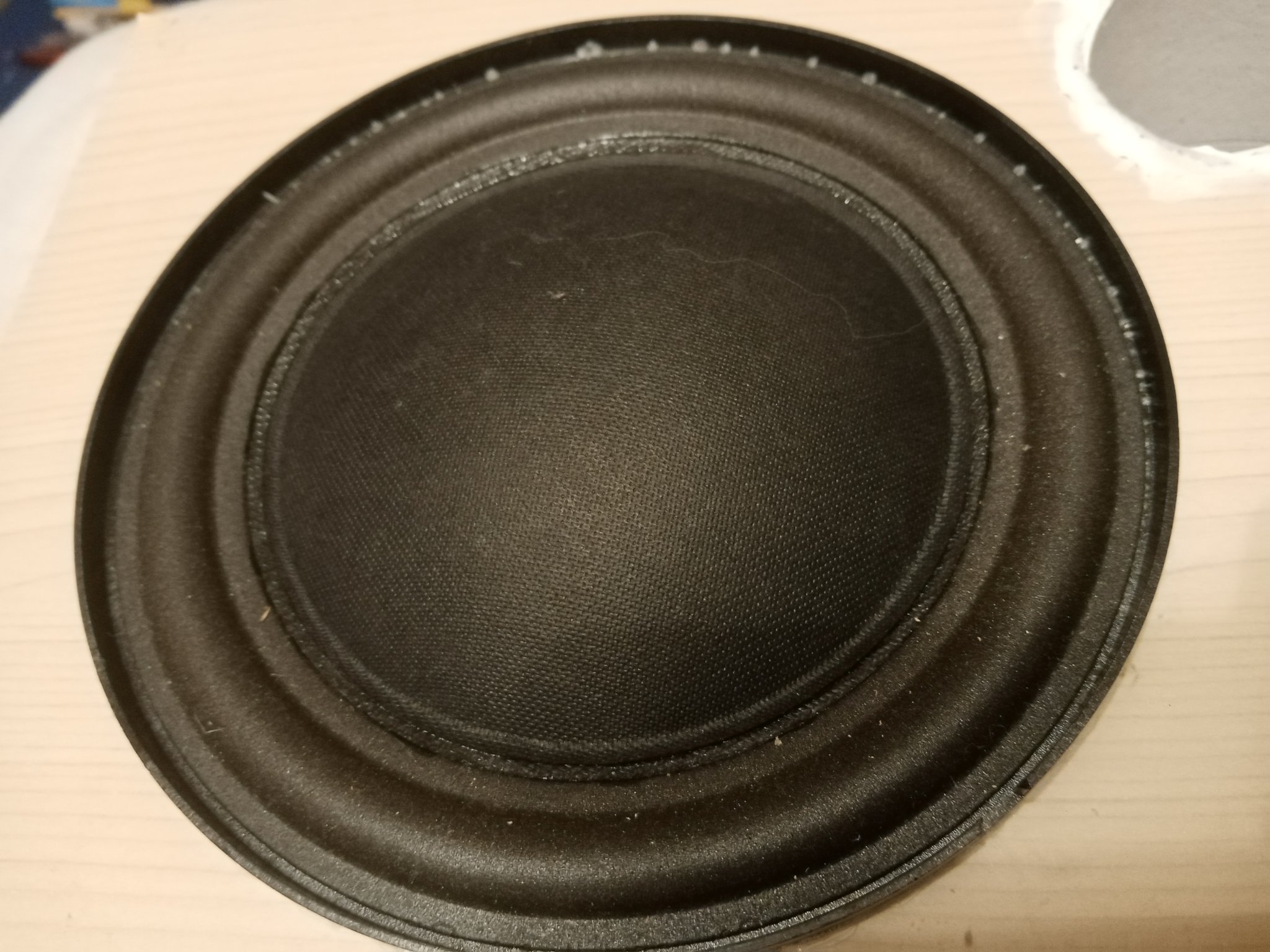

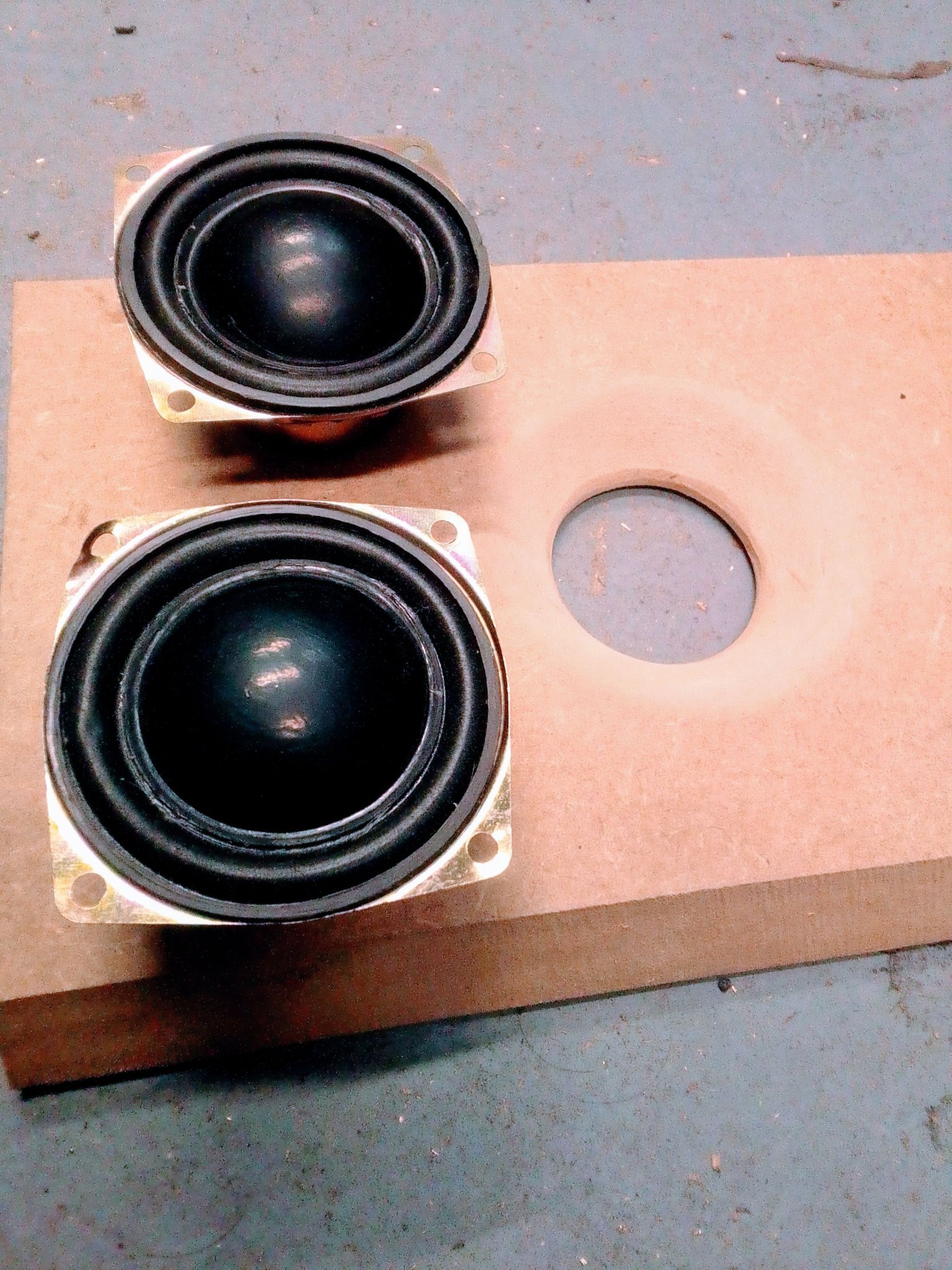

The big dustcap tweak I did sometimes for "only subwoofer use" drivers:
and here on a 20cm driver (its difficult to get bigger dustcaps)

If they would have very big dustcaps this would bring lots of stability like with a 13cm paper diaphragm bass driver I tweaked with a big paper dustcap for getting true piston motion.
