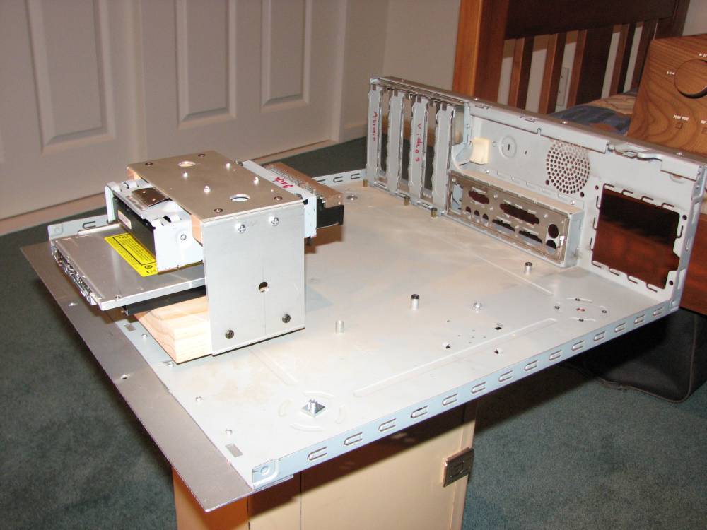

Well, I'm now the proud new owner of a 10year old(?) Pentium III HP Vectra, and have installed it with my optical out sound card (currently running into my mini system).

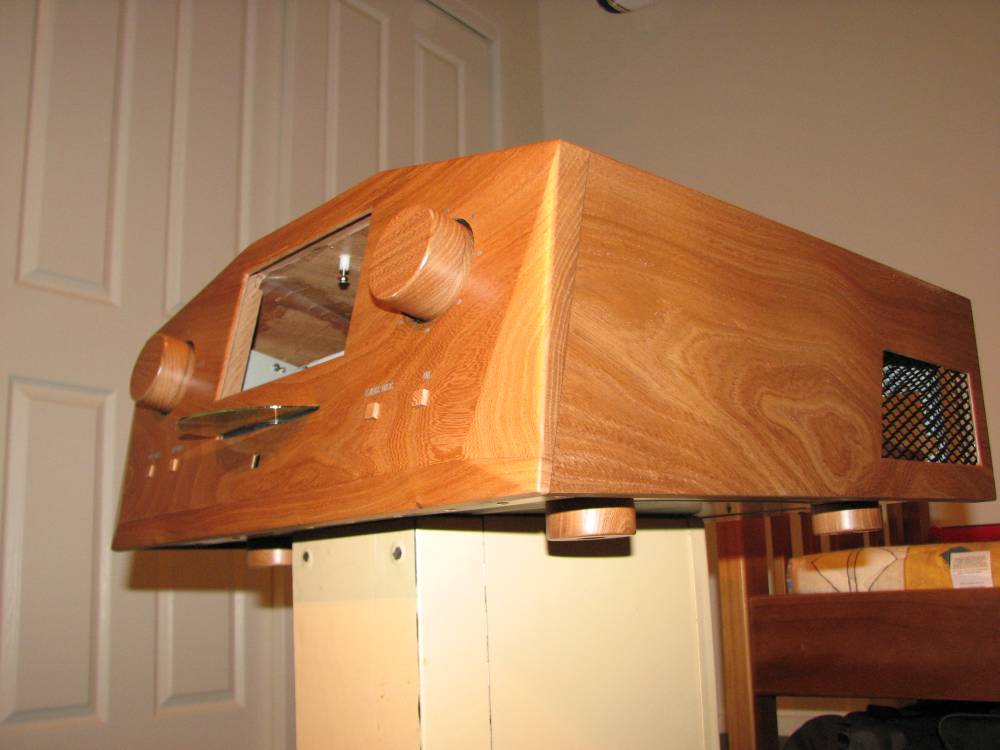

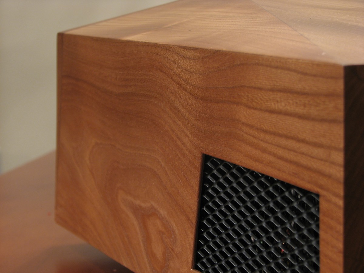

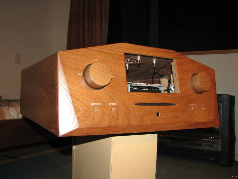

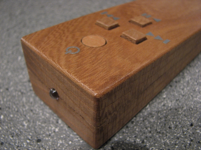

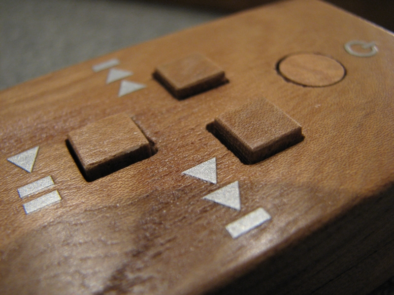

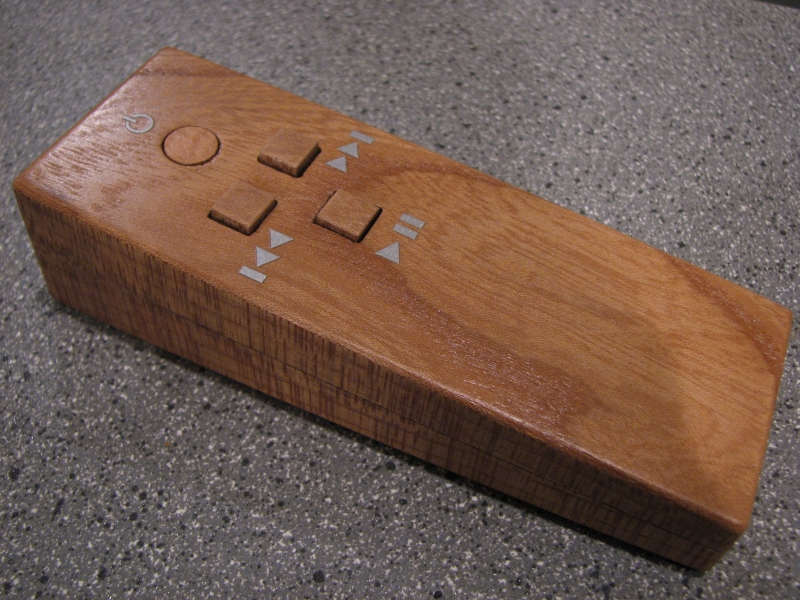

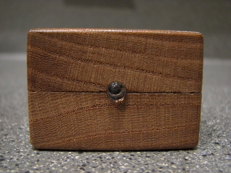

It's been slow going, but I have managed to make steady progress on this project. I have now finished the solid wood case in English Elm (front, top and sides to cover the computer), and am about to get it stained and lacquered after I do a little more sanding. It involved a lot of routing and compound miters, but it has come together quite nicely. I also made a matching remote control in solid English Elm with selected functions from a universal USB remote. Will put up some photos later in the week, but have the original plan from Google Sketchup linked here:
Music Library Console plan
Once I get the wooden pieces back from the workshop, I will be able to install all the hardware and controls that I have prepared. Should have the whole lot done within a month and can then start moving on to making some tower speakers!

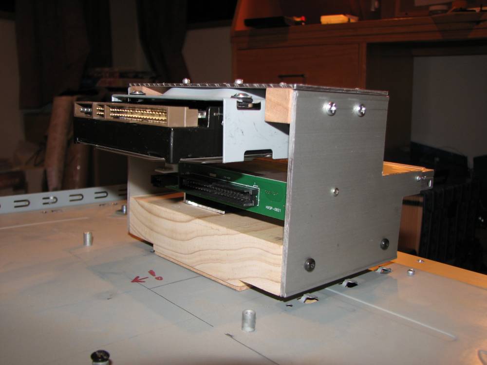

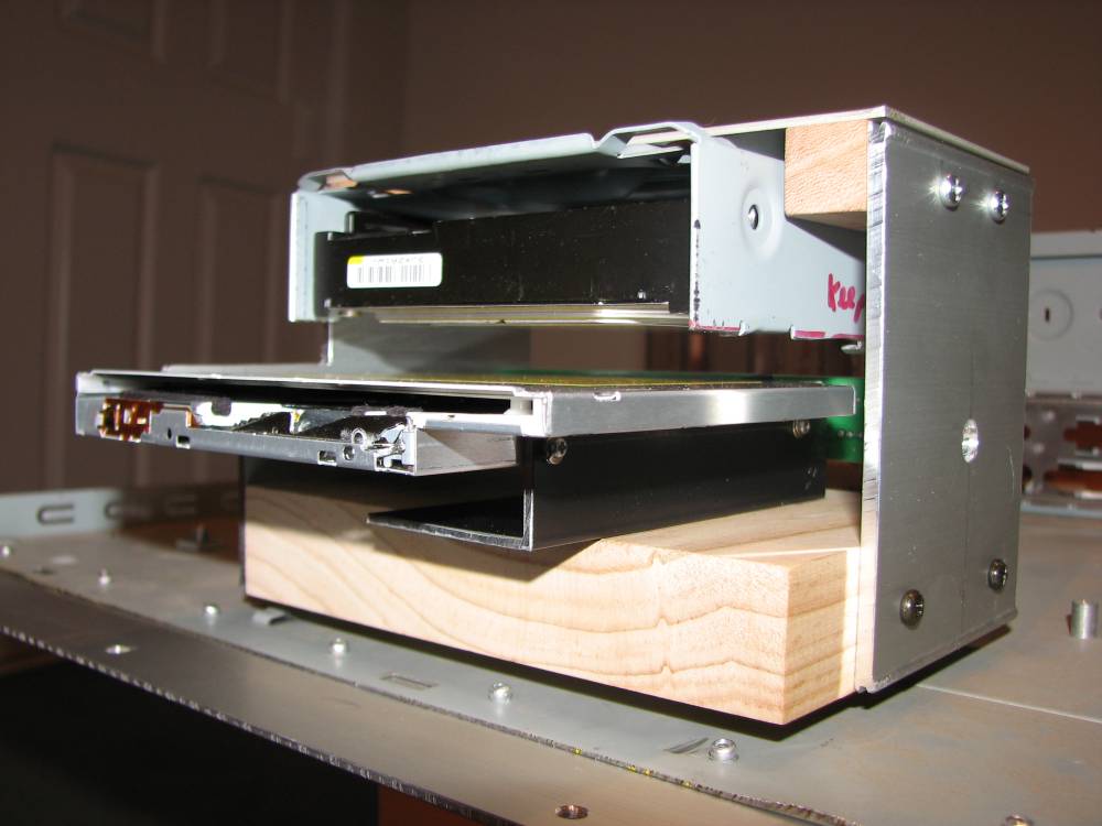

Awesome work. Did you CNC cut the timber?
Thanks. No, timber was all cut on a table saw. I got the dihedral angle through protractor feature in Google Sketchup. Then I could halve the angle to set the saw blade angle, and back screwed the piece of Elm I was working on to a rectangular piece of MDF, using a rafter square to make sure that the line I was cutting was exactly perpendicular to the saw fence (so cutting line was parallel to saw).
Most of the routing was done using a copy/tracer router that holds the workpiece with clamps and allows the user to set the 3d limits of the maneuverable router bit.
Compound angles were epoxied together with tape on the joins to hold the pieces together while glue dried.

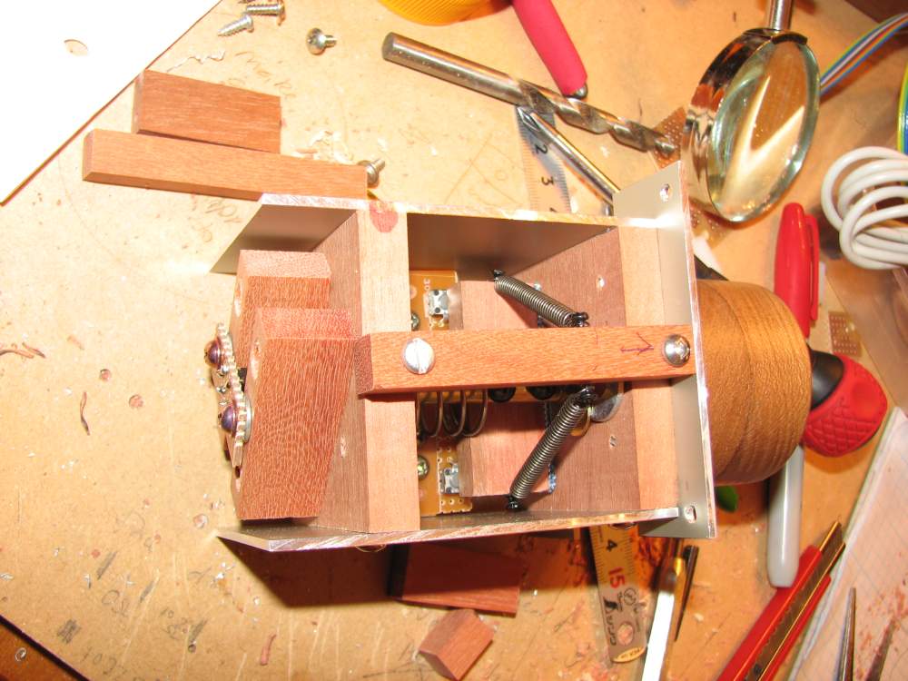

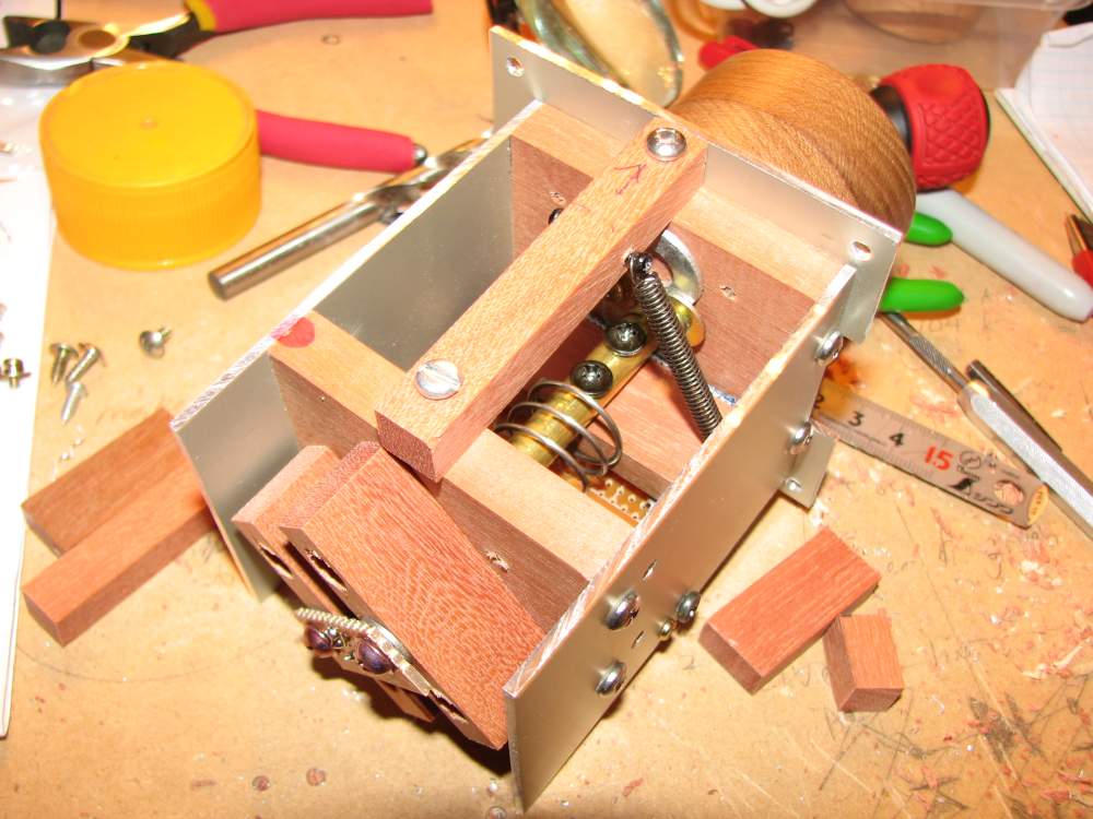

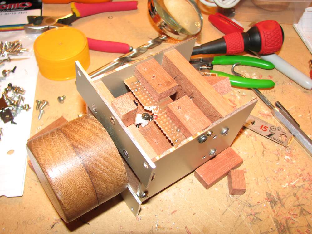

Got the left hand knob completed last night. Rather a lot of effort (and considerable tweaking to get smooth operation) to get the simple functionality of twist left (previous track), twist right (next track), and push (play/pause). But quite a fun little project within the larger project all the same.

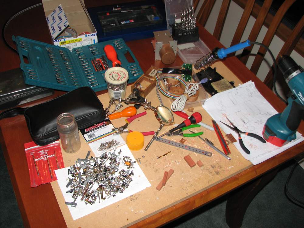

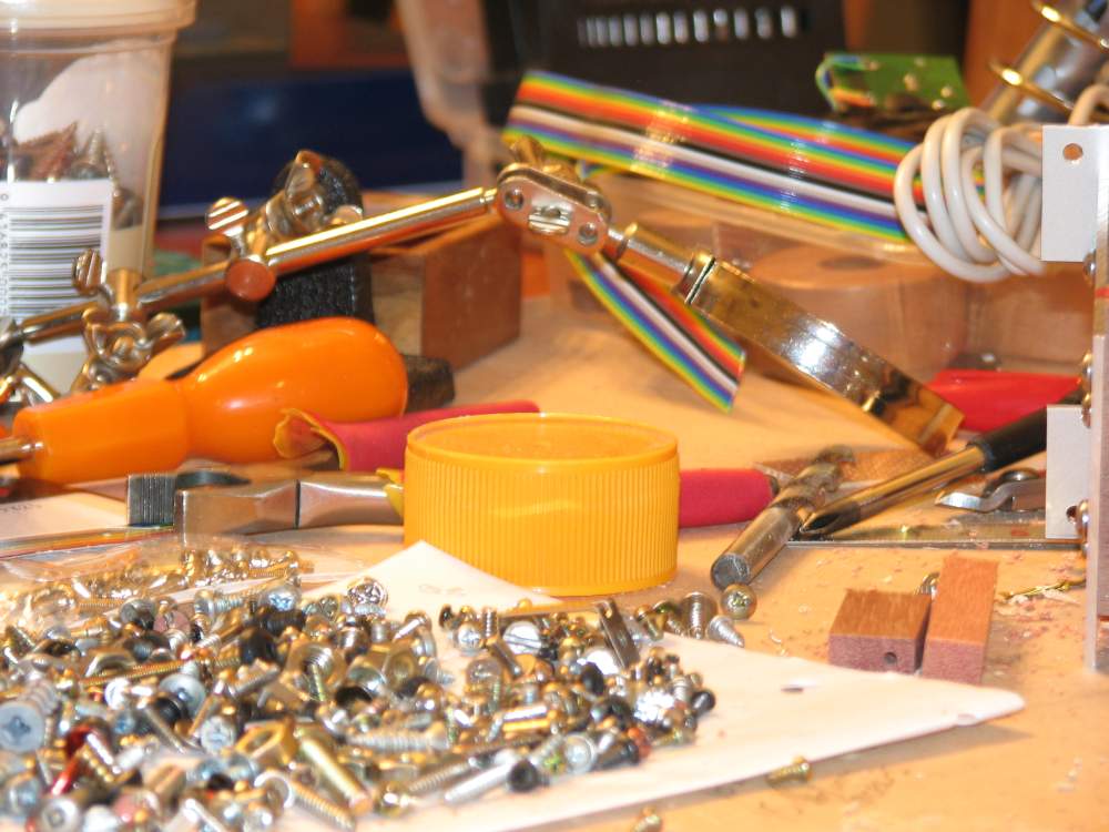

A few pics of my workspace in action, and ever handy collection of miniature screws I have accumulated over my lifetime. Something about the colorfulness of the tools and materials in this sort of hobby that appeals to me visually.
Project still chugging along...
A few more pics showing progress. Not much to go now - really just a matter of wiring everything up soon.
I'm impressed. The wooden case is slightly reminiscent of vintage radio consoles.

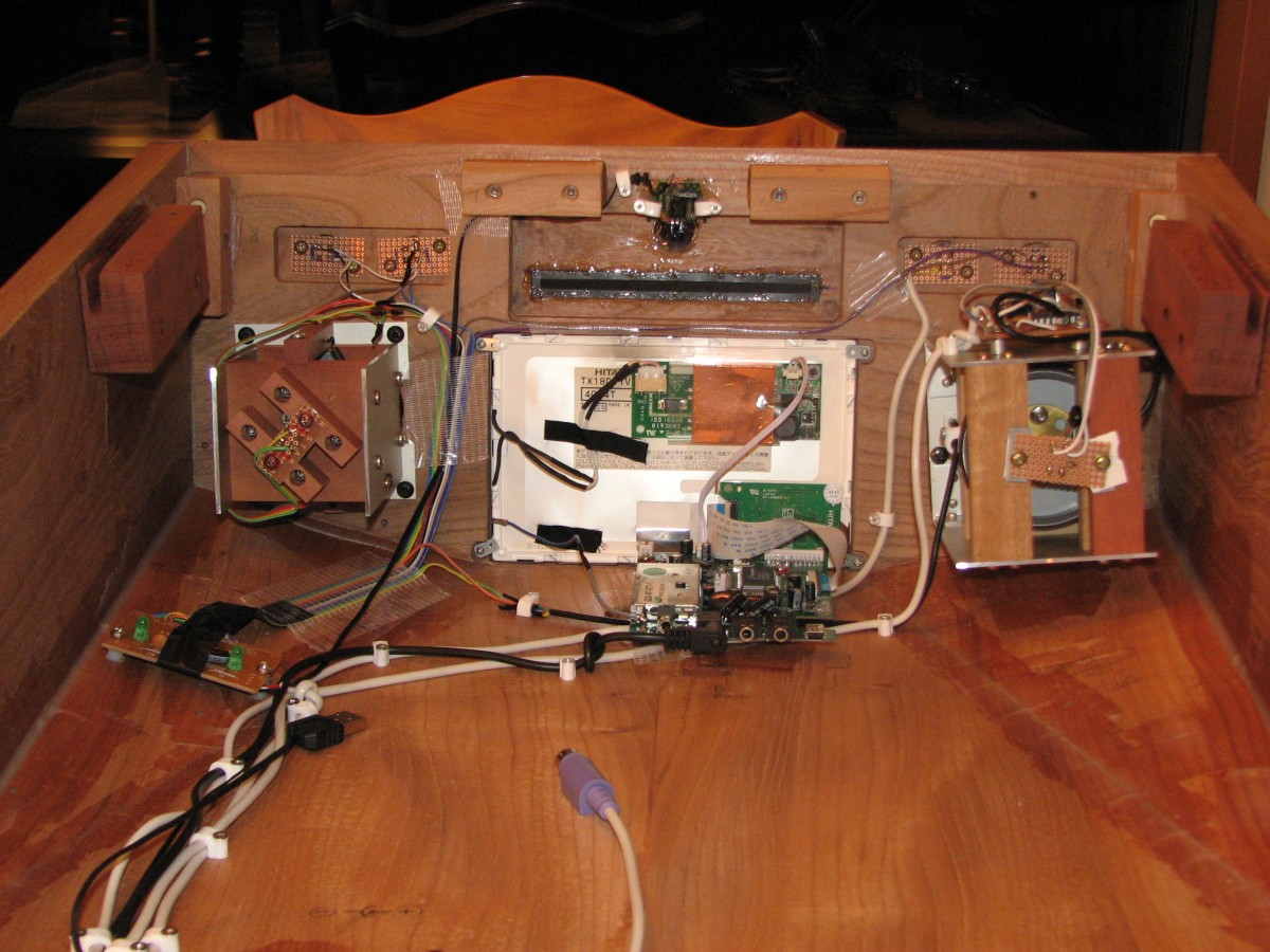

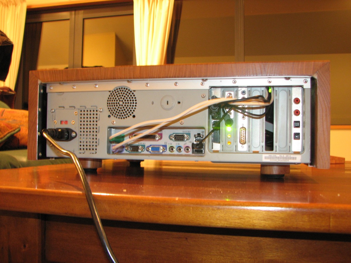

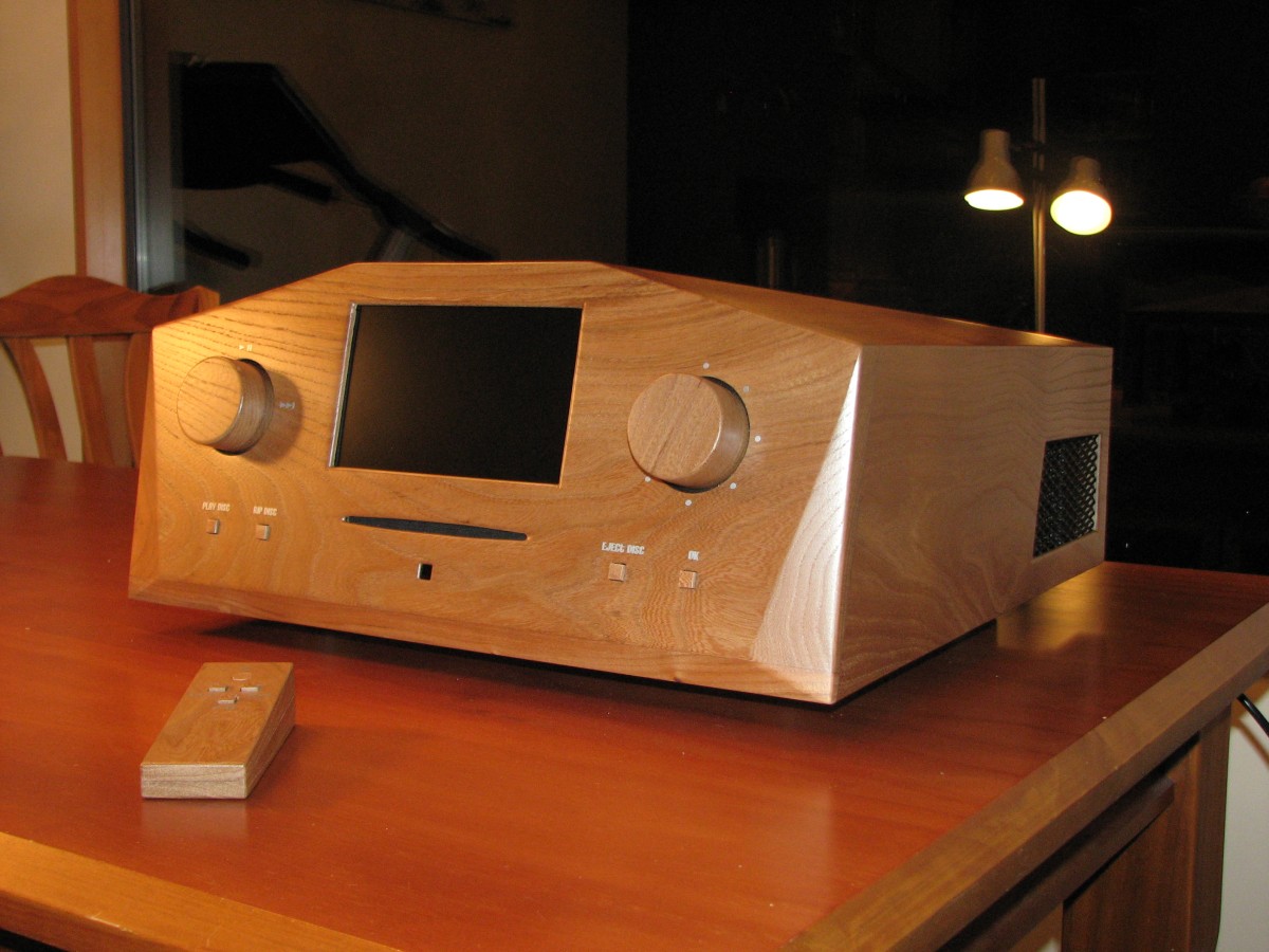

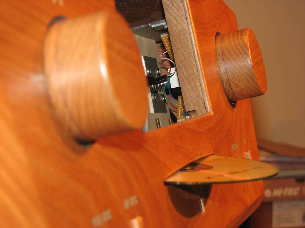

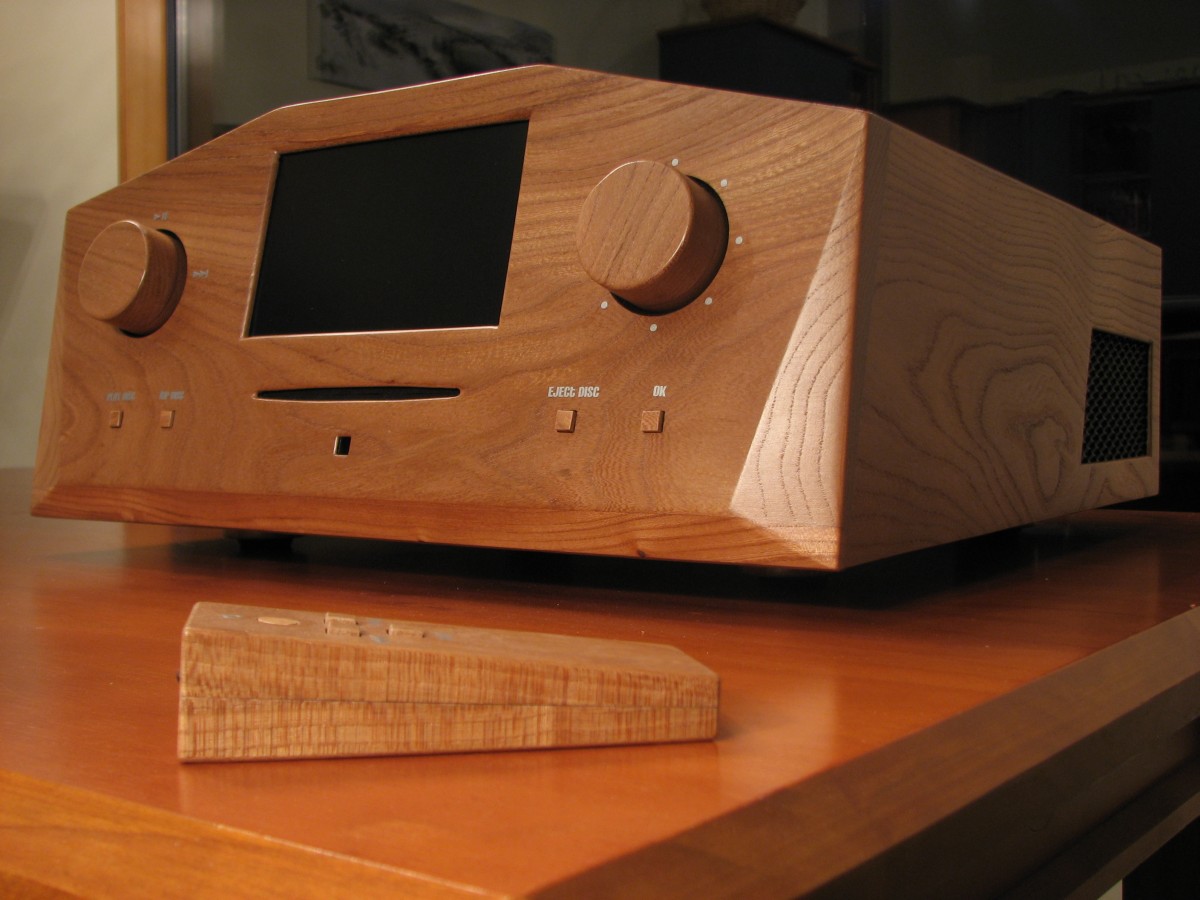

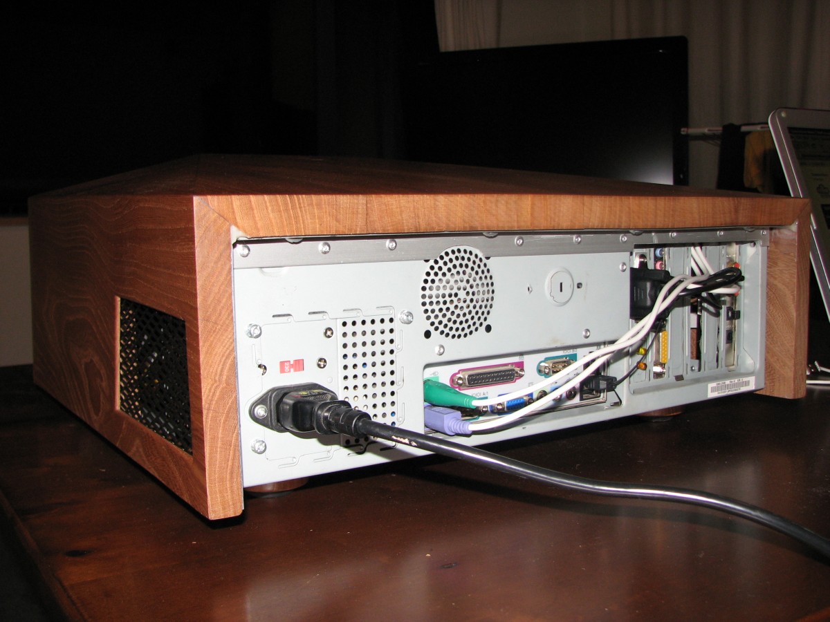

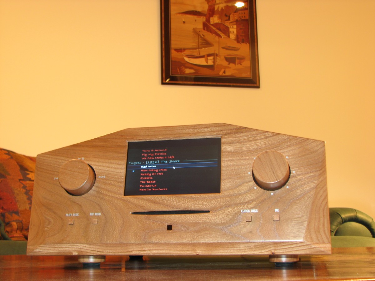

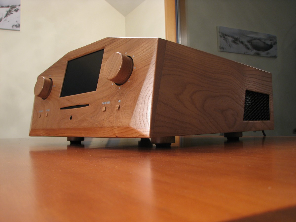

Project Complete
Finally all finished!
Got a few things back to front (wiring on keyboard PCB😱 - had to replace that as + & - were reversed) and upside down (LCD Screen🙄) on my first power up but all sorted (and replaced) now😀
Now just have to build a stereo rack to keep it on and provide space for future additions to my hifi setup...
Am expecting a Musical Fidelity Digilog DAC in the mail tomorrow that I bought second hand a few days ago online. Hoping that it is compatible with the optical out or coaxial on the soundcard I have in this project.
Foobar2000 is the audio playing software. As can be seen in the pictures, music is listed alphabetically and when a track is selected the album cover art fades in for 3 seconds before fading out again. Looks pretty smooth. Hotkeys (on front panel for ripping playing etc.)are managed by another program called AutoHotKey.
