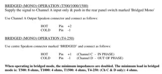

J jencelo Member Joined 2009 2025-02-05 10:43 pm #21 2025-02-05 10:43 pm #21 Sorry. Forgot to attach this. Attachments IMG_0830.jpeg 128 KB · Views: 51 MrKlinky Member Joined 2016 2025-02-06 8:48 am #22 2025-02-06 8:48 am #22 jencelo said: Would this be a correct way of connecting? I think yes but not 100% sure because I have no experience with Speakon. Click to expand... Yes, that would be perfectly acceptable. Reactions: jencelo U uncola Member Joined 2012 2025-02-06 9:00 am #23 2025-02-06 9:00 am #23 double check this, but I believe neutrik speakon 2 pole only supports up to 14 awg cable. the 4 pole you can use 12 awg. that's a good reason to use it even if you're only going to use 2 conductors in the 4 pole Reactions: jencelo MrKlinky Member Joined 2016 2025-02-06 1:42 pm #24 2025-02-06 1:42 pm #24 Neutrik NL4FXX-W-L accepts 4mm². (11AWG in old money...). Prev 1 2 First Prev 2 of 2 Go to page Go You must log in or register to reply here. Share: Facebook X (Twitter) LinkedIn Reddit Pinterest Tumblr WhatsApp Email Link
