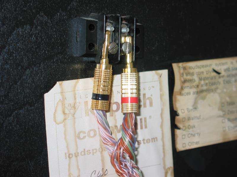

at the very least i have to change the speaker posts on the back of them as they just have the single screw-terminals.... I just spent an entire weekend building cat5 cables with BANANA posts on them....i had to unscrew the terminal screw all the way out, then fit the banana post underneath the screw.
as shown

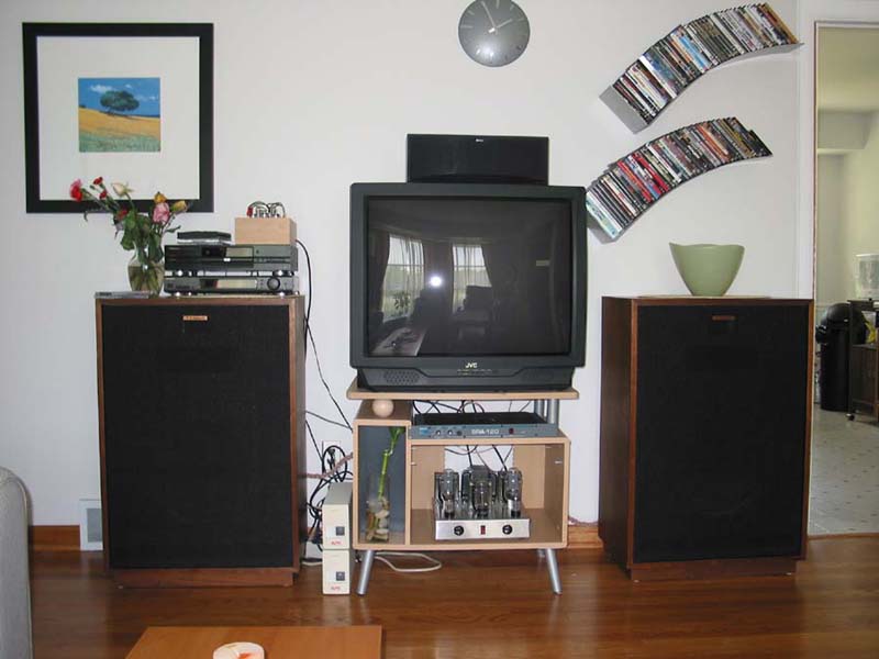

a pic of my livingroom with the B&W's out, and the Klispch Cornwalls installed.
Don't give me hell about having the CD player on top of the speaker...i'm getting a new glass stand to put all the components on, under the TV.
as shown
My suggestion for first mod would be to get the xover out of the box, they can be very microphonic. Wire or solder you speaker cables to this, then run some single strands to th MF and HF driver, and maybe a quad to the LF. The plate that holds the screw terminals on could be removed and replaced with a small peice of Al or timber drilled for the wires, and sealed with silicon. No terminal is better than even the fanciest erminal.
