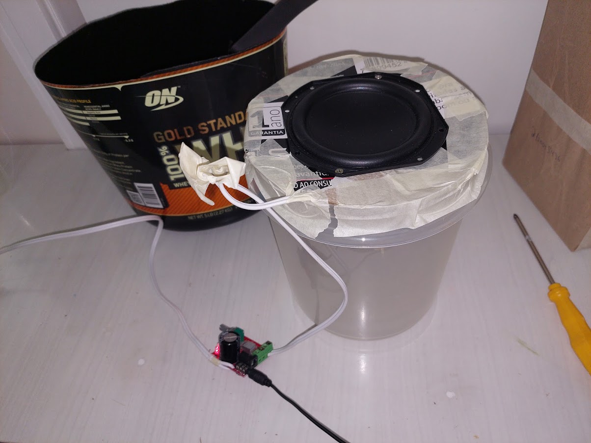

THANK YOU ALL FOR YOUR HELP!!! I built the pvc pipe speaker!!!! IT'S REALLY REALLY REALLY STRONG!!! The bass is so strong that the small glass windows of my furniture started dancing!!! And I still didnt even tune it!
Video: https://photos.app.goo.gl/pw72irKSmuHgguYZ9
I took a 1 meter long PVC tube with a 100mm diameter and attached the speaker using a 3D printed part to make the fit perfectly and I used a big rubbery o-ring to seal the connection!
Here is the picture of the ring attached to the speaker:
Here is the blue 3D printed part to make the connection very tight.
Here is everything assembled.
Pretty simple build, nothing fancy. The other side of the pipe I kept open:
I can assure you, the sound is pretty loud! I am amazed how better this was compared to the cardboard box! So far I spent no more than 30 dolars (speaker, mini amplifier and materials) and the bass is way better than my 50 dolars bluetooth speaker!
I have a few questions to you, but before that I wanna thank you so much for your kindness! You are trully amazing and creative!
1) leaving the other end of the pipe open produced the best and loudest sound. I tried closing it with a pillow, with plastic using a rubber band (picture below), I tried closing it half way... everytime I closed it, the sound would drop a lot and the bass would almost disappear. Why that? I read a lot about sealed enclosure and they should provide a better sound...
2) I spent 5 dolars to buy this tube and I afraid of cutting it and the sound getting worse... Anyway, I will git it a try and cut... but where do I cut? It has 1 meter now... should I cut it in the middle? 30cm long? The JBL BOOMBOX (which is where this is speaker belongs) is 40cm wide (I measured it in the store) but it has 2 speakers and 2 tweeeters... I intend to have only 1 speaker and 1 tweeter...
3) Some people said I should put something inside the tube to create a resistance to air inside the enclosure so this could simulate a larger box... I tried putting a nylon foam inside and the sound got a little lower and less bass... so it was not better.
4) The tweeter is supposed to arrive today. I am afraid of installing it in the other end of the pipe because everytime I closed that end with anything, the bass would go away... I am thinking about keeping that other end open... so where should I put the tweeter? maybe at the middle making a perpendicular hole?
Good work in fitting the driver to the PVC tube! 😎
You have created an open-ended pipe speaker (closed one end, open the other).
The speaker will be loud, but the bass will be boomy. The bass frequencies that will be boosted will depend on the length of the pipe.
There's a patent by P.G.A.H. Voigt on such a speaker where the driver is mounted one-third of the way along the pipe.
Now my next task is cutting this pipe... I have no idea which size...
If I've got my physics right, the pipe resonates at a fundamental frequency equal to the speed of sound divided by twice the length of the pipe.
For your 1.0 m pipe, this resonance will boost the bass at a fundamental frequency of 340 m/s divided by 2.0 m = 170 Hz (along with its harmonics).
The result is an unevenly boosted bass response that could be described as "lumpy". However, if it suits you...
If you half the length of the pipe, the fundamental frequency of resonance would double to 340 Hz - not the result you will be looking for!

If you can, do NOT cut that tube, you will lose bass.
Agree that you have a strong 170Hz peak.
Normally to be avoided but in such limited power and size projects, "anything helps"
Notice the DSP curve I showed above, it had a 12-15dB peak 😱 at some 80Hz ... you are boosting its first harmonic.
