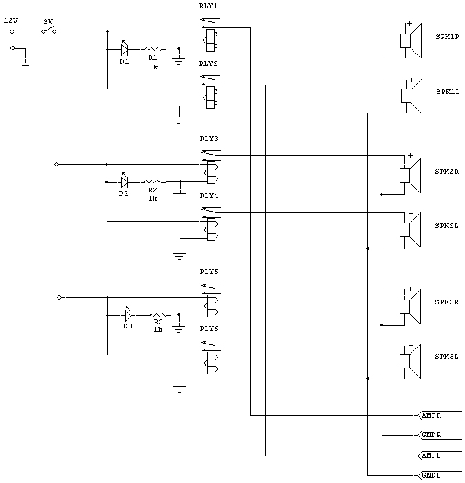

Attached is a diagram of DIY speaker selector that I'm thinking to make before the end of this year. Though only 3 pairs of speakers are drwan in the diagram right now, it will actually be 7 pairs of speakers. So far, it's a simple relay circuit. Any kind of comment would be appreciated. Thanks.

Finished prototype testing, and seems to work fine. A PCB is made for relay board. Time to drill holes on PCB, now. Small modification is a change to 6-chn from 7-chn. So far, so good.

It looks like your circuit is what's called "break before make". To cut to the chase, using this circuit will blow out your amplifier. Going from seeing infinite impedance to almost nothing will cause a feedback spike that causes the output stage to turn on to damaging levels. Its the same thing as if you shorted the output.
I hope you read this before you try it
-Joe E. Baby

Well... I haven't noticed that there was a reply. Fortunately, I haven't tried this project. Well... It would be correct to say that I haven't finished the whole project. Everything was assembled on PCBs, but not as a whole.
So, how could I avoid/reduce the feedback spikes? Does this also happen in solid state amplifiers? Could anybody let me know? Thanks.

They make switches that are called make before break, designed especially with your application in mind. You should be able to find some on the web.

You should use flyback diodes or those LEDs will eventually be zapped by the flyback pulse. I don't think break-before-make will be a problem with solid-state amps, but tube amps might not be too happy about an open output.
I've heard of solid-state amps not being very happy about break-before-make, not just with cheap ones either.
I think the circuit will work but I think you should make sure the Amp is off when changing between speakers also Diodes across the coils is a definate must.

isn't this the way all relay based delay circuits in solid state amps work 😱

The relay is not going to be hooked up the same way, unless they add a dummy load to compensate.
Old thread but something of what I need to build also. Pretty much every solid state amp I have has a speaker selector switch that disconnects the speakers completely. Plus there is the power on relay also. There is no dummy load switched in. I looked at the schematics.

As a general rule, solid-state amps don't like a short circuit, and valve amps don't like an open circuit. Each is reasonably happy with the opposite, at least for a while. Therefore a speaker switch for SS should be break before make, and for a valve amp should be make before break. Better still, don't do live switching at all.
