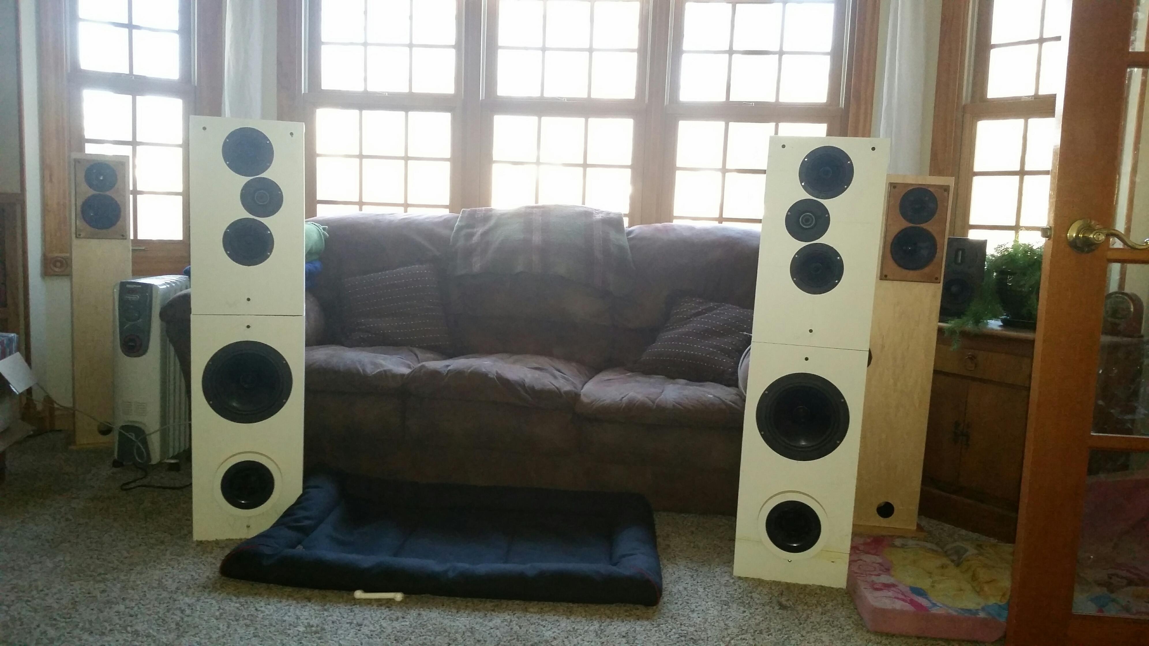

Just to answer your question about the Sunflowers; I just built a pair. I haven't done anything with veneer or finish yet. I'm very satisfied with the bass. No need for a sub. They turned out to be great sounding speakers (no surprise, Paul's a great designer!). The build wasn't exactly simple, but if you can find someone to build them for you, you won't be disappointed.
Too bad you're not closer. You could audition them and we could talk about building a pair for you.
Mike
Nice job Mike. I am impressed: a speaker builder who actually does what he says he will do. The OB bass a whole new world isn't it? Have you tried the Jolida on them?
Dave in Ft. Collins
Hi Dave. Thanks! I built them, but now I need to decide on a finish and actually do it.
I am running them with my Jolida. My Marantz didn't have enough ooomph. It would go into protection when the bass got a little heavy. Definitely not like the older Marantz equipment. The Jolida paired with these guys really sing. The open baffle definitely adds another aspect to them. If you're in town again, you should stop by so you can hear them.
