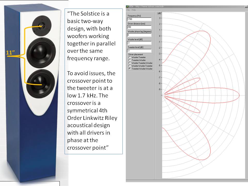

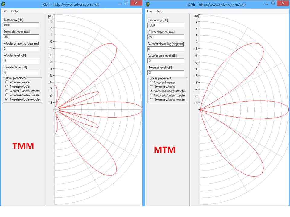

Anyone have any idea about how Jeff B´s Solstice handels ?
The Solstice is a 2-way TMM design with the crossover at 1,700Hz, which is a 8" wavelength with a 11" center-to-center between the tweeter and bottom midrange. Xdir simulations show a lobing pattern which creates concerns. The modest efficiency of the midrange favors wiring both in parallel as a 2-way TMM or MTM.
Any independent polar measurements available for the Solstice?
