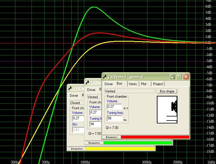

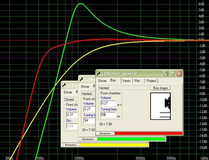

Maybe I am confusing myself, but my goal is to have these LCR to play in conjunction with a seperate sub and I am hoping to have useable range of 80 hz and above, meaning no more than 3dB down at 80hz. Using Winspeakerz I am having a hard time meeting the minimum recommended vent (port) volume) which I am assuming if I do not meet, will introduce the potential of "chuffing", or other port noise.
At an 80Hz tuned point, Winspeakerz indicates a pair of 1.5inch ports 4 inches (3.984") will have only 3.5 square inches of vent area, the minimum req. is 4.12... now assuming I am not getting into the weeds, between computer simulated best sound, and what will actually be real world results, based on the minimum vent area I'd need at least to tune the box down to 68 Hz using the 1.5inch port to have enough vent area to meet the req. size. (my prefabs are only 4"), this frequency requires a 6 inch... however moving to a larger port, say 2" seems to solve the problem of not having enough vent area for my sized box, but only if I use a pair of 2" ports which kills my design of a compact LCR speaker by having to mack room for a 2" port.... maybe a sloted port is the way to go, while not as cosmetically apealing.
Another concern in my modeling is the -6db baffle defraction loss the Winspeakerz is simulating on these drivers. Guess it's time to work on a compensation network.....

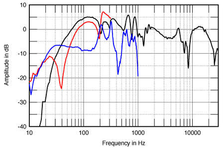

From the first bookshelf speaker I clicked on at stereophile.com :
Polk RTi A1 with a small front mounted port - not good (red trace).
Midrange output of ports can be a problem - exacerbated by
the natural pipe frequencies of the port length, though it can
be reduced by internal speaker details, still generally rear
ports are less likely to be problematic.
Careful design helps, as does of course port output measurements.
/sreten.

It is certainly not "worst case", it is the first compact bookshelf in
stereophile.com's review listings with a front mounted port that
I found, It is to a degree a random case, I've seen worse.
The measurements are nearfield (in fact red is summed front and rear
ports) but the 800/900Hz problem is with the front port. You do not
need accuracy in this level to see the problem. The problem is also
illustrated by impedance "wiggles" at the same frequencies.
It is a common issue in commercial speakers and less likely to
be a problem in said speakers if the ports are rear mounted.
/sreten.

A nearfield measurement of the port at 800-900 Hz is totally incorrect and cannot be simply summed back into the woofers measurement. If thats what was done then the whole thing is bogus.
What is bogus is saying it is meaningless.
The phenomena is there and it showed up in the impedance trace.
/sreten.

The port output is normalised by multiplying by its radiating area
to give accurate results at low frequencies for farfield. For a small
radiating port ~ 1" in diameter this will hold up to past 3kHz.
Baffle step is not taken into account, but that is a stereophile
choice, covered by Paul Messengers series of measurement
articles, which outline the methodologies and issues.
Not totally correct is not the same as totally incorrect or bogus.
Much more correct than usual is a more apt description of the plots.
/sreten.
Sort of vented (40Hz) but much worse - pseudotransmission line :
Fig.3 Meadowlark Swift, anechoic response on tweeter axis at 50",
averaged across 30 degrees horizontal window and corrected for
microphone response, with nearfield responses of the woofer (red)
and port (blue) and their complex sum, taking into account acoustic
phase and distance from the nominal farfield point (black), plotted
below 300Hz, 1kHz, and 400Hz, respectively.
