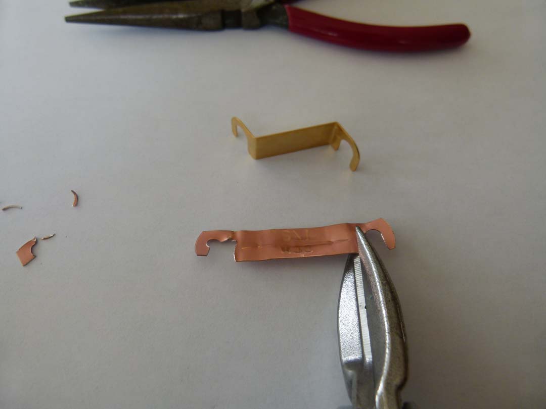

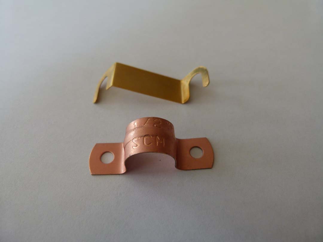

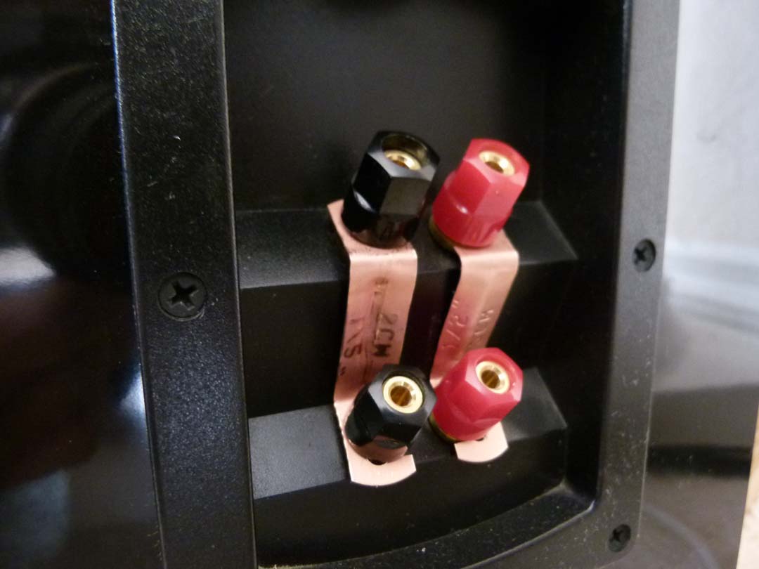

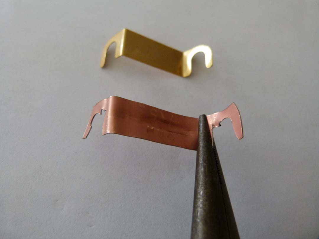

The jumpers were missing on some speakers I bought second hand. I replaced them with 1/2 inch copper pipe straps from home depot.
Flatten them out, cut the post slots, and bend them into shape. Takes about 5 minutes. A bag of 10 straps cost $1.24. So, yup, its a 12.4 cent solution.
