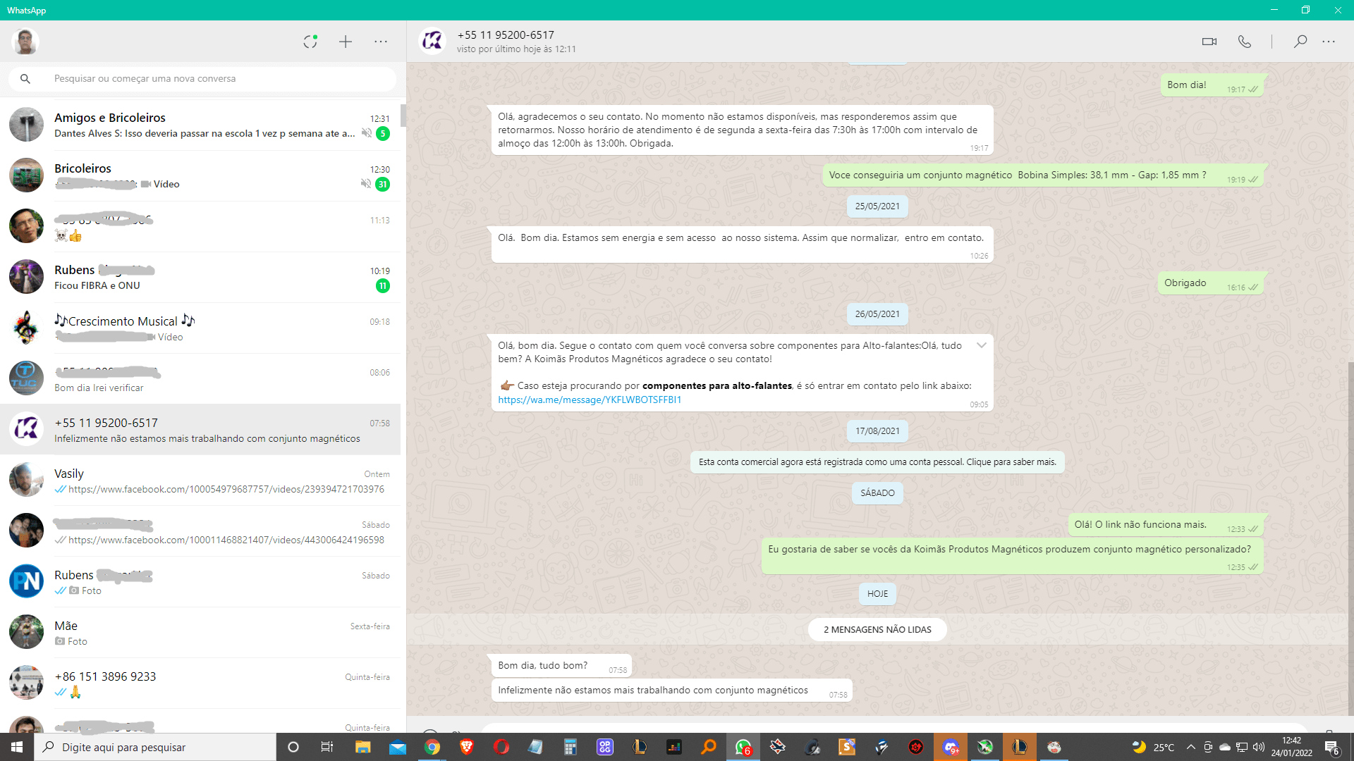

Você não foi pedante, sua presença me ajudou muito. Lembre-se, meu patrimônio é minúsculo, estou pensando em vender a casa.
You weren't pedantic, your presence helped me a lot. Remember, my equity is tiny, I'm thinking of selling the house.

Ouch!!!!!
But no big problem 😉
You still have many options, feel HAPPY that you live in a Country which PROTECTS its own Industry.
You have 2 new options:
1) have your magnetic parts made by your current supplier, glue them to the Ferrite ring you get , and have it magnetized at:
https://www.magtek.com.br/magnetizacao-e-desmagnetizacao/
remember you will need to galvanize (shiny blue tinted Zinc) iron parts.
I emphatically do NOT recommend oven cured Epoxy paint, way too thick and will rob you of valuable gap space.
2) have the full magnetic circuit turned, assembled and magnetized by:
http://www.magnetocomp.com.br/Conjuntos-Magneticos.php
Magtek also offer speaker frames, but only steel stamped ones, maybe Koimas still has cast ones?
