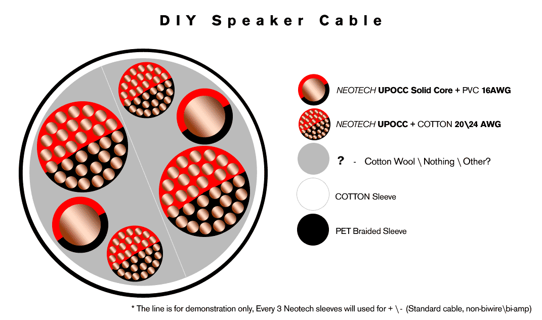

Hey,
I'm interested in building my own speaker cable, using UPOCC Neotech copper from NEOTECH - Solid Core Copper, PVC Jacket (UP-OCC Mono-Crystal design)
Here's some sketch that I designed, the total length of the cable supposed to be 2.5 meters (8 ft) = (x2 left \ right)
Questions:
1. What do you think about the isolation? is that 'allowed' to use a several isolation materials? (PVC+Cotton+PET sleeve)
2. Is that 'allowed' to use multi-stranded with solid-core?
3. What do you think about the whole thing?
I will use XLO 24K gold spades in both sides as termination (+shrink tube).
I'd love to hear your opinions.
Thanks, and sorry for my English.

I think you are wasting your time and money. That is my opinion. Except in pathological cases (including some 'high end' cables, whether DIY or expensively bought), any sound degradation introduced by a speaker cable will be entirely negligible when compared to the effects of the speaker itself. Interconnects are more important, although still relatively unimportant when compared with the electronics.
Others will disagree.

I don't like the solid coreof your neotech cable. Diffilcult to make a good crimp to industrial spade lugs. 16 ga wire is pretty wimpy for power amps over 60 watts per channel. I like surplus (from the dumpster) industrial 3SO10 or 4SO10 cable. Also sold by the reel at industrial supply houses. 10 gauge, multistrand copper extra flexible wires. Easy strip rubber insulation, rated 600 VAC. Regular industrial wire is 19 strand, not very flexible. On my Dynakit ST120 amp or CS800s amp I can hear the difference on high frequencies (bells, top octave grand piano) between 25' of 16 gauge zip cord, and 8' of 10 ga 4SO10 cable. The ST70 amp has too much harmonic distortion (1%?) for this difference to be audible. This is using the 8 ohm (5.5 minimum) SP2-XT speakers.
I've seen some speaker and power cables, there were cotton or similar stuff, but sure it was not for isolation, the purpose was filling the space to look cable round after outer jacket is weared on it.1. What do you think about the isolation? is that 'allowed' to use a several isolation materials? (PVC+Cotton+PET sleeve)
