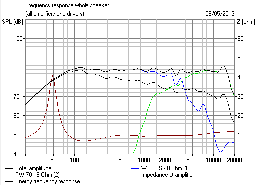

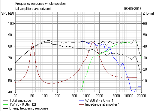

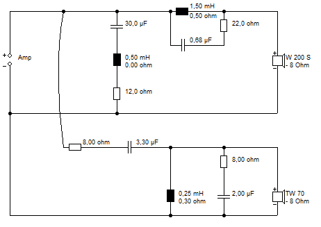

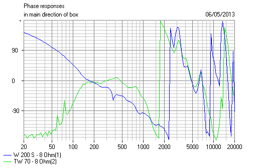

Here's a 90dB (or so) design known as the WLM La Scala which regulars know interests me greatly. A second order tweeter gives the sort of impedance we can equalise. Visaton drive units. In practise I found the efficient DT94 mylar and SC10N soft dome worked very well too on the same crossover.
It's a bitch to get phase aligned on it, which is what the RC across the bass coil is all about, but it's got some nice qualities. For SET use, I'd go for large closed box around 30 Litres or more, because reflex is really not good in that application. Then works very well as a standmounter with the impedance correction for SET, even extending the bass performance nicely.
