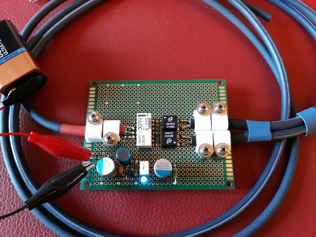

Hi, after many consultations, I think that the best way (from noise and jitter point of view) to commute a digital signal inside a DAC is through RF relays, even if are quite expensive.
In the case of SPDIF we should need a 75 ohm relay, and I found the OMRON G6Z-1F perfect, even if now obsolete.
The problem is that it only has one pole (SPDT), so it puts the grounds of the sources in common, which in my opinion is very bad.
So I used two pulse transformers, one for each source line, each terminated with 75 ohms, and only after that, I put the relay to switch the "hot" still having a common ground connection but now isolated: in this mode, grounds of the sources remain isolated from each other and from the DAC.
I have tested and it works perfectly without adding additional jitter.
Of course in order to don't jeopardize the work we need true 75 ohm cables and BNC connectors at input.
Also, as I don't want any possible induced RF noise close to the contacts, the coil is powered with a tiny voltage regulator (LE50) and RF filters. Comments if any, are welcome!

Any benefit from using a 3GHz relay has been thrown away by your construction technique: long coax tails, ordinary perfboard. Fortunately the signal is quite robust so what you have demonstrated is that an ordinary relay fed from a noisy supply would have done the job just as well. You probably could have used an ordinary switch instead.
Positive comment, how nice. It seems a prototype to me (crocodile clips and the text indicate this well) and a proof of concept, not the final design. Compared to recent designs with obvious flaws that are praised here this idea seems ok.

DF96 you are right. Jean-Paul, sorry, that it not a prototype: it will be really mounted on the (my) final machine.
But tails are the minimum to be soldered. Even if you use a PCB you have to cut coax in this way, if not the solid polyethylene dielectric melts or you make short-circuits once you move the cable.
Also, if you look carefully, I maintained the 2nd copper foil shield covering the inner conductor as much long as I could. Do you really think it is possible to have shorter shielded terminations using a PCB?
The inner conductors are soldered directly on the pulse transformer pins, at a distance of one hole, hence at 0.1 inch of spacing. The same the 75 ohm resistor. Even if you use a PCB you cannot make path shorter than this.
If you refer to the cable lengths, yes, those will be cut a lot once the board will be installed inside my DAC machine.
But be aware, if 75 ohm impedance will be maintained from the source (and all my components of the transmission line are done in this way: I will use exclusively BNC 75 ohm connectors, inner and external coax cable at 75 ohm, relay at 75 ohm, 1:1 75 ohm pulse transformer and 1% metallic 75 ohm resistor termination) the optimum total coax length is estimated to be between 2 and 5 meters (upon on internet guys experience) in order to minimise reflection's collateral effects, which you will have much more with shorter cables.
More length (>5m) is not recommendable due to losses.
Hence one feet of inner coax cable is not an issue till you maintain 75 ohm impedance matching; on the contrary it could even be beneficial in order to lower reflection's collateral effects.

I immagine everybody knows how are the spdif coax output PCB inside ther majority of commercial players: full of bridges, long traces and random grounds paths (plus one RCA 😱): I wonder how much this has an impedance of 75 ohms better than my perfboard.
May be a switch works as well, I'm sure too, since as you said, SPDIF is quite roboust, but I've just done that best I could to minimize eventual issues, losses, reflections, noise and jitter from the source to the Dac receiver board.

I think this is the best you can do given the constraint that you want to build everything on perfboard.
If someone would build the same circuit on four-layer PCB with the signal traces designed as 75 ohm microstrip lines and with PCB-mounted SMA connectors on all in- and outputs, and measure both versions with a network analyser, the PCB version would probably behave better above 1 GHz. Then again, who cares?

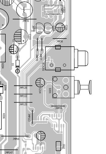

I immagine everybody knows how are the spdif coax output PCB inside ther majority of commercial players: full of bridges, long traces and random grounds paths (plus one RCA ): I wonder how much this has an impedance of 75 ohms better than my perfboard.
Yes, my main point is that you don't need to worry too much about using a 75 ohm relay. If you think this really is needed then you need to find a 75 ohm coaxial relay with BNC connectors mounted on it - this will preserve impedance but is very unlikely to switch the ground too. Alternatively, don't worry about such things and just use a normal relay (or switch) and just keep the tails reasonably short. You seem to have said that you worry about impedance etc. but then have built a design which does not preserve impedance.

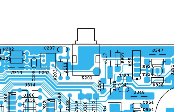

Where do you think I'm deviating from 75 ohm line impedance "much more" than anybody could do with a PCB? Is it my use of just 0.1 inch of perfbord (which is anyway sorrounded by pin soldered ground)? Again, which is the correct PCB design to preserve 75 ohm in traces?
Like the attached one (be aware this is 50 ohm OMRON A-version relay and kit)? Are we sure it preserves its impedance due to the thickness of the board and the capacitance due to the ground plane? If this is 50 ohm impedance, how would be the thickness for 75 ohm PCB?
I think that the first place where I really lost 75 ohm is just before the input cap before the SPDIF receiver (AD8611/CS8412), but the 75 ohm coax was already terminated by the 75 ohm resistor, thus I don't think to have reflections after that resistor; and in any case like anybody else (even commercial DAC) would have.

If you want to preserve impedance to high frequencies then you need to mount BNC connectors on the board and use microstrip techniques, or use a coaxial relay with BNC connectors - I'm not sure if they are available for 75R. Using a 50R relay just guarantees an impedance variation.

The pieces of wire sticking out of the coaxial cables are basically transmission lines with a much higher characteristic impedance than the 75 ohm of the cable - much higher because the capacitance to the shield is far lower than inside the cable, and the characteristic impedance is sqrt(L/C). As long as these pieces are much shorter than a quarter of a wavelength, you can treat them as lumped inductances.
Order of magnitude estimate: according to the 1 nH/mm rule of thumb, with about 5 mm of wire sticking out of the coaxial cables and another 5 mm on the ground side, you have lumped inductances of the order of 10 nH. With 75 ohm, that gives you a corner frequency just below 1.2 GHz. Hence, the matching and bandwidth are limited by the wires rather than the relays; or actually that would be the case without transformers, it is quite likely that in reality the transformers will determine the bandwidth. Still, it's fine as long as the bandwidth is more than enough for an S/PDIF signal.
The PCB you've shown shows that there is also a problem preserving impedance with a PCB. The taper from the relay to the connector can't have the correct impedance everywhere; for a given PCB thickness and dielectric constant, there is only one width that results in 75 ohm (although you can tweak it a bit with the top layer ground fill). Still, you have to make a transition to the pin width of the connector somehow.
