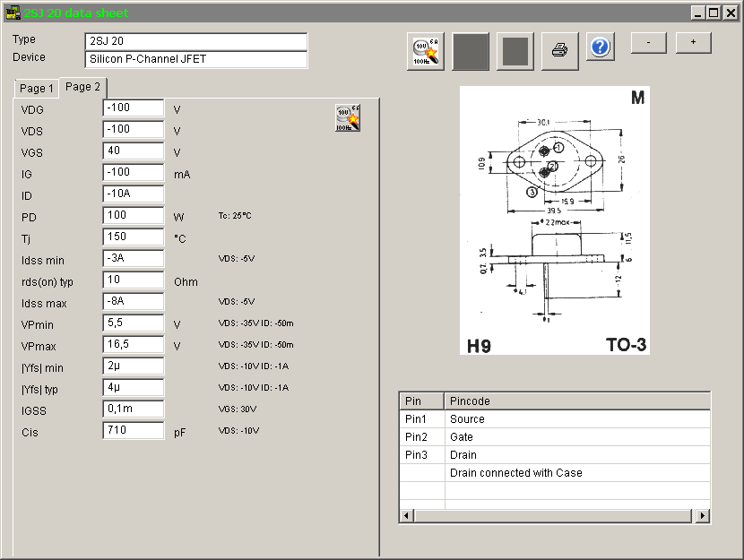

Any hope for the 2sj20 from NEC ?New boards can be optimized for 2sk82 2sj28 with change of two resistor values.

What about Yamaha 2SJ26 / 2SK76? They come in TO3 and the data is well known. I tried them and they sound promissing, but I don't know the best operation values.

at first glance, Ugs range is lower comparing to Sonys, so that would need (trivial) rearrangement of biasing voltage divider

I expect anything with a reasonable dissipation figure to work with minor adjustment.
It is, after all, just a follower.
