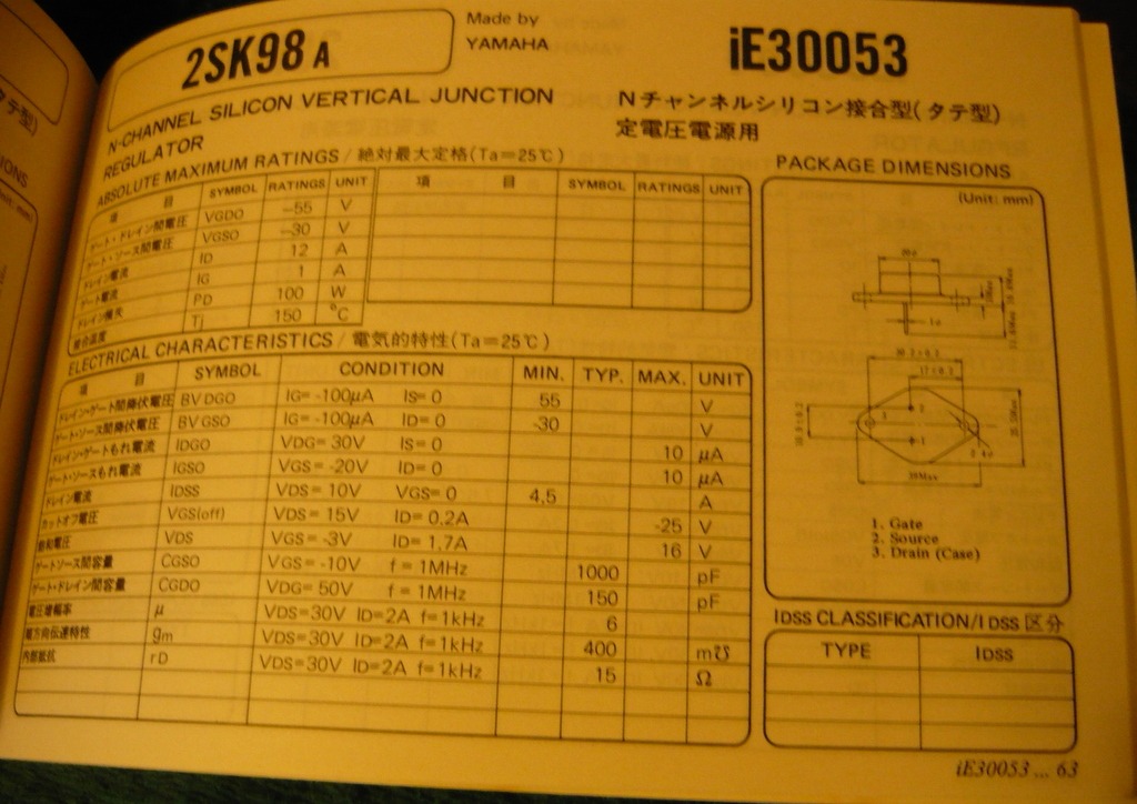

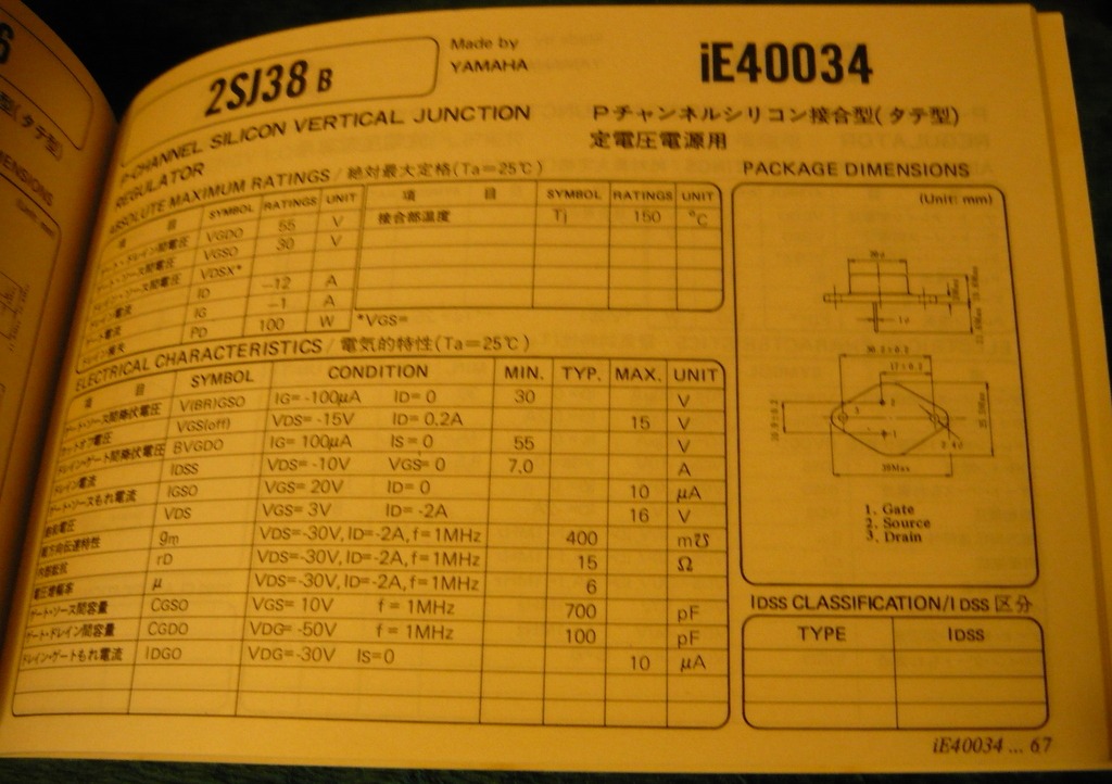

Would Yamaha 2SJ38 and 2SK98 be suitable for this project, taking into account they are lower rating parts?
