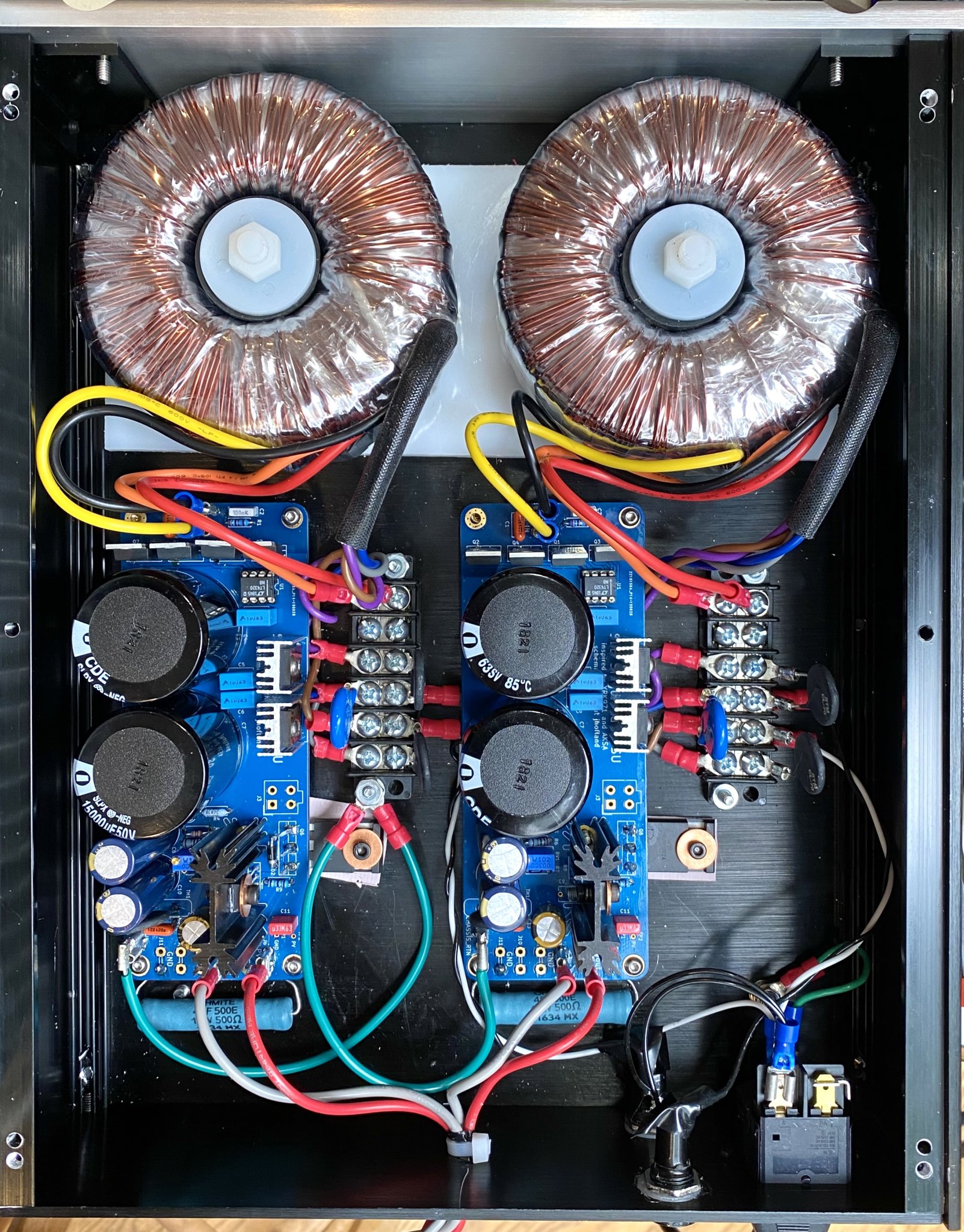

I’m thinking about making a linear power supply for my Sony VFet n-channel amp.
Wondering what approach folks have taken when making one?
Curious to see what experiences have been when adding one as far as the Amps performance changed from using a linear power supply vs using the SMPS.

If building a single supply to power both channels, I would use a 300VA 30VAC power transformer feeding a CLC filter. The CLC would be 22,000uF - Hammond 159ZJ - 22,000uF. Perhaps then add a RC stage to each channel, say 0.1R - 1,000uF. Or instead of 1,000uF electrolytic, substitute a lower capacitance motor run capacitor (film).
Yes, all my SIT amps (no diyAudio Sony VFET) have CLC power supplies. They are all mono-blocks so they do not have shared power supplies so they do not have a RC section after the CLC.
By the way the 30VAC secondary was an estimate. The final voltage may be a bit high, but a 28VAC transformer may or may not be a bit low.
I just realized that I mentioned 22,000uF for the C, but in my amps I actually used 2 x 22,000uF for each C.

Based on my own experience comparing both CLC and Cap Multiplier supplies, in the same amp... I feel that the CLC gives a more interesting and vivid presentation. The Cap Mx is a bit softer, more "polite". Both work well but I prefer the CLC..... only my opinion.

There is a whole thread devoted to building the original VFET lottery amp. The techniques for the P-type generally work for the N-type as well.
One thing to try first is adding some extra capacitance to the power rail right at each PCB. I started with 1000 uF, 50V caps at first, while other builders had good results with 2200 uF. The fact that the second version (N-type) moved to a larger filter board inside the amp justified this approach. Mark Johnson has designed a more extensive filter board for use in the N-type amp.
After I built the external linear supply, I added 30,000 uF of total capacitance to each channel inside the amp chassis. The CapMx style supply filters benefit from having bulk capacitance added to their output.
Each stage of modification had the effect of noticeably improving bass response and definition. There was also improvement in overall depth, separation and detail throughout the midrange. My impression of the DIY VFET amp is that it performs well above its weight class once more attention is paid to giving it an excellent power supply.
