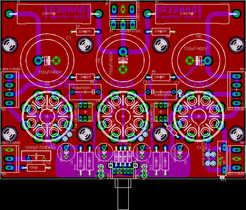

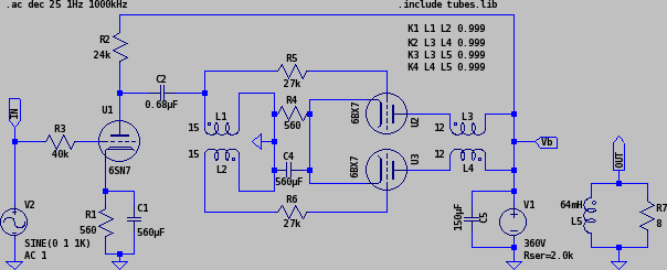

I designed a small 6SN7-6BX7 push-pull amp using commodity parts - see schematics. Three tubes, single PCB construction, solid state HT rectifier, toroidal output transformers. Not as compact as iMPAMP, but a little bit beefier at 5W/channel.

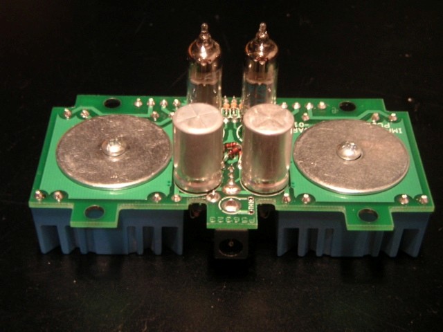

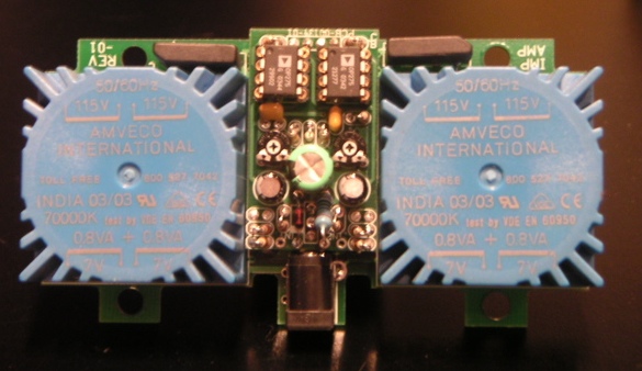

I've taken a look at the iMPAMP web page - it's a cute design. Here is my reverse-engineering summary:
Amplifier topology is a single stage push-pull using 6021W sub-mini tube. That tube has 0.7W anode dissipation rating, which means that it runs in Class B to get 1W output. Bias for PP pair is done with a single blue LED. External 12V/1A PSU feeds two 6021 heaters in series, and HT is stepped up inside by a pair of AMVECO 70000K 1.6W toroids connected in reverse. Rectifier is obviously solid state. The only thing which is not quite clear is how phase splitting is done in a front-end...

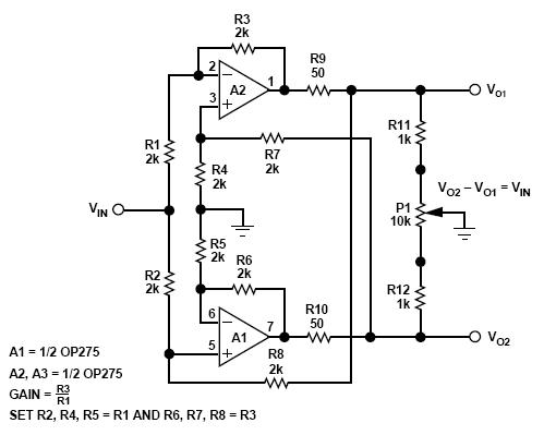

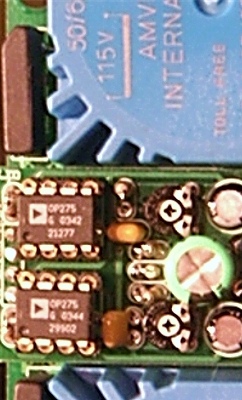

Here what I found to complete the reverse-engineering of the ImpAmp:
Two OP275 phase-splitter like this circuit (see pic)
(Personnaly I prefered the DRV134 for phase splitting)

Yeap !
OPA1632 is a good candidate for balanced input too.
Z.Vex choose OP275 for his tiny amp !!!
Look this picture that I found on Zvex forum - september 2005 (increased and corrected with photoshop)
Who says reverse-engineering ? ;)

Your 6SN7-6BX7 push-pull amp design in this thread is really cool !
a tiny Tamura MET-09 in autoformer mode at input !Y!E!A!H!
Could you suggest me a turn ratio for the toroidal output transformer ?
I have some Amveco 62070 in my parts bin but I don't have an inductance meter to mesure it for ~ 64mH ?
I want to test and listen this great idea. :)
Thanks! Now I'll have to build this thing to see if it works :).
Actually, I designed for Amveco 62070 (parallel secondaries) as output transformer. I measured one with LCR meter, and the measured values looked really good. Leakage inductance is small, so high frequency extension is not going to be a problem, which was a concern since it is never documented for power transformers (you could guess the primary inductance from idle current spec). I can look up the exact numbers if you are interested.
Hi Andrei,
I've some 7v + 7v toroid from Amveco to try with your design.
If the primary impedance will be the ratio squared x the secondary impedance.
Ratio: 115 / 7 = 16.5
Primary impedance: 16.5 x 16.5 x 8 = 2178 ohm (seem to be OK with this low Rp TV triode)
Next I've to found some 6BX7GT and I'll be ready to test it...
