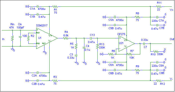

HI,
I'm looking for a good phono RIAA circuit for my MM-pickup.
Found a project at www.tnt.audio.com called "the Solidphono".
The SSM2017 is absolute, so I'm using the SSM2019 instead. Can't get it working - it's all noise and distortions at the input.
Is there a mistake in the drawing of the input connections and groundingscheme? It looks strange to me that on of the differiential inputs(-) is connected to ground...(?)
Anyone who has built this circuit? Ane comment in general?
Best,
Peter
