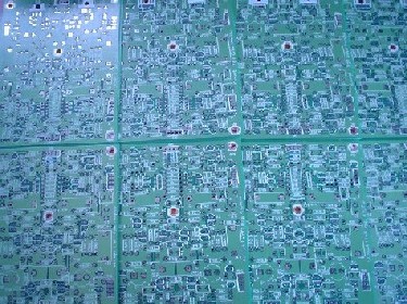

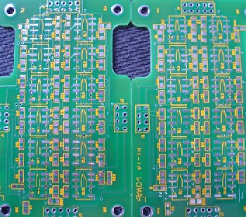

Fully balanced, left and right channel.
Discrete Class A opamps, input opamps below and output opamps on the top of the pic.
JFET/ BJT/MOSFET devices.
Don't, it is over the top.
Its predecessor employed 16 transistors and LED current sources in each opamp board.
In the 2nd ed., the LEDs have been exchanged by BJT current sources, more than doubling the number of Q's.
Advantage is that this pre-amp design will drive anything on this planet, and with an OL bandwidth that is above 20KHz.
In professional terms a dinosaur/dinausor indeed, such a design has likely become way too expensive for serial manufacture, unless it's a limited edition with JC engraving.
These boards will go in a milled case similar to that of the CTC.

Well, Jacco Vermeulen has one answer for this.
Wooow, posting with real PCB ... Nice Job JC
