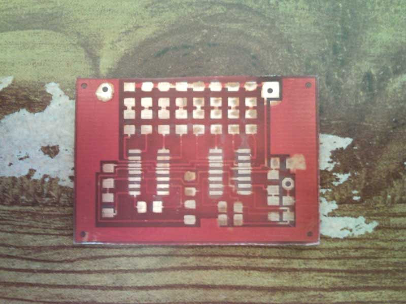

I have found out that Pebeo Vitrea can be easily masked with the toner transfer method.
Masking:
Painting:
Removing the mask after cooking:
Basically it works as a solder mask (doesn't burn away), but I can solder it through if I really-really push the soldering iron into it. Have you also experienced this, or was it only me who didn't bake it enough? (I didn't have a thermometer to measure the temperature with)
Re: masking
You just need to bake it at 180C, then it will won't melt later, unless you do something real unfortunate.

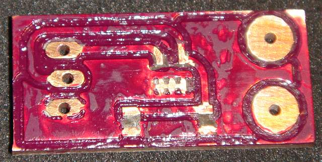

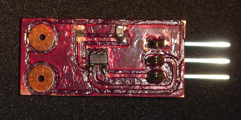

I had some Techniks Press-N-Peel blue that I tried to use as a mask for the pads before painting with the Vitrea. Was taking too long and the results were poor so I just went at it with a narrow brush and a shaky hand 🙂 It bakes up well but the uneven blobs of paint bothered me so I tried to sand them down a bit. Don't do this 🙂 It dulls the gloss and makes it look awful. I think I'll mill another circuit and try the PNP blue again.

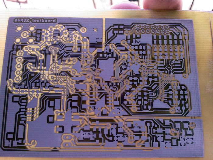

I'm using cheap shiny paper and a simple laminator for the toner transfer. It's possible to achieve a stable 6 mil resolution this way, like in the image I have attached. I think in your case the uneven blobs appeared because you didn't let the paint dry for long enough before baking it (it requires 24 hours).

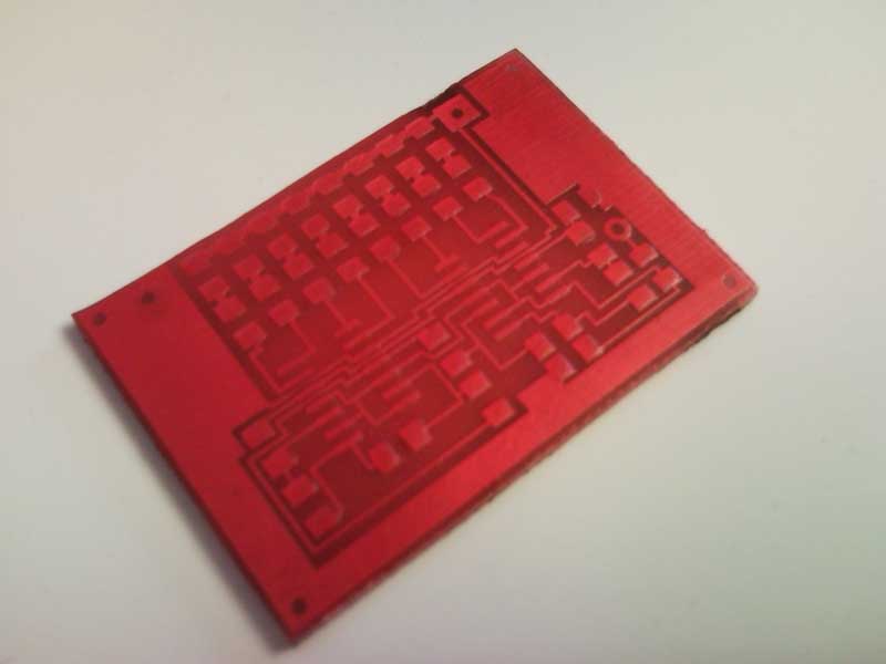

I'm wondering if maybe I didn't have it hot enough. I used a toaster oven to bake this experimental board. I used a glue pen to apply glue to the pads I wanted masked and then I airbrushed the paint onto the board. I tried to clean the glue I used to mask my pads with some Goof Off and it softened up the Vitrea. 🙁 Now it's still soft and I can practically scratch it off with my fingernail.

I think the glue caused the problem. With toner it worked very well. The pads became a little bumpy after baking, and it was easy to remove them. I baked the board again after the acetone treatment.

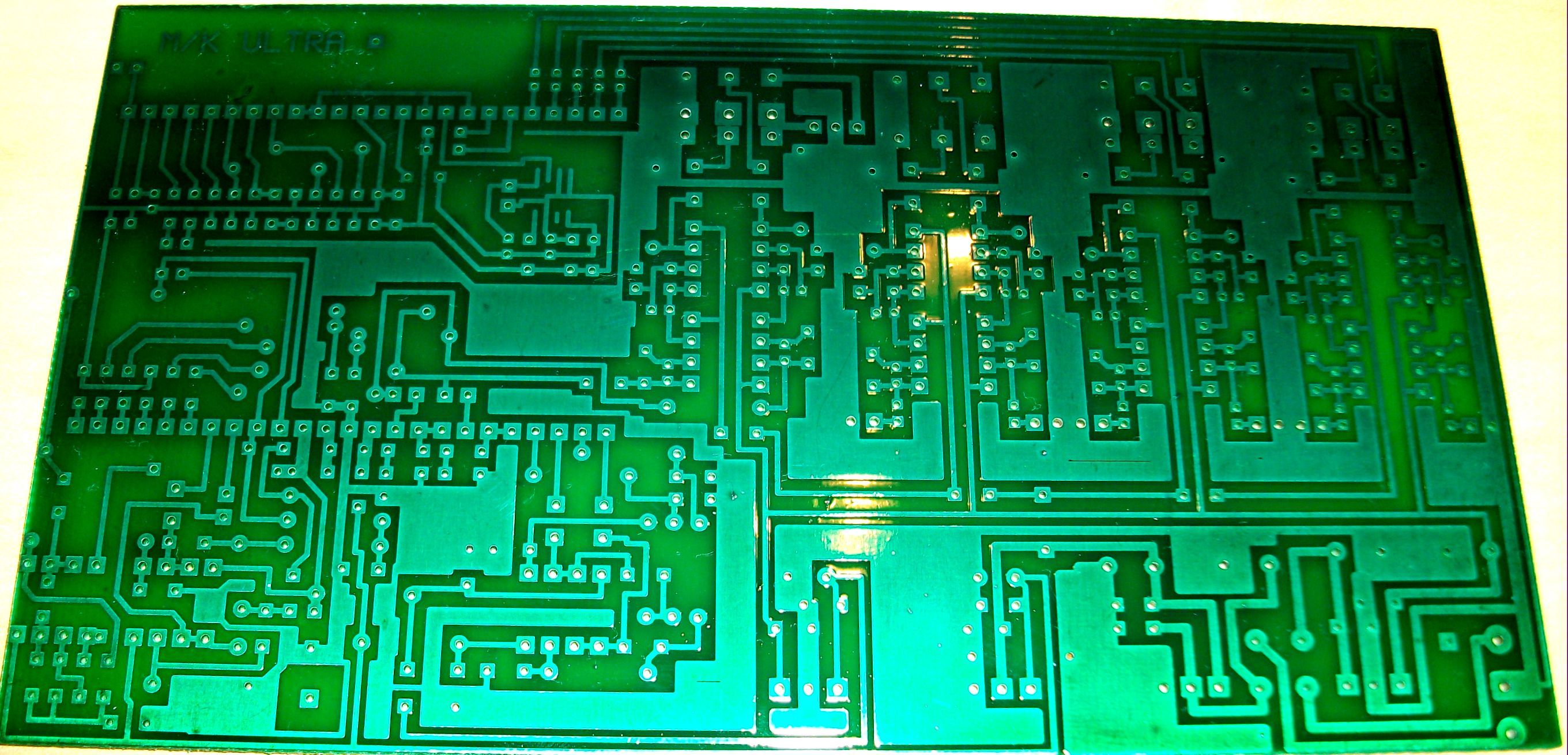

Personally, i tried a German product, with good results.
After treating the copper with liquid tin, i sprayed the entire pcb with this lacquer, without worrying about the pads, this product is solderable!
