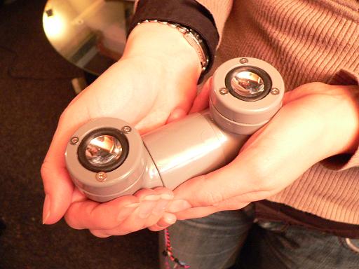

I'm using Monacor SPH-30X, great little gems they are really. Really modern, light (150grms!!) and durable materials, magnetic shielding. They have sensational sensitivity too (at least 87db which is ultra for a 3"). But they sound best with a slight notchfilter IMO...
My macaroni seems to produce real bass (you can feel it in your stomach from a few meters distance!) Most people are really impressed, even some hifi fanatics....
I used rainpipe PVC, it's cheaper and thinner thus lighter. I never planned it to sound really good, the drivers really are way overqualified...
I had to cut the basket to become round to fit in the PVC pipe, than I used silicone glue to mount it and seal it off AND make it waterproof! It has been playing in the rain several times without any problem.....🙂
I designed it to fit on a bike of a friend of mine, but it seemed very suitable for lots of other applications, By now I have built eight of them....

I have two Hi Vi A2s, that I rounded the baskets on.
We're working along similar lines. I really admired your first tiny amp32 in the diamond plate enclosure. The small size compared to the power of that amp sure changes what is possible.
That Monacor looks like a winner. Too bad they are hard to get here.

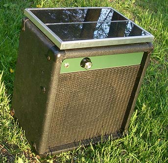

Love the solar powered music systems. One way to get a good sound quality and more output would be to use a Lowther drive unit as these are 102dB per W. However they are very expensive. The SET guys tend to use them as you can get alot of sound from a very inefficient amplifer. (cost about $800 but they do sound good)
Or for a lot less money you could use a guitar amp speaker - they are big but really efficient. For example Celestion do a 12inch that is 98dB efficient across most of the audio range with a lift round 4-5K to over 100dB. (The seventy 80) Ok there is no treble to speak of but most tweeters are efficient so it shouldn't be to hard to make a 98dB full range. Put it in a guitar box and you could mount the solar panels, a high efficiency amp and a small lead acid in the box. (cost of drive unit about $40). Power free busking amp and MP3 player.

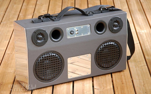

Here's a nice amp6 ghettoblaster project-
http://metku.net/index.html?path=mods/ghettoblaster/index_eng
That's a cool looking boombox. Nice finish. I suspect, I know where these people got some of their inspiration. 😉
My Solar Powered Boombox has been featured on Discovery's Planet Green website. See #3-
http://planetgreen.discovery.com/tech-transport/solar-projects-weekend.html
