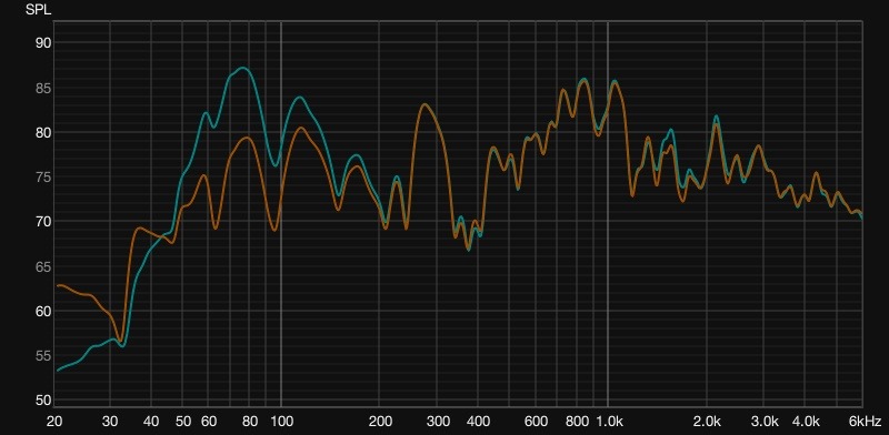

I just did some quick measurements with my prototype box (ported 4.8 liter tuned to 60 Hz). The mic was placed about where the main listening position would be. The speaker was placed on a speaker stand flush against the wall, The two graphs are port open vs port plugged. The "sealed" box measures a bit flatter as expected.
You could still argue that you spare the driver of some work if used in a ported enclosure EQ'ed down. I just don't know if the tradeoff is worth it compared to the cleaner sound and smaller box of a sealed enclosure. Thoughts on this?

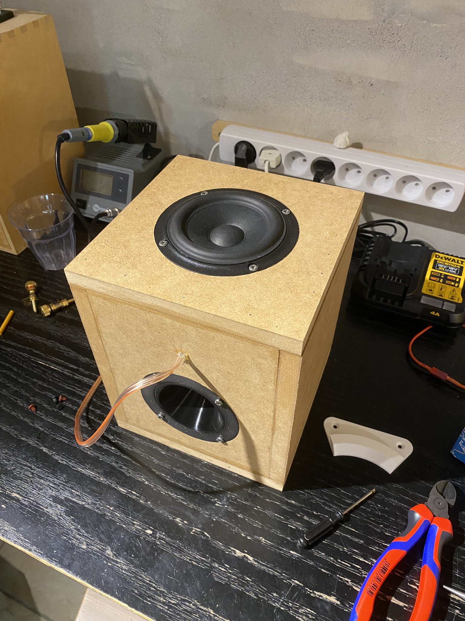

Mind sharing pictures of your build? Just curious 🙂True, but even with subs he needs some bass output from satelites about 1 octave below crossoverpoint. At least in theory.

Most hometheaters are setup with bassmanagement in place. That sub of yours should be good for quite a bit higher than 60 hz. What are you using to EQ everything?I just did some quick measurements with my prototype box (ported 4.8 liter tuned to 60 Hz). The mic was placed about where the main listening position would be. The speaker was placed on a speaker stand flush against the wall, The two graphs are port open vs port plugged. The "sealed" box measures a bit flatter as expected.

Note that the boominess of the port comes from its resonance and is fake/free bass whereas the wall boost is very real and occurs due to the wall preventing diffraction of sound around the speaker. One might think of it being similar to a large horn with a coverage angle of exactly 180* (flat horn).I hear many people use the word "boomy" bass. What exactly does this mean? Is it just a word for too much bass? If so, wouldn't it be more beneficial to make use of the bass extension that a bass reflex provides, now that space isn't a limiting factor, and just EQ the bass down and gain some extra headroom as @newvirus2008 pointed out?
Changing to sealed would still get you the wall boost (and headroom gain) and since the sealed box usually gives a tighter bass there's nothing to worry.
The sealed box also keeps the excursion under control as the subwoofer takes over and the natural roll-off is second order (vs fourth for the bass reflex).

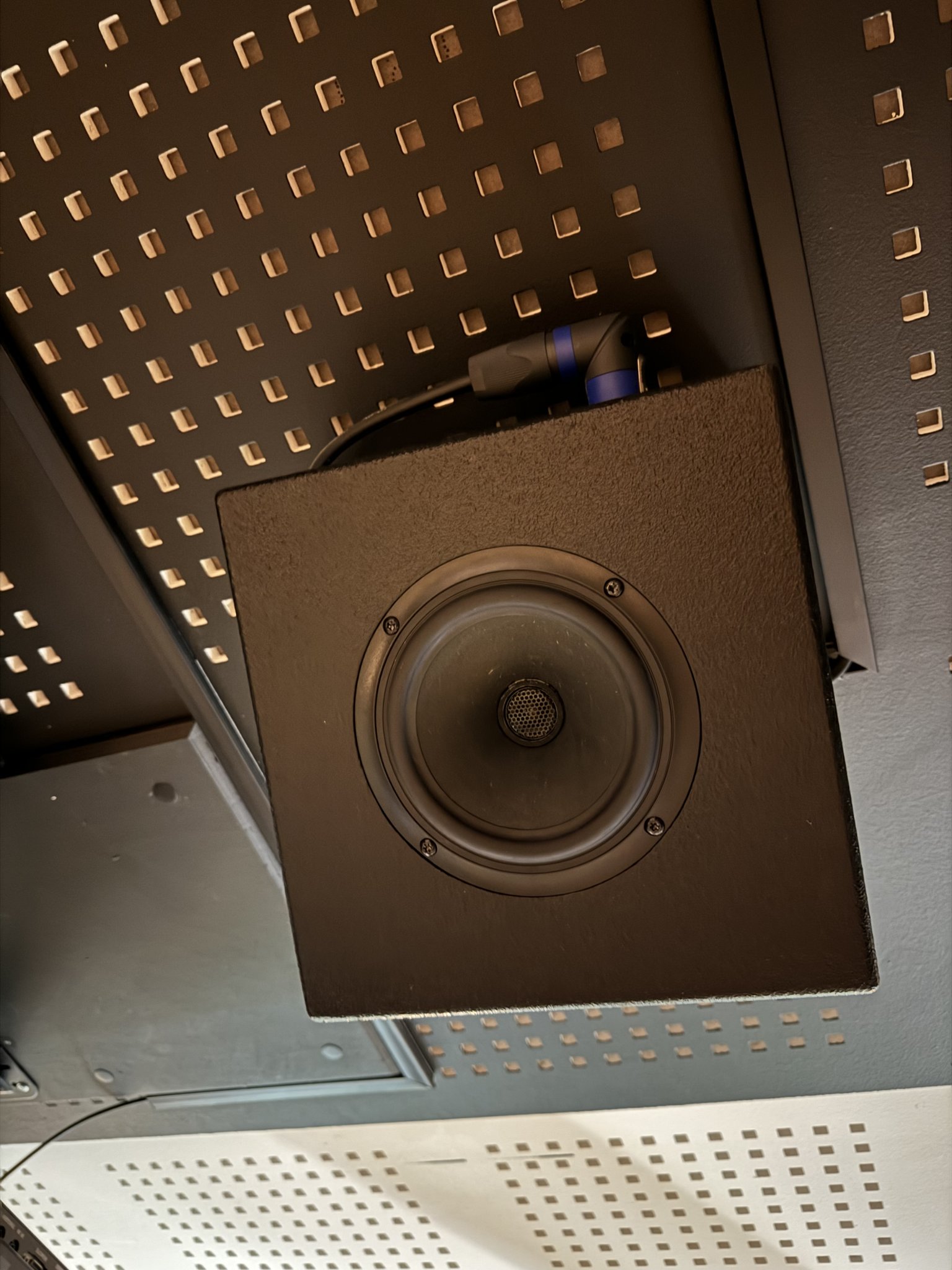

The speakers look great!
Well, I expected exactly that. And having the peaks 5-7dB lower is more than 'a bit flatter', I'd say.
Just keep in mind, if you use BR, you'll need a high pass anyway because below the fb the cone swings free and with getting the full range, the voice coil will hit the back pole plate on a deep impulse.
