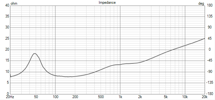

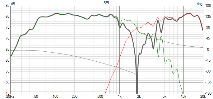

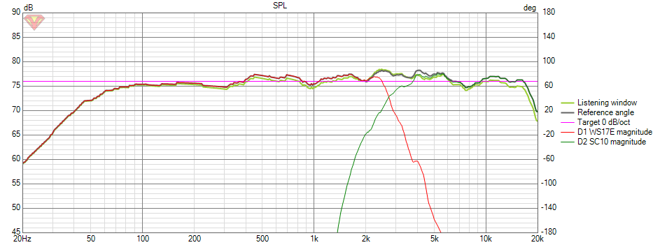

I'm using VituixCAD. The amplitude and impedance response curves were obtained using FDGraphTracer from the speaker specsheets provided by Visaton. I started by recreating the network presented for CLOU, but the resulting crossover was far from satisfactory.

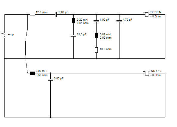

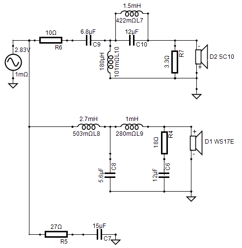

CLOU original cross-over network
CLOU resulting SPL response
I went back and forth with FDGraphTracer multiple times, double-checking the value and placement of the components to ensure it wasn't an error. So, I made the decision to design it from scratch.
I began by adding a source-side resistor to compensate for the sensitivity difference between the two transducers.
It quickly became evident that a first-order filter would not be sufficient for either of the transducers.

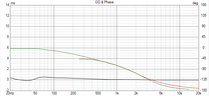

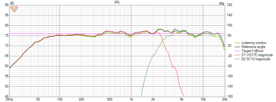

To my surprise, a second-order high-pass and low-pass filter was enough to achieve what appears to be an acceptable response. You'll notice that I had to reverse the polarity of the tweeter to achieve this result.
The Total SPL graph shows a curve of ±3dB between 60 Hz and 17000 Hz (78.2dB ~ 81.7dB).
Project cross-over network
Project Total SPL, separate SPL and Normal Phase

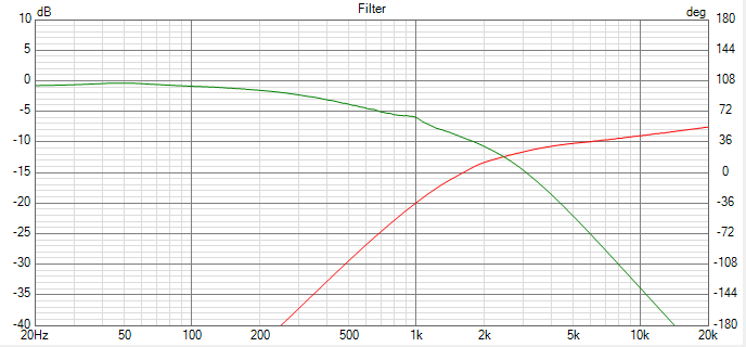

Project transfer functions
Project group delay and separate phase
Project load impedance
Project null reverse with tweeter polarity switched

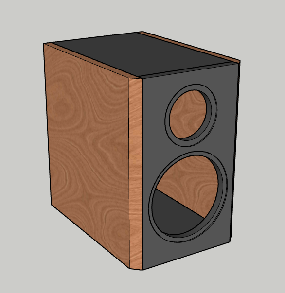

The original CLOU design is a tower speaker with two woofers. One woofer is placed in a sealed box near the tweeter, while the other is separated in a larger box that serves as the base of the speaker. This larger box, below the sealed one, has a hole near the base. I'm unsure if it's a simple hole, a port location, or a cutout for the terminal.
My design eliminates the lower portion, including one of the woofers, and only retains the sealed box. Using 16mm panels, the same as CLOU, the external dimensions are 220mm W x 331mm H x 320mm D, with an approximate volume of 16100cm³, excluding the space occupied by the speakers, shelf bracing, and other components.
An absorbing material will also be added. I will determine the quantity during actual measurements.

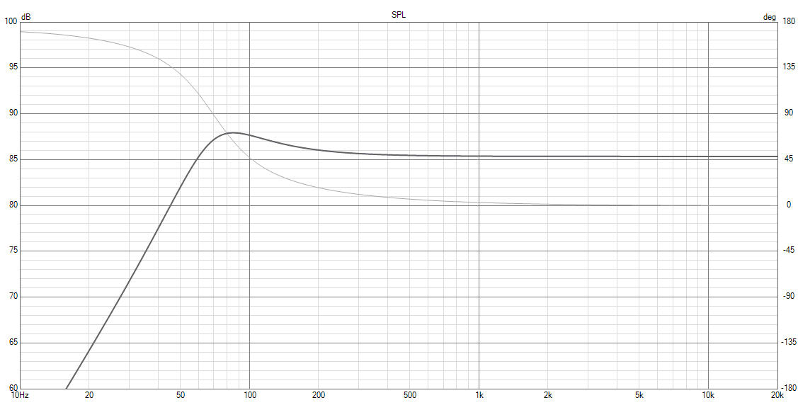

VituixCAD's enclosure design tool calculates, for a box of this volume and this woofer, a curve with a resonance of +2.5dB at 80 Hz.
SketchUp preview of the box
Box projected response

- I'm concerned about the load impedance curve. Should I incorporate an impedance corrector into the network?

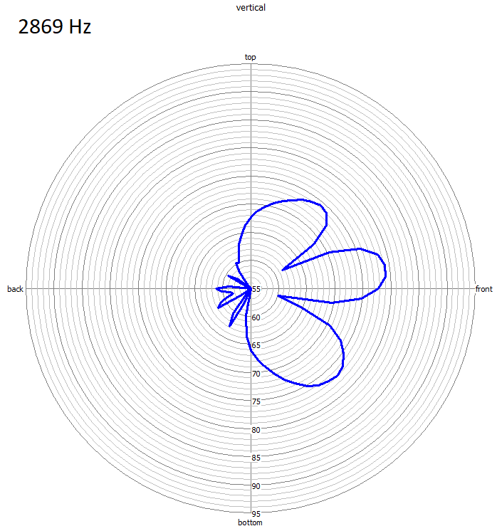

Have to agree you have some nice looking data, and your bulleted points are good questions. If Visaton has already done the hard work and provided anechoic data it would be vey sensible to use it. If you have done this in VituixCad, you will be able to use Boxsim quickly. I do not know if you could transfer the data from Boxsim to Vituixcad as text files or other file type?
Using Boxsim will probably help answer your questions. Although 2.7mH may have already done a lot to aid your baffle step. You would need to check the wording related to the measurement source you use i.e. mounted in a box or on an i.e.c. baffles.
Accounting for offset between the two drivers and reflections from box edges will change the response and phase. it would be sensible to include those aspects technically and from a learning perspective.
Yes, see what impedance correction does. But the current shape may not be typical but probably wouldn't worry a well designed amp, i guess it could subtlety modify the frequency response from a a transformer coupled device or mean less power could be delivered from a 4 ohm optimised device.
Woofer works well in sealed enclosure.
And what Visaton does as well.
The rear hole shown is for terminal cup.
It is fun learning experience.
And should be good nearfield monitor.

You can see they use notch in tweeter highpass
Which creates a sharper filter cutoff closer to 4th order.
Steep filter being good practice for tweeter.
Lower SPL simple second order can work and sum.
For higher power and to reduce tweeter distortion.
3rd or even 4th order can be used.

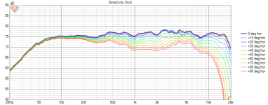

The baffle diffraction and response is simulated in full space.
So the network design can compensate for baffle step.

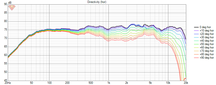

You will also be able to sim dispersion and directivity to
however many degrees you sim too. According
to Sd of the drivers. Rather easy to collect data
up to full 90 degrees. And have accurate
power response even in simulation

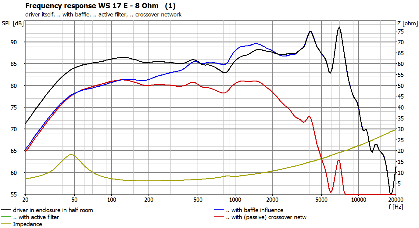

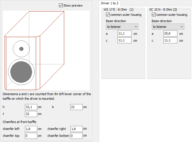

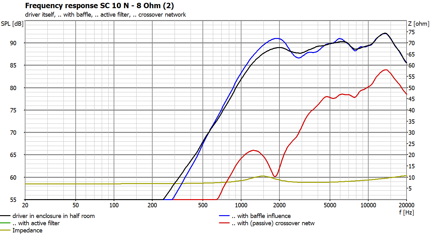

Initially, I tried to export the data from WS17E and SC10N using Visaton Boxsim and then re-import them into VituixCAD. However, the results were inconsistent. I didn't take the time to verify the raw data thoroughly. Testing the majority of export options that Boxsim offers and checking the coherence of the curves and their responses to the network between the two software took a lot of time. Therefore, I decided to stick with Boxsim and trust it directly rather than relying on approximate exports and data.

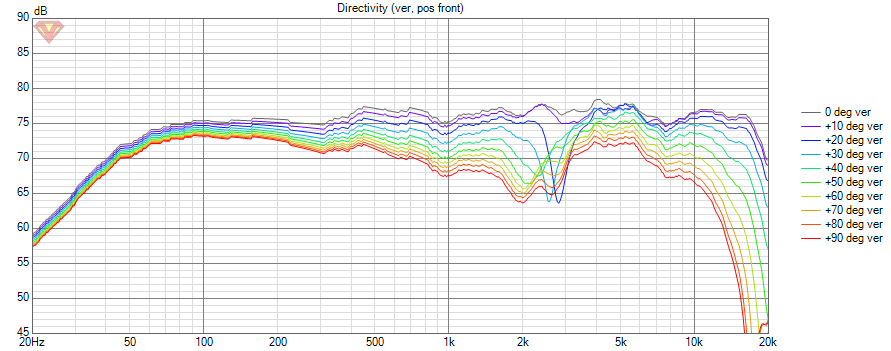

As most of you pointed out, the main difference between Boxsim and VCAD is the ability to integrate the speaker enclosure into the simulation and obtain the baffle step, phase, and polar plots. Regarding the polar plot, the dispersion is relatively uniform except in the vertical axis between 2600 and 3600 Hz, where a phase cancellation occurs at +15° and -15°.
Boxsim common outerhousing
Single driver Frequency response WS 17 E with baffle step
Vertical polar plot at ~2850 Hz

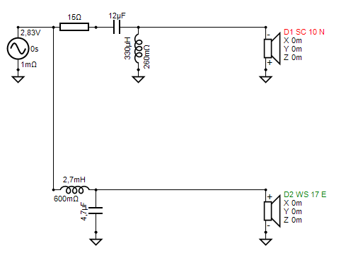

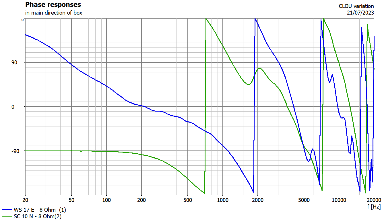

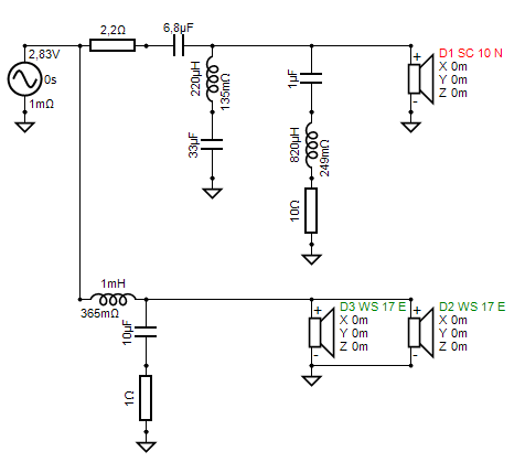

As before, I started by recreating the network presented for CLOU, and this time the resulting crossover makes more sense. I removed one of the woofers, adjusted the box dimensions to keep only the sealed enclosure (as shown above), and tweaked the network until I obtained a satisfactory result.
I retained the original architecture of the network. The adjustments mainly involved a stronger tweeter attenuation and a higher crossover frequency than originally. Additionally, I added a capacitor in parallel to smooth the tweeter response and flatten the +4dB bump at 13500 Hz.

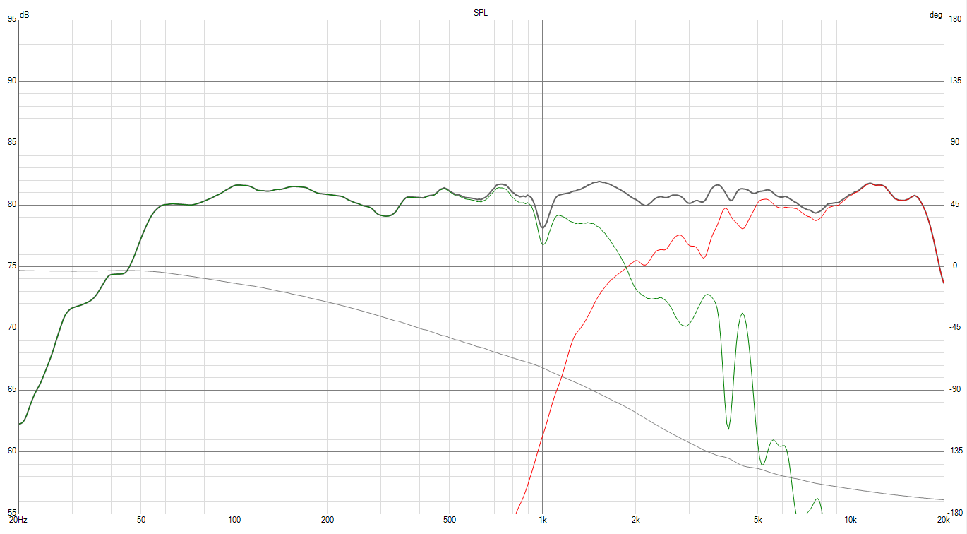

The Total SPL graph shows a ±4dB curve between 46 Hz and 15100 Hz. (77.4dB ~ 81.4dB)
[Image: Network, Total SPL, and phase projection]
Project crossover network in Boxsim
Project Total SPL, individual SPL and Load impedance
Before and after adding 4,7mfd parralel capacitor in the tweeter network
Project phase responses
The Boxsim Speaker Enclosure

Hmm, already down to +/- 2 dB, so on average below our threshold, though if wanting a dip seems better to be at ~ 4 kHz where our hearing is most keen, hence can make music sound harsh.
Yes, consider GM's observation about the 4KHz peak.
I am not sure why the tweeter response takes the dip at 2Khz, but imagine its related to the parallel branches in the tweeter circuit. Save this configuration as a reference, if you haven't already done so.
What happens if you ditch the 33uF the 1.0, 0.82 and 10 parallel notch and change the 4.7 to 2.2uF with 2 ohms or thereabouts.
Maybe the phase has come more closely aligned, At the same time look at the bass Land C values by changing the Bass inductor plus/minus one E12 value and then re adjusting the Bass C value, trying to balance the overall response shape, a better phase match, and lessening the 4KHz bump at the same time.
If this doesn't play out well try adding another 6.8uF to the tweeter circuit on the tweeter side of the 0.22mH and re do the above optimisation. Dont forget to flip the tweeter phase from time to time to see you have a reasonably symmetrical notch.
Even after doing another iteration and maybe gaining some more ground, you will still change a few components when you start the final voicing and listening in your room.
Alternatively as its Saturday, chill and relax.

To answer GM, raymondj and markbakk :
The 33mfd in series of the 0.22mF causes the dip at 2000 Hz and greatly reduces an irregularity. The LCR parallel notch corrects the response at 5000 to 6000 Hz. Both of those applications in the network and the component’s values are from the original design.
I will definitely tinkle around with your suggestions in mind when I have more time to spare.
Here, I’m not sure if you’re pointing out the lack of screenshots for the off axis response graphs or not.
What is, in my opinion, significant enough to be mentioned in my previous post is the cancelation at ± 15° in the vertical axis between 2600 and 3600 Hz.
What is certain is that I will provide the complete off-axis graph rather than a single polar plot screen shot from now on.
How did you get the data for those transducers ? I went back and forth with FDGraphTracer multiple times myself, and after my original post, raymondj and markbakk agreed that I should use Boxsim to be sure that the data I use is correct.
I think I understand it is your crossover version for this project. Is it possible to have a brief explanation of what your doing in this network ?
- DIY Small CLOU design variation
