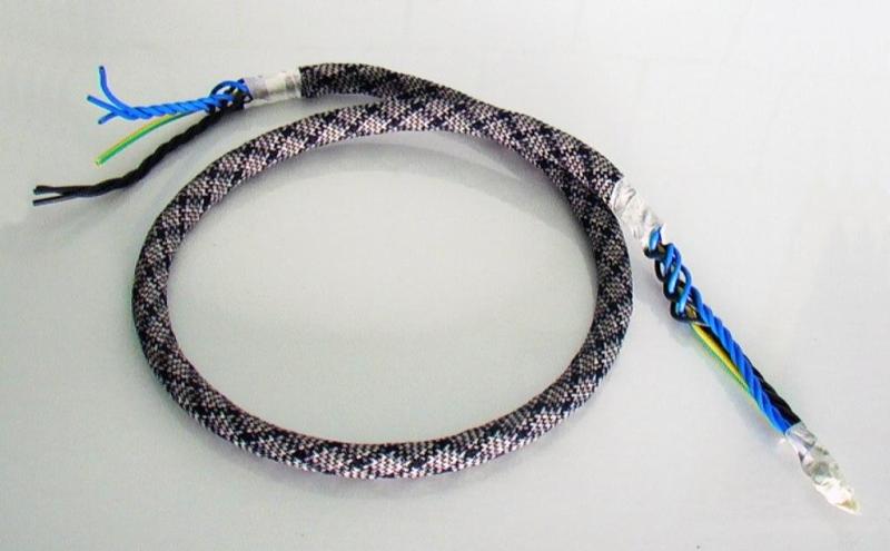

white conductor is not a part of helix geometry
"Some embodiments of the present invention
also comprise drain wires which are not interlacing elements
and which run longitudinally within or adjacent to the helices.
Shielding may also be employed to help reduce noise from external sources."
it is commonly used for grounding, and should be larger in diameter
(easier to braid)

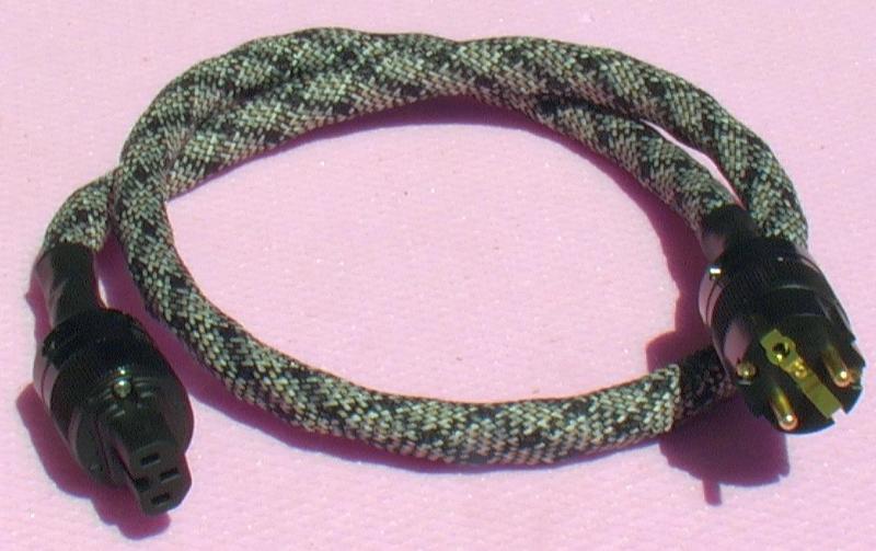

there is 6+6 awg13 conductors
and it is only for heavy loads (amplifiers, welding machines etc 😀 )
I hope this helps 🙂

2x3 conductors in helix geometry, each 2,5mm²
sum 2x7,5mm² (somewhere between 8 and 9 AWG)
central ground wire 6mm²,
crimped with copper end sleeves,
wattgate connectors
now connected on my old pc monitor for pre burn in
wattgate connectors
