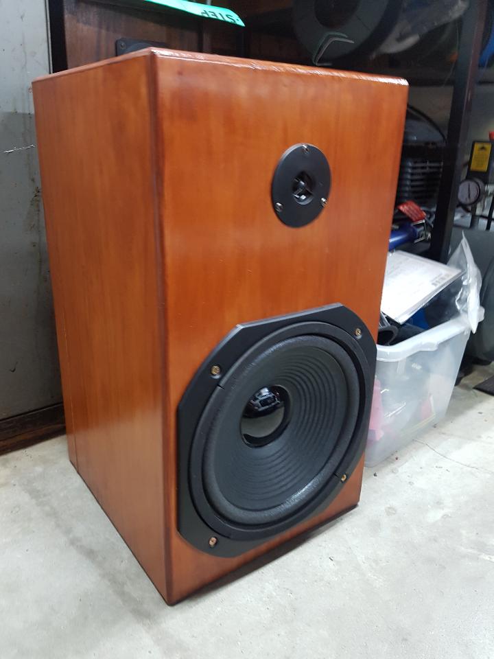

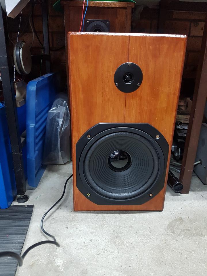

Hi all. I have built a pair of 2 way sealed box speakers which comprise of a 10" woofer and a 1" dome tweeter. Xover is a linkwitz riley and xover point is at 4000Hz. The box is somewhat undersized and I have used some polyfill to improve
The woofer's performance. Qtc is at about 1.2. Despite the high Qtc the bass is not that boomy and works OK. Box resonance is about 71Hz and f3 is about 63Hz. When I turn up the volume the mids from the woofer tend to swamp out the bass.
My question is can I use some sort of equalization
To dip the mids to melow out the sound. I have read that a BSC may be used and if so can it be applied after the xover. Othereise please advise what else I can do to improve this scenario.
Kind regards
Billy D...

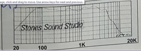

Judging from the response graph in the thumbnail, I would likely have tried to cross that speaker over at about 2khz. If you notice it begins to roll off at about 2k then there's a bump in the response... that is likely to be cone breakup which isn't going to sound pretty, so you want to attenuate it as much as you can.
There are a few soft dome tweeters around that will cross that low. If you are worried about overstressing them you can either use 2 4 ohm in series or 2 16 ohm in parallel.
You may also want to consider a second or third order crossover while you're at it.

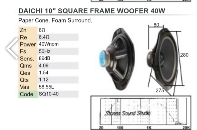

I would like to ask a silly question.
Why on Earth such speakers with a high Qts are made. They are almost impractical to get them optimal in a reasonable size box. They need such a large box. I have another pair 10" woofers which have a Qts of 1.1! What can I do with these?
I can only think to cut a hole in my wardrobe and fit them in there. Otherwise they are virtually unusable. Can I put these high Q drivers into any use?
