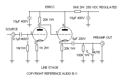

First, you need a ground reference on the tubes' grids. Take a 470K resistor from the grid to the common. Now since you've got the cathode resistors returned to common, it would probably be better to return the grid resistors to some reference voltage, somewhere in the neighborhood of 40-50% of the B+, with the cathode resistors sized to get you your desired plate current.
Second, voltage multipliers are not reputed to have great regulation. And you've got a circuit which, inherently having mediocre PS rejection, needs a stable, quiet DC rail. Splitting and regulating the filament rails isn't important at all in comparison with getting the B+ right- proper raw supply, regulation, filtering.
But my comments about the power supply are hereby doubled.

There are many examples on the web...even low voltage ones when it comes to a 6DJ8.
Because this is DIY, not CIY ( copy it yourself)...😉
Either way, if it's a buffer that's needed then, sure there are plenty to be found even here on the forum.
If some gain is still needed, I think I posted a schematic of mine using a plate follower direct coupled to a cathode follower only a week or so ago...
Ah...Found it on my own HD:
Cheers, 😉
P.S. Mr. Triatic, if the pic of the innards of the preamp is showing shiny plates for the Chinese ECC88/6DJ8s then they are really Chinese 6N1Ps NOT true ECC88s. This implies that the Zout of that stage is even higher than for a European ECC88 or Russian 6922.

@SY-> i know that the PSU isn´t good, but i couldnt finda any suitable HT-transformer, so i thought i should try to double it six times, which gives me about 150Volt and i have a drop about 25-30 V in the PSU-filter, (since the ECC88 are spec. to 130V ?) and use the filter to reduce hum, although i can´t hear any hum in my speakers so obviously it works 😎

@fdegrove-> yes, i guess it amplifies about 6dB or so.. i would gladly lower the amplification a bit.

-do you think i should pick the output signal on the cathode side instead? (like ordinary buffers..?)

PS @fdegrove, your muting seems a little bit rough for the tube?
That's the plate voltage for a cascode service as per the Sylvania 6DJ8 datasheet.
The original Philips ECC88 can take as much as 250VDC on the plate.
In general you often see a B+ of around 250VDC for an audiocircuit using the ECC88 which is fine as heater to cathode insulation is rated at 150VDC with cathode positive and 100VDC with respect to a negative cathode.
If you do you won't have any useful gain and you'd need to reconfigure the circuit as a cathode follower.
The circuit I posted has gain from the first triode section and the second section lowers the Zout to be able to drive lowish input impedances and longer (read more capactive) cable lengths.
Not at all, it's 100% fine. All it does is short the output.
