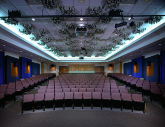

I have a friend who designed this room. He's a big fan and user ot the RPG product line:

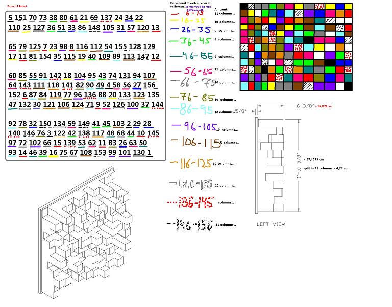

The first statement that the highest point is 15.5 cm according to the patent is probably a misconception. But of course you will only be 0,6 cm off the original if you just add the unit [mm] to the "Table 5" in the US patent. In reality the highest column is 16.1925 cm, according to RPG´s own PDF. If you just add [mm] to Table 5 you will be off maxmimum 6,1925 mm. That is about how wide your saw is, i.e. it is neglectable.
In my own enterpretetation of these numbers I have chosen 15 different lengths which is more than accurate. See my picture!
