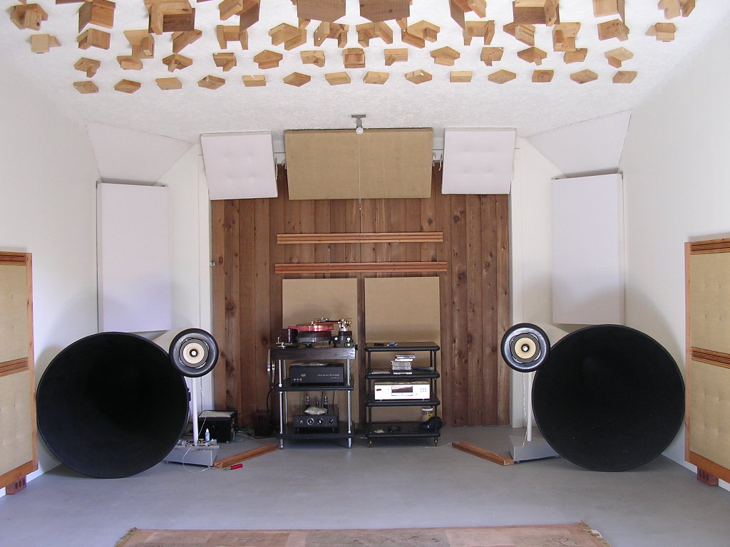

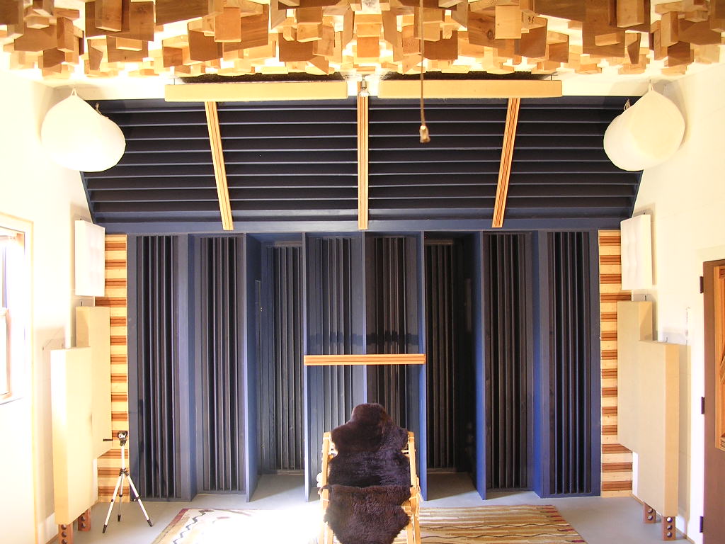

You may want to read The Master Handbook of Acoustics by F. Alton Everest.
The above article is good, but I make a few things differently. I don’t drill 50 holes in the frame of one panel; I make 8 long holes (2 per each side of the frame) – bigger open surface, less drilling, less work. I don’t use plywood – it is easer to staple fabric to wood. I don’t use grille fabric – it’s too expensive and also, not necessary. It’s good on a speaker, where absolute sound transparency is needed. Absorbing panel is a different story, the fabric can be absorbing just should not be reflective at designed frequency range of the panel. Many grill and other fabrics do not block nasty fiberglass dust. I use cotton or poly padding (thin, soft felt) for the first layer to cover the whole thing which also takes care of rough frame edges. For 2nd layer on visible surfaces I use fabric chosen for desired frequency range; burlap for broad band. For bass you can use canvas and paint pictures on it, just leave space between canvas and fiberglass and canvas will work as a membrane. In your country rigid fiberglass may be available under different name and different density than in the article.
You do not need measuring equipment but you need a test tone CD.
Good lack,
Marek
Good lack,
Marek

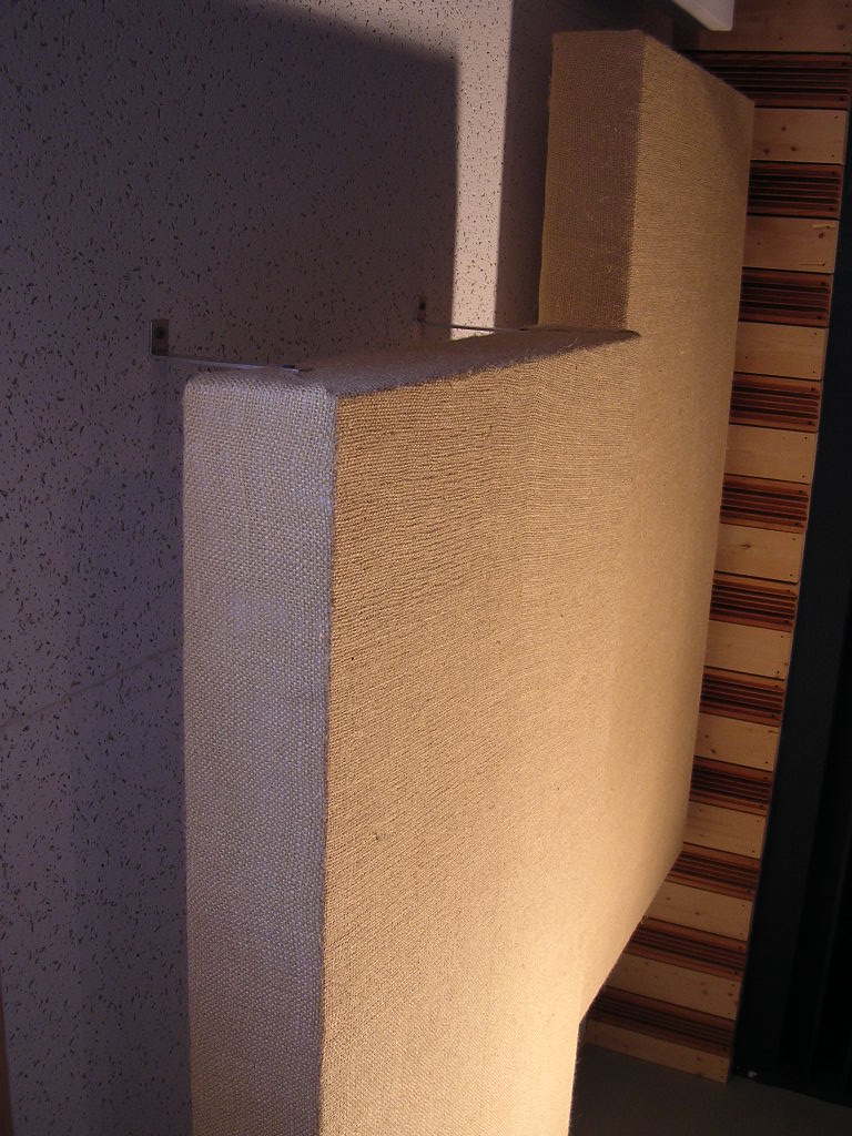

What an amazing room! If only I had a dedicated space. I am listening in our 'front room' which in a small cottage is also the lounge and TV room.
I really like the idea of making my own as I can cover with material to suit the decor. I have found some panels (ready made) that are about right and not too expensive but I do need to build a reflector of some sort for the rear wall. I am thinking about a frame with balsa wood blocks of differing sizes and copy a few of the designs I see around.
Thanks for posting I will source the book ref too. One other thing, I hear a lot about burlap but am not sure what this is. I guess it is called something else in the UK. Can you help by describing it for me?
I would love to ask you a few questions as and when they arise as it seems you are at the other end of my exploration path and you can help me to not take too many wrong turns!

Burlap, according to Webster’s dictionary: a plain woven, coarse fabric of jute, hemp, or the like; gunny. That’s the material on the panel in the first picture.
Feel free to ask any question - I am not a pro, I don’t have secrets or hidden agenda.
