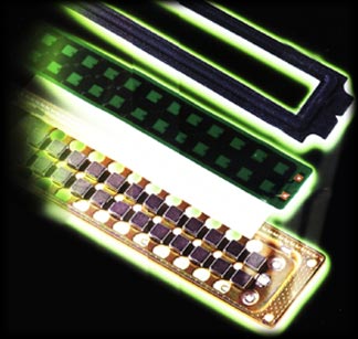

Just FYI, I used to work for the Monsoon engineer (at a latter company) and I now do contract work for FPS, and have samples of each. They are not the same driver panels. Although neither is high efficiency nor have extended HF response, they are more usable for mid-range use than most small magnetic-planar drivers (can be used below 500Hz.).
The Monsoon panels (from Canada) use 3+3 ceramic magnets in a push-pull (front-back) configuration and use a stretched diaphragm (with the typical straight circuit traces).
The FPS panels (from Japan) you refer to use 12+ small neo. magnets on the back only and use a suspended diaphragm (with 12 small flat-round circuit “coils”). See the graphic at the Left for a close up on the small FPS panels.
The 2 large FPS panels use hundreds of small neo. magnets in a push-pull (front-back) configuration and have a Fs of 90Hz.
Correction: the FPS panels (from Japan) you refer to use 24+ small neo. magnets on the back only, and use a suspended diaphragm (with 2x12 small flat-round circuit “coils”). exploded pic. attached

This little FPS0212 planar driver (pic. at Left) has a diaphragm only an inch wide (5 inch long) but has loads of 200hz, but will no go much lower (and is low SPL). It also has good HF (just add woofer). It is used in the FPS slim line-array systems (plus woofer).
